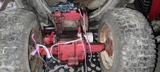

Gilou15 42 #1 Posted September 2, 2024 (edited) Bonjour , J'ai un vieux Rider 10 3V (4 vitesses) J'ai la possibilité d'acheter une transmission automatique d'un C160 Sundstrand -Différentiel plus solide et boîte de vitesses automatique amusante !!! Je ne suis pas sûr qu'il soit possible de boulonner sans beaucoup de travail (transformation du cadre) Je ne sais pas si les deux cadres sont différents. Est-ce que quelqu'un connaît la réponse ??? Merci pour vos réponses Gilou Edited September 2, 2024 by Gilou15 Share this post Link to post Share on other sites
953 nut 61,715 #2 Posted September 2, 2024 6 minutes ago, Gilou15 said: a lot of work Can it be done, yes. will it be worth the effort, not in my opinion. I know that Wheel Horses are not plentiful in France but you would be much better off buying one with an automatic transmission or putting you engine in the C-160. To replace a manual transmission with an automatic you will also need to have the shifting mechanism from the C-160 and the brake rods. If you are looking at purchasing a C-160 parts tractor that hasn't been stripped of other parts you may be able to pull this off, but measure carefully before you buy. The pulley on the engine for a Hydro (automatic) is larger than what your Raider has and the hydro itself consumes a couple of horsepower so the 10 HP running a hydro may be disappointing. Share this post Link to post Share on other sites

Gilou15 42 #4 Posted September 3, 2024 Thanks Tony ! In fact , I would buy a complete rear transmission of a C160 with commands, shifting and the hydraulic lift for 50€ ! However ,I can fit an Onan 16 hp or a K320 ..I only would know if the frames are same My dream would be to find a GT14 !! I have a C101 8 Speed in perfect condition 2 Share this post Link to post Share on other sites
Handy Don 14,493 #5 Posted September 3, 2024 As @953 nut pointed out, the job is more than the transaxle. Brake and clutch pedals and linkages are affected as is the mounting of the fenders and seat. Adding or removing hydraulic lift affects its controls, plumbing, and even the center rock shaft (which can be an absolute bear to remove). 1 Share this post Link to post Share on other sites
