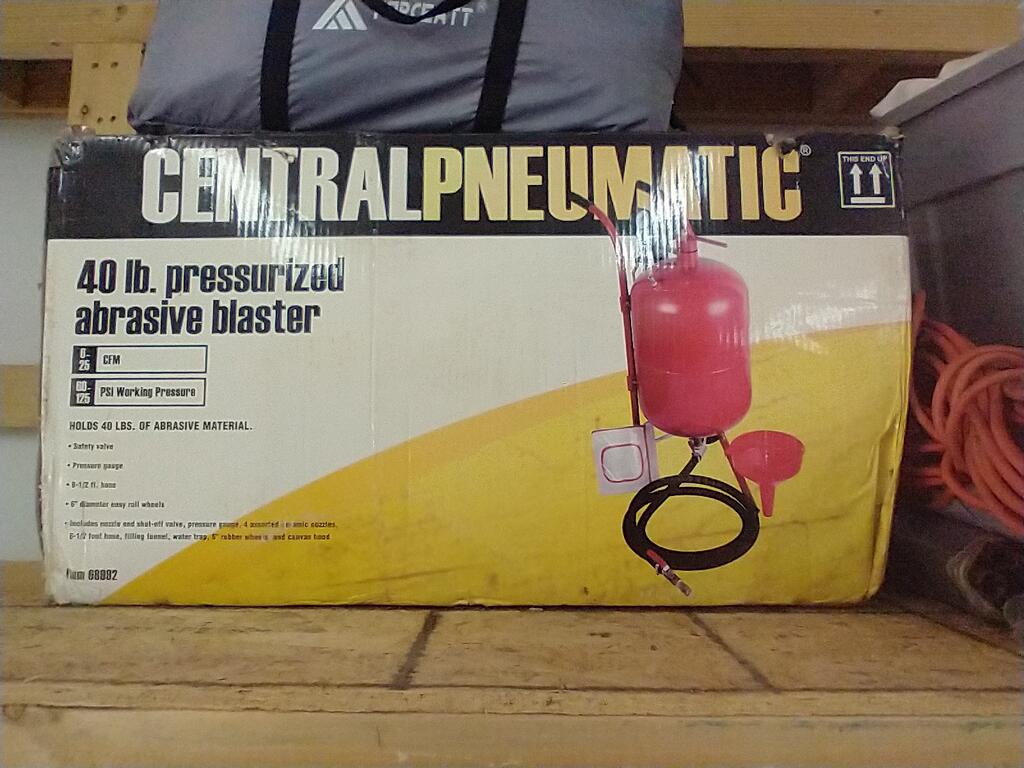

rmaynard 17,495 #1 Posted September 2, 2024 Years ago I bought a Harbor Freight 40lb tank-type sand blaster on sale cheap. It's been on the shelf ever since. Never used it. So my question is, has anyone successfully used one of these? I'm picking up another tub cart tomorrow and thought I'd try sand blasting with the tank since the cart won't fit in my cabinet blaster. Share this post Link to post Share on other sites
