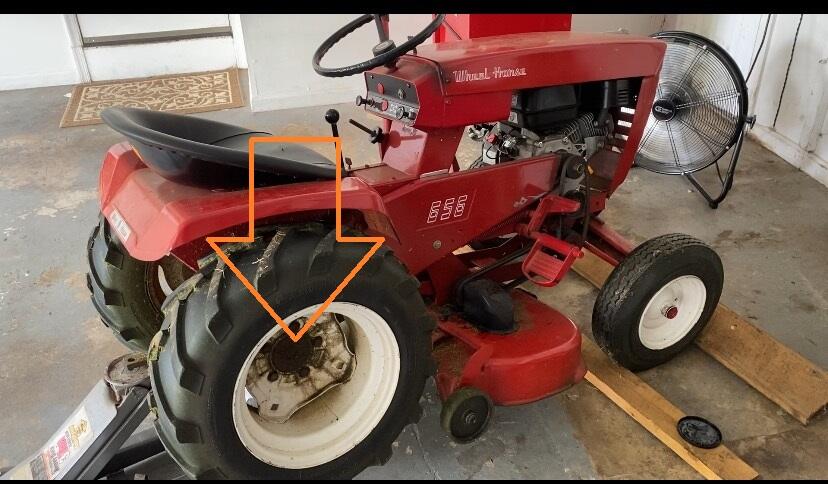

WH656 9 #1 Posted September 1, 2024 (edited) I searched the forums for this.. I think it is probably a seal but can anyone tell me what part number to reseal? This is a 1966 656 , Its also leaking on the other side of the wheel... thanks. Edited September 1, 2024 by WH656 Share this post Link to post Share on other sites
stevasaurus 23,619 #2 Posted September 1, 2024 Your horse should have 1" axles in a #5053 Wheel Horse transmission. The axle seals are WH #100863 they cross to SKF 9815...available at Auto Zone, NAPA and some of our vendors. Share this post Link to post Share on other sites
953 nut 64,259 #3 Posted September 1, 2024 (edited) The axle seals for a 1" axle are SKF-9815. Jack up the rear end and try to move the axle up-down and forward-backward. If the bearings are good there will be no movement. If they move then seals won't fix it. @stevasaurus types faster than me. Edited September 1, 2024 by 953 nut 1 Share this post Link to post Share on other sites
ri702bill 11,340 #4 Posted September 1, 2024 The GOOD news is that the leak has juiced up the axle to hub joint to make hub removal easier.... Share this post Link to post Share on other sites
