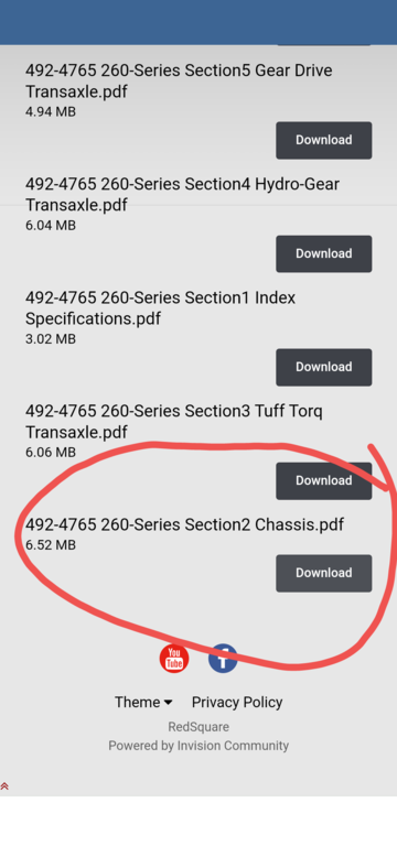

rmaynard 17,659 #4 Posted September 1, 2024 I have no experience with your model, but download the section of the manual shown below. It has the procedure for adjusting steering backlash. 1 Share this post Link to post Share on other sites

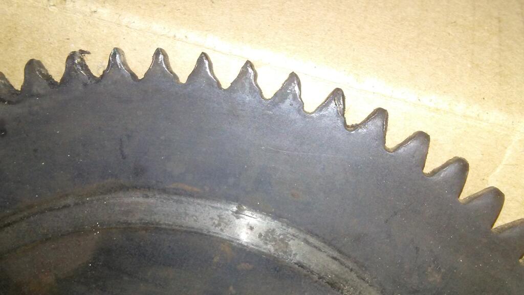

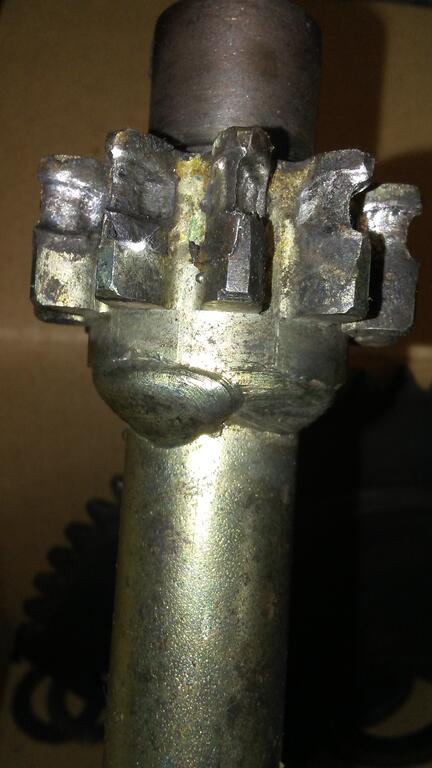

ROK2024 6 #6 Posted September 2, 2024 I have a 267H, in 2020 I replaced the Lower shaft bushing and pinon gear/steering shaft. The half moon sector gear and upper bushing were pretty good and kept them. Because it has Tilt steering I was able to shortcut to the Service manual instructions and able to R&R the parts after I loosened and lifted the dash without removing it. Mostly out of necessity as I couldn't get the steering wheel off. With some gentle persuasion I separated the shaft from the Tilt U-Joint. I'm looking at some pics and notes and using a few foggy memories to help decipher what I have.. wish I could be more precise. For steering slop check the front axle tie rod bushings too. That's on the to do list. Parts Manual FORM NO. 3318–934 REV. A for Model 72085 SN pg 7900001 & Up (1995) Parts item PN# ⦁ 10 92–6702 1 Shaft–Steering Lower ⦁ 106-8262 SECTOR-GEAR (Replaces 78-2610) 20200219 Order $134.97 item 171552641900) PN 92-6702KIT Toro Steering Kit 106-8262 Sector Gear, 110391 Lower Shaft Bushing, 109189 Upper bearing Lower shaft , 111418 Eccentric Share this post Link to post Share on other sites
ROK2024 6 #7 Posted September 2, 2024 Oh good, I did replace that Sector gear too. Share this post Link to post Share on other sites
