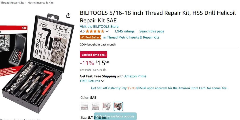

onanparts.com 185 #16 Posted September 1, 2024 1 hour ago, horseman with no horse said: https://skygeek.com/heli-coil-5401-5-thread-repair-kit.html is this the correct kit? Normally I would say buy the name brand....but...this one is under $16.00 and no 45+ days lead!!!! search Amazon for this: BILITOOLS 5/16-18 inch Thread Repair Kit, HSS Drill Helicoil Repair Kit SAE Using the Helicoil brand USA made inserts is preferred. Share this post Link to post Share on other sites
