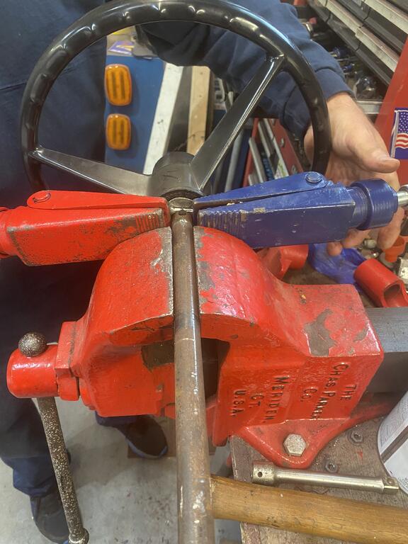

c-series don 12,061 #2 Posted August 30, 2024 Hi Kevin, I believe you have to at least lift the motor a bit to get the lower shaft out. I’d replace the steering block while you’re at it. Brian from K+B Wheel Horse Parts should have it. The hardest part may be removing the steering wheel from the shaft. Recently I had to use two Port a Powers and a two foot long piece of 3/4” round stock that I hit with a sledgehammer. 2 1 Share this post Link to post Share on other sites
kthomas62 46 #3 Posted August 30, 2024 (edited) 4 minutes ago, c-series don said: Hi Kevin, I believe you have to at least lift the motor a bit to get the lower shaft out. I’d replace the steering block while you’re at it. Brian from K+B Wheel Horse Parts should have it. The hardest part may be removing the steering wheel from the shaft. Recently I had to use two Port a Powers and a two foot long piece of 3/4” round stock that I hit with a sledgehammer. Hey Don! Thanks! I was wondering if I could get by with raising the engine some. Thanks for the lead on the steering block!! And that's no joke in getting that roll pin out! I have been working on that but I thought since the old upper shaft is shot, I may use my die grinder and cut the shaft below the steering wheel and put it in my vice like you show. Kevin Edited August 30, 2024 by kthomas62 1 Share this post Link to post Share on other sites
c-series don 12,061 #4 Posted August 30, 2024 @kthomas62 If your steering wheel has a removable center cap the shaft can be pressed out. My wheel didn’t have a removable cap. Yes getting the roll pin out can be a real challenge too! A proper roll pin punch is a necessity. I think someone here said they had good luck using masonry bits to drill it out. One thing I know for sure is that this is the best place for anything Wheel Horse, with the nicest people on the internet. 1 Share this post Link to post Share on other sites
