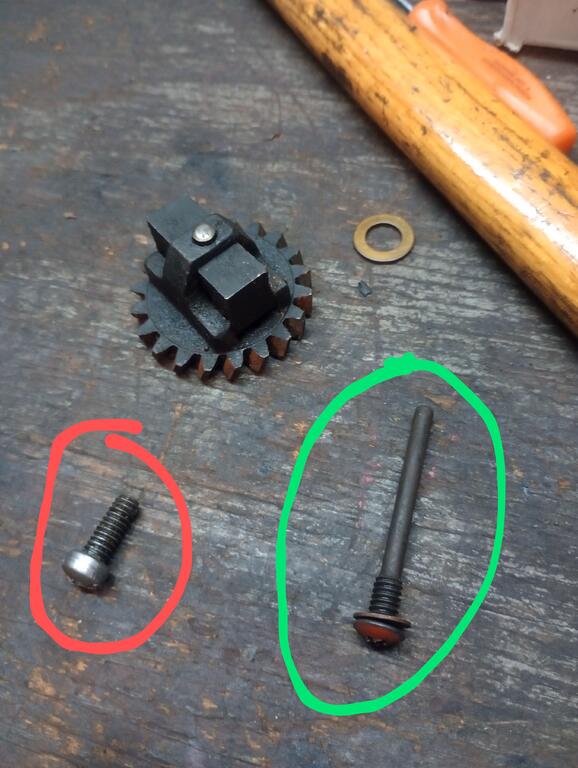

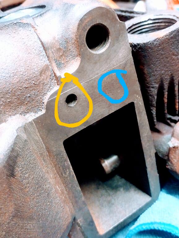

Chrishar 1,054 #1 Posted August 27, 2024 Have a Kohler k161s spec.28522e ser. 497709 it goes on wheel horse 701 trying to figure out what retaining screw goes in the yellow circle all the motors I work on the screw goes where the blue circle is I pulled this screw out that's in the red circle will the screw in the green circle work if not what kind on screw goes in the yellow circle to hold the governor gear help please Share this post Link to post Share on other sites

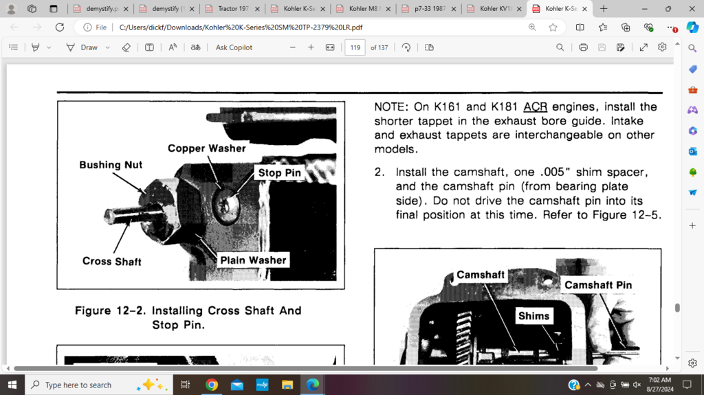

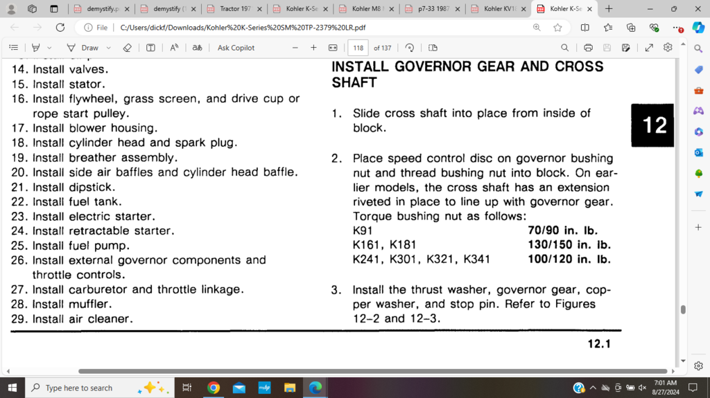

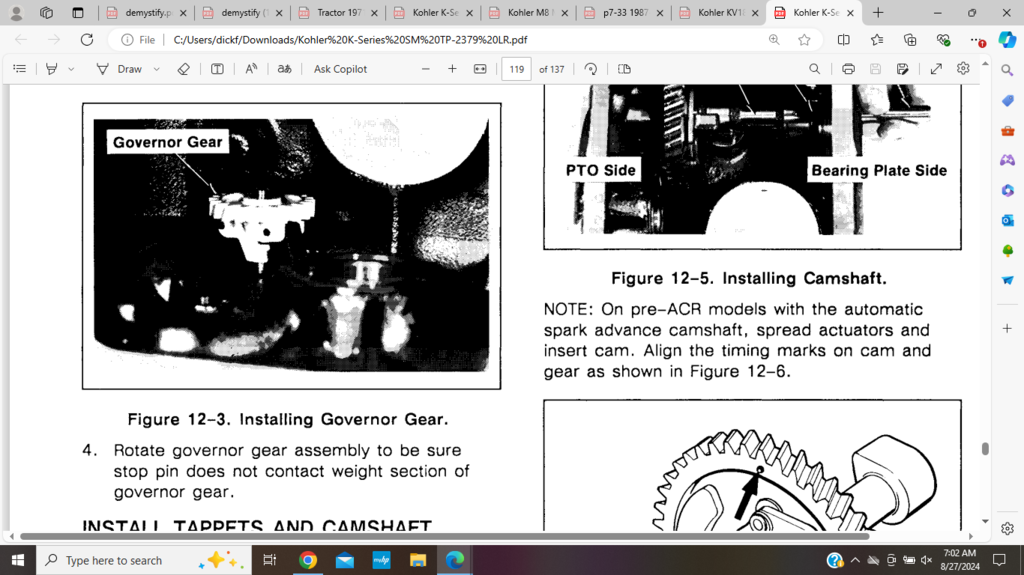

953 nut 69,726 #2 Posted August 27, 2024 The screw in the Green circle is the Stop-Pin for the governor. Section 12 of the Kohler Service Manual gives step by step instructions on this process. Share this post Link to post Share on other sites
Chrishar 1,054 #3 Posted August 28, 2024 So the screw in the red circle goes were the yellow circle is on the motor because the longer screw will not work it will hit the governor gear in the middle Share this post Link to post Share on other sites
