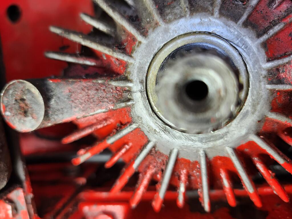

Tracy Gruetzmacher 3 #34 Posted September 17, 2024 Ya know just thinking back to when I purchased it, the first time I looked at it after a short ride leak was worse than it is now. The owner who was a retired WH dealer said he would fix it and call me. So went back owner claims fixed and that he rode it for 1/2 hrs with no leak. I rode it again for 5 minutes no leaks so I bought it. Got home grandson rode it for 20 minutes and the leak came back. Now when I took the pulley off splines there was what looked like grey anti seize smeared on the shaft, the splines, the face of the seal and on pump housing. Now I am thinking the previous owner doctored it up somehow to stop the leak long enough for me to believe the leak was fixed. Could there be a crack in the housing? Share this post Link to post Share on other sites

Tracy Gruetzmacher 3 #38 Posted September 18, 2024 Well I cleaned it up good, ran it, pulled pulley off quick and guess what? The housing is cracked at the 9 o'clock position and starting to Crack at the 3 o'clock position. So now I am looking for a pump for a C145 or thinking about parting it out. Share this post Link to post Share on other sites
pfrederi 20,657 #39 Posted September 18, 2024 The housing around the seal is pretty chewed up. Wonder if the seal casing itself was scored/damaged as you pressed it in. Might try a new seal but put some extra sealant on the outside of the seal body. I hate to recommend RTV in hydros but if you only use a little bit...Few buck for a new seal might be worth the attempt... Share this post Link to post Share on other sites
Tracy Gruetzmacher 3 #40 Posted September 18, 2024 So you don't think that is a hairline crack at the 9 o'clock position? Share this post Link to post Share on other sites
Wild Bill 633 936 #41 Posted September 19, 2024 (edited) 18 hours ago, Tracy Gruetzmacher said: So you don't think that is a hairline crack at the 9 o'clock position? Looks to me those are casting seam flash because they look to perfect to be cracks, exactly 180 degrees and straight. As @pfrederi, mentioned above, I would try another seal with a sealant/adhesive on the OD. Locktite makes a product for this application. I bought a used 4WD vehicle with a leaking front differential pinion seal. After seal removal, there was a tool removal dig mark in the bore from previous removal, the source of the leak not the seal. I used a Loctite product on the the seal OD to seal. I would contact a Loctite tech service for advice. Edited September 19, 2024 by Wild Bill 633 1 Share this post Link to post Share on other sites
