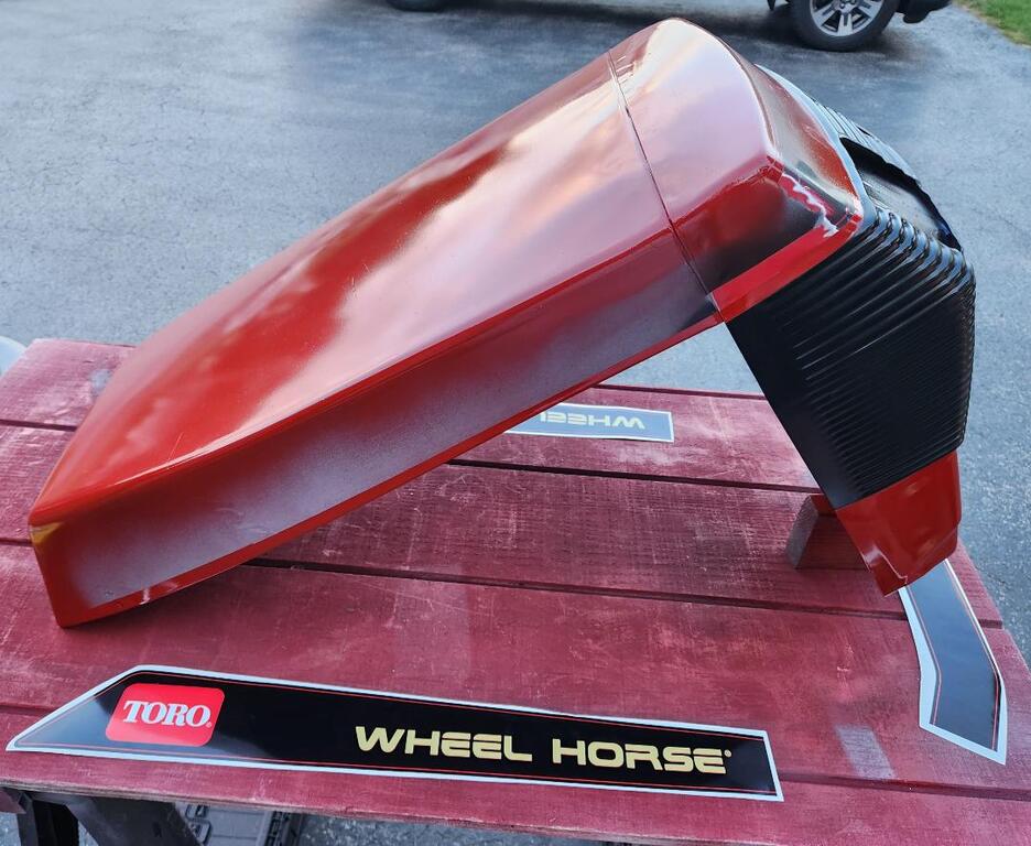

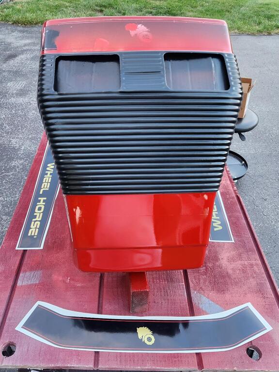

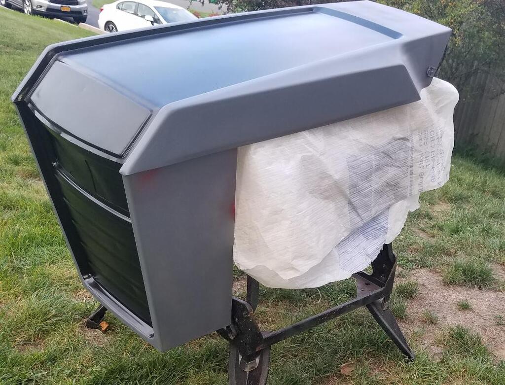

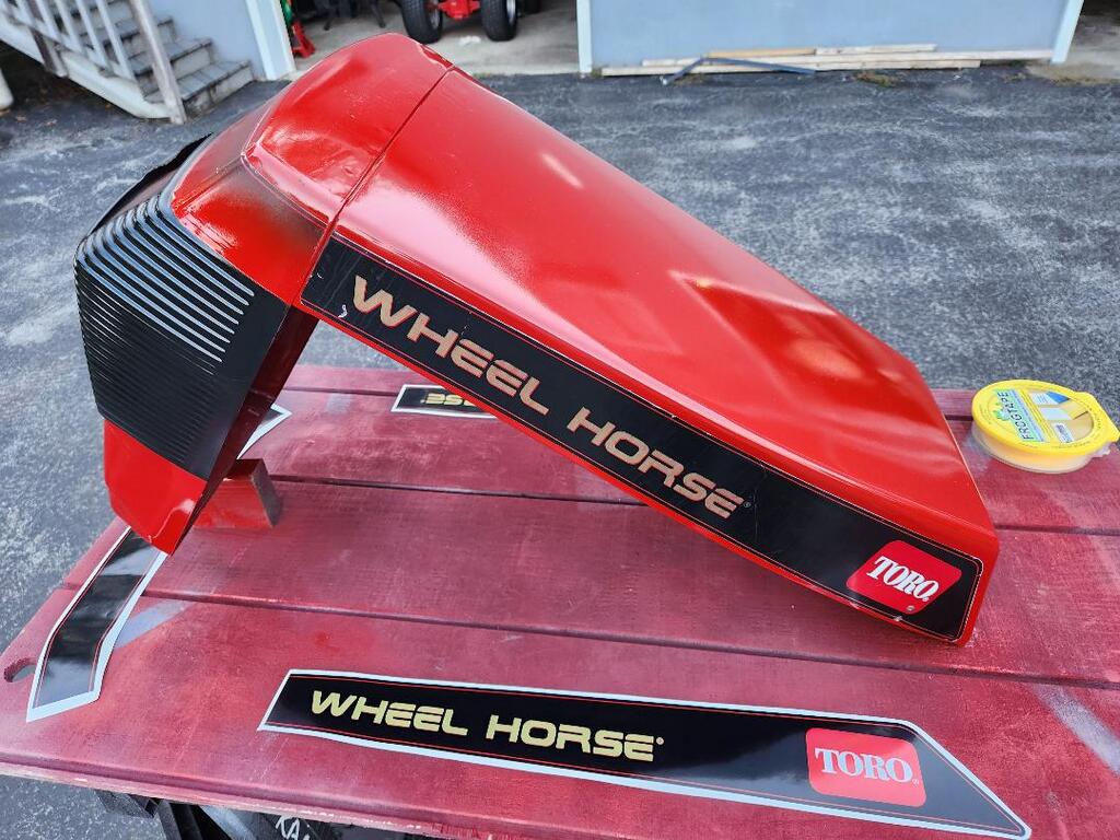

Brockport Bill 2,491 #12 Posted August 24, 2024 so the answer to my thread question of how long to wait to apply painters tape to just painted Tractor tins is 24 hrs - I called PPG help line who were very informative -- then went to local Sherwin Williams paint store and the staff there also very helpful - so i bought a yellow Frog Tape product that's is specialized for applying to "fresh " paint - - its labled "delicate" as you can see at top of label in photo attached - i put it on the black grill section i had painted the day prior having been advised to wait 24 hrs --- however, label said it was for latex paint so to be sure the oil based Rustoleum would not go through the thin "delicate" tape - i put the blue Scotch brand tape on top of the Frog tape -- Feeling secure the delicate Frog tape would peel off without damage to the new spray paint from day prior - coupled with the blue tape on top to stop any bleed through - - i proceeded to spray the adjacent area -- The Frog tape came off easily and the grill black paint from day prior was perfect -- none of the red over spray leaked through ---- -- The hood photos show some sun reflection and nearby shadows but came out pretty good - I will wait a few days for more curing to attach the new decals --- thanks for the advice on the above thread ........... Bill 5 Share this post Link to post Share on other sites

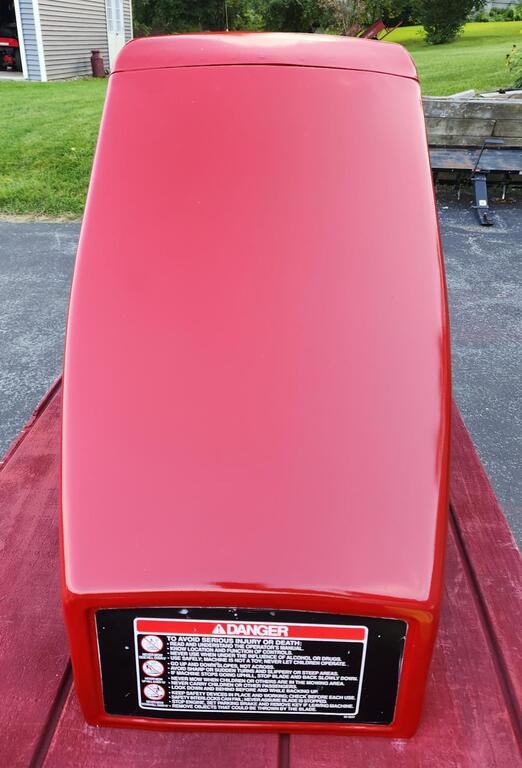

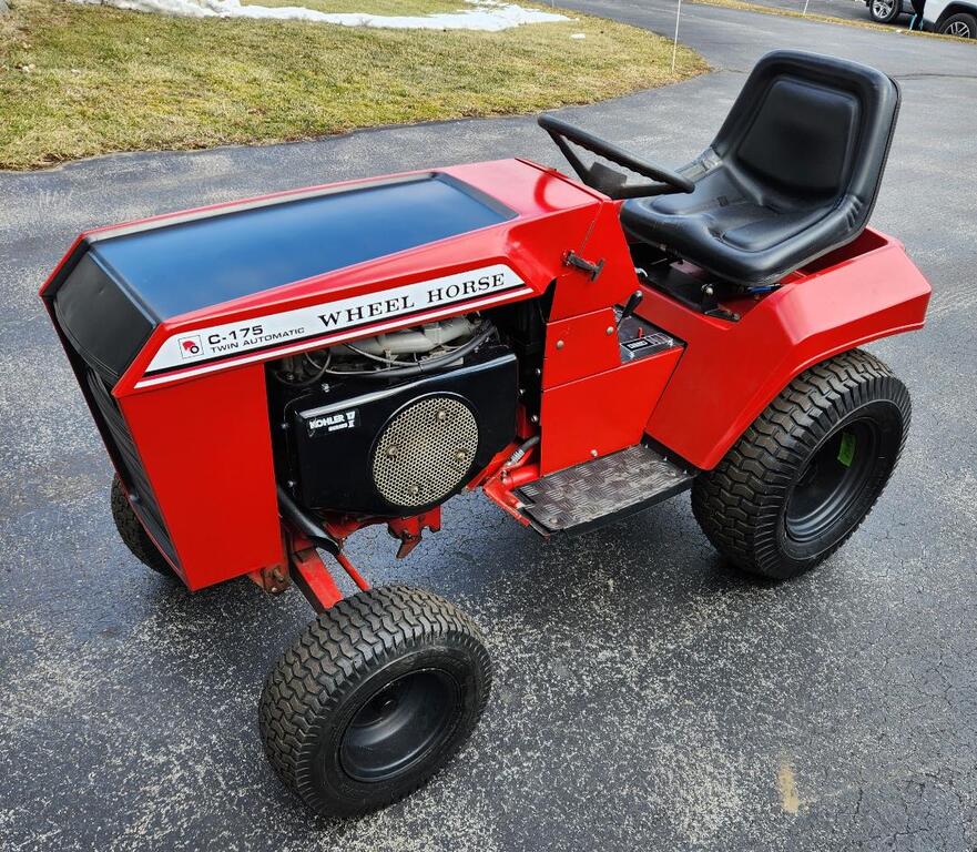

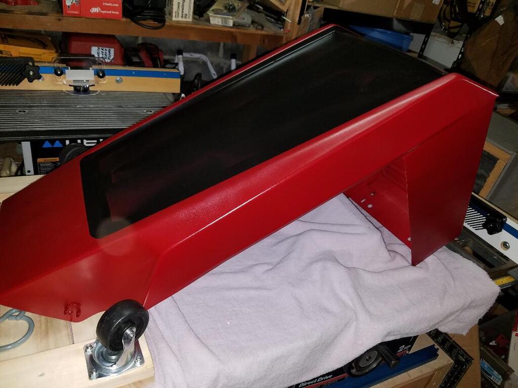

Brockport Bill 2,491 #19 Posted August 24, 2024 Don -- i am not the pro artist you are - but here's the hood for my Series 2 from last year in 2023 -- then the final product C175 Series 2 -- I just keep try learning from RSq members the tips and tricks - i did have this hood professionally sand blasted to get cleaned up before i used rattle cans to paint 5 1 1 Share this post Link to post Share on other sites

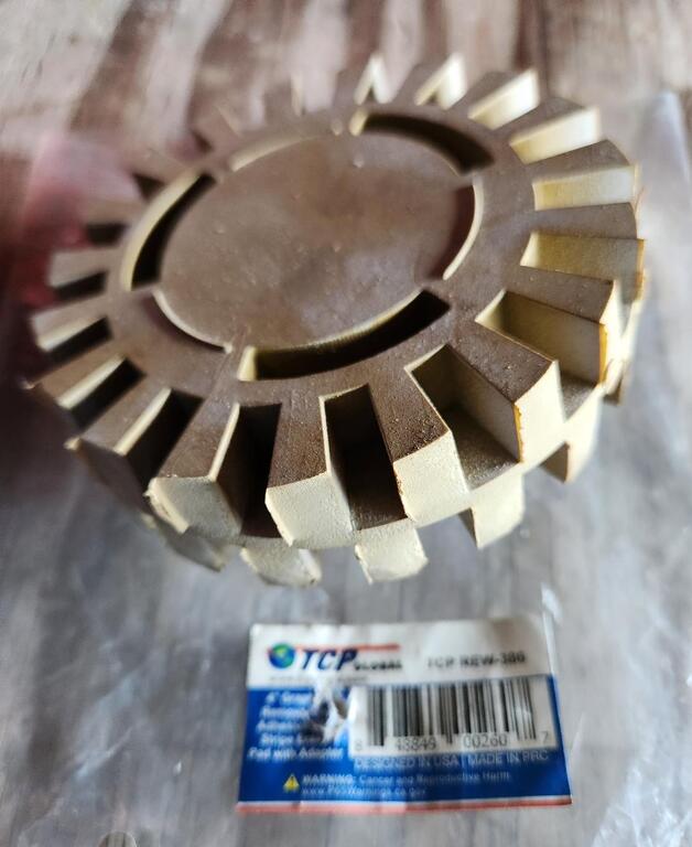

Brockport Bill 2,491 #20 Posted August 24, 2024 3 hours ago, ebinmaine said: I've done the disc removal like you describe. Also used a heat gun. The heat gun is a bit time consuming as well but after using a solvent to remove residual glues it gives a nice clean result. here is a decal disc stripper i bought a few yrs ago and just used for first time - worked well -- it's used in drill motor - it's a soft rubber material - no paint damage 3 1 Share this post Link to post Share on other sites

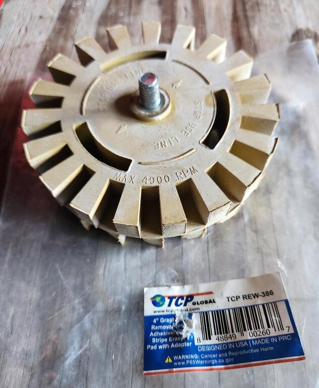

ebinmaine 81,035 #21 Posted August 25, 2024 On 8/24/2024 at 1:28 PM, Brockport Bill said: here is a decal disc stripper i bought a few yrs ago and just used for first time - worked well -- it's used in drill motor - it's a soft rubber material - no paint damage That's a neat piece. Never seen the like. 2 Share this post Link to post Share on other sites
JPWH 6,544 #22 Posted August 25, 2024 I removed all the badge and trim adhesive from my 2000 Silverado with one wheel like shown above. 3 1 Share this post Link to post Share on other sites
953 nut 70,022 #23 Posted August 25, 2024 On 8/24/2024 at 9:33 AM, Brockport Bill said: How do most people remove old decals? Hair dryer and Goo Gone for me. Warm up the entire decal then start pulling while keeping the heat on. The Goo Gone works best if you soak a rag with it and lay it on the old adhesive for a few minutes first. 3 1 Share this post Link to post Share on other sites
SylvanLakeWH 32,760 #24 Posted August 26, 2024 11 hours ago, 953 nut said: Hair dryer and Goo Gone for me. Warm up the entire decal then start pulling while keeping the heat on. The Goo Gone works best if you soak a rag with it and lay it on the old adhesive for a few minutes first. Strongly recommend not using wife's hair dryer though... 1 Share this post Link to post Share on other sites
squonk 48,278 #25 Posted August 26, 2024 (edited) 18 hours ago, ebinmaine said: That's a neat piece. Never seen the like. They call them eraser wheels. Mine looks like this one Edited August 26, 2024 by squonk 1 1 Share this post Link to post Share on other sites
