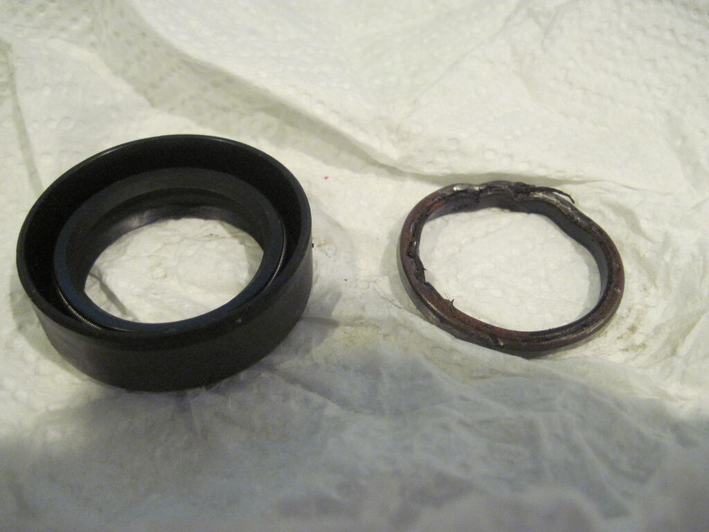

Tonyp 285 #1 Posted August 16, 2024 (edited) I know there are spreadsheets but I'm not certain of my exact C81 , there is no ID on the tractor. I ordered what was supposed to be the proper seals but they are not. What came were the ones on the left , ( 6449) what was on the axle is the one on the right. It is 1-1/8 Can anyone offer assistance ? It looks like a NAPA seal #9815 Is the Wheel Horse 100443 ? Tanks in advance ! Edited August 16, 2024 by Tonyp Share this post Link to post Share on other sites
ebinmaine 80,755 #2 Posted August 16, 2024 What you have looks like an Automatic transmission outer seal. If you have a manual transmission, On the charts you want the third chart and third line up from the bottom. 1 Share this post Link to post Share on other sites
Tonyp 285 #3 Posted August 16, 2024 (edited) THX, its an 8 speed manual, it looks like this is 100443 which is what chart 3 says THX Edited August 16, 2024 by Tonyp 2 Share this post Link to post Share on other sites
squonk 48,133 #4 Posted August 16, 2024 11 minutes ago, Tonyp said: THX, its an 8 speed manual, it looks like this is 100443 which is what chart 3 says THX Napa # 11050 1 1 Share this post Link to post Share on other sites

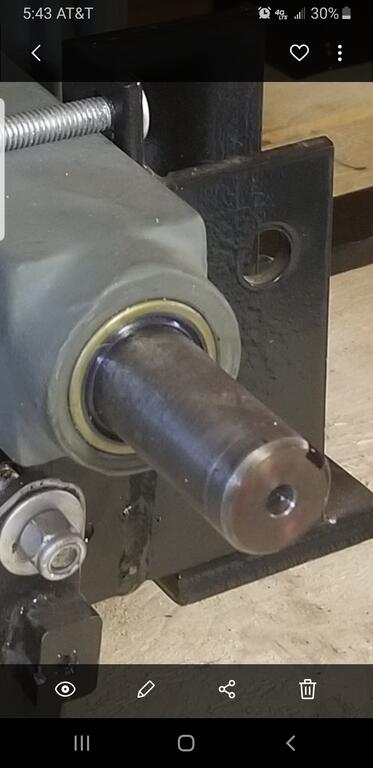

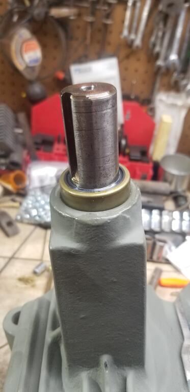

gt14rider 1,278 #5 Posted August 16, 2024 (edited) The 6449 are original seal, they will work. Seams the seals got thinner over the years. Just put 6449 seals on 73 no name 1 1/8 axle. Edited August 16, 2024 by gt14rider Add pic 1 1 Share this post Link to post Share on other sites
Tonyp 285 #6 Posted August 18, 2024 Picked up 2X NAPA #11050 , brought a caliper with me. They are exact to the seal that was removed. $6.80 each. Only one is leaking on the C81, its ready for a new seal. The other side , well, I'll put the seal in the parts box ! Removing the HUB was a breeze as I replaced both sides lockdown screws not all that long ago. THX all for the replies best tp 2 Share this post Link to post Share on other sites
