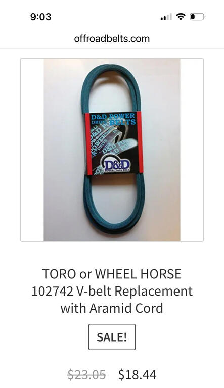

PWL216 1,294 #7 Posted August 16, 2024 (edited) @kthomas62 Deck Belt: 102742 1/2” x 103” Spindle Belt: 6738 1/2” x 86” try www.offroadbelts.com Edited August 16, 2024 by PWL216 Share this post Link to post Share on other sites
kthomas62 46 #8 Posted August 17, 2024 I definitely appreciate all the help guys!! The spindles are all free wheeling so to speak, I belive the belt just got old and broke in the thick grass. I bought this WH 5 or 6 years ago and have never changed the deck belt, and we have had quite a bit of rain lately which have really made the grass is thick and the crab grass is coming on so, I believe it was just more then the old belt could take. It's had several seasons of mowing thick grass this time of year so it was time to replace it. Thanks again!! Kevin Share this post Link to post Share on other sites
