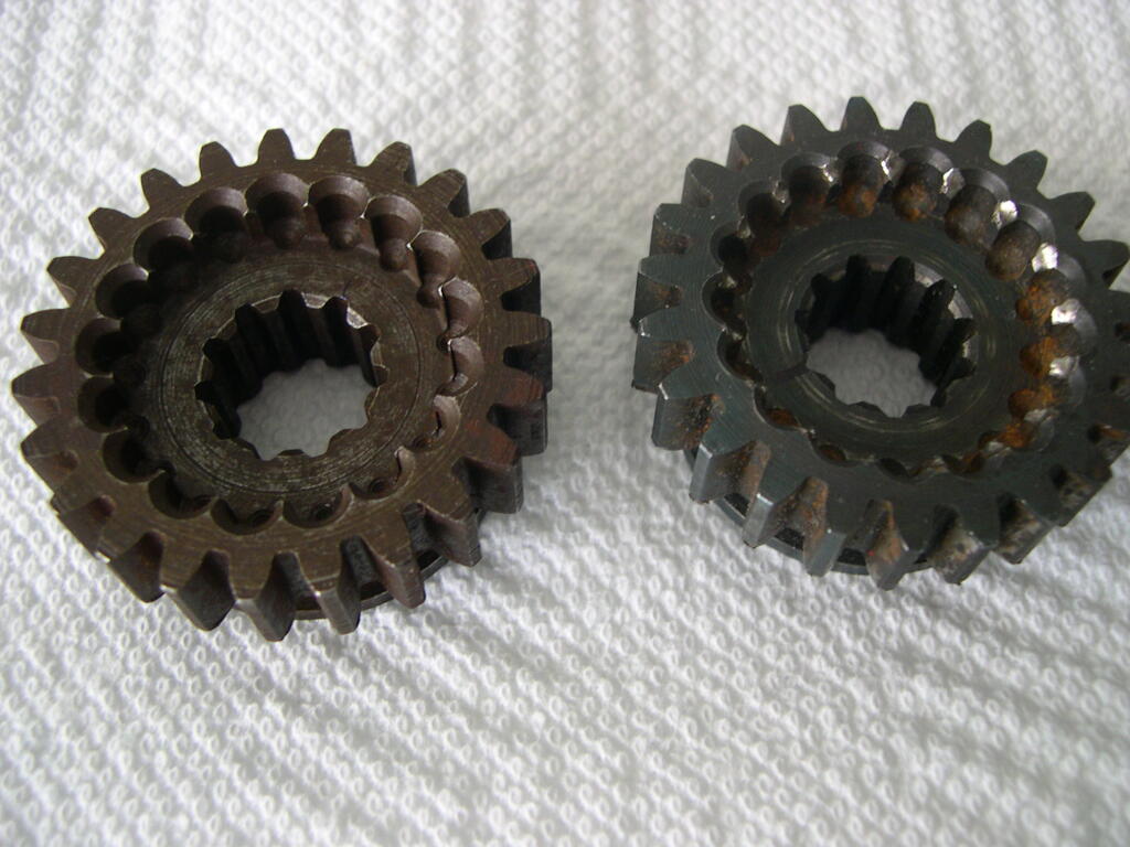

Racinbob 12,552 #4 Posted August 14, 2024 Here's a good and questionable 3523 gear. Those inner teeth are screaming to get ground off. One important thing to check. Put the shifter in 3rd gear and just let the detent balls hold it. Then check the input pulley for any in/out play. It should be zero. Any play at all it how far that gear separates from the 3522 input gear as it's running causing it to be more vulnerable to wear. If there even a little in/out play it can be eliminated with shims on the input shaft before it's inserted into the base. You most likely will still need a new gear/s but this should be done regardless. 4 6 Share this post Link to post Share on other sites
