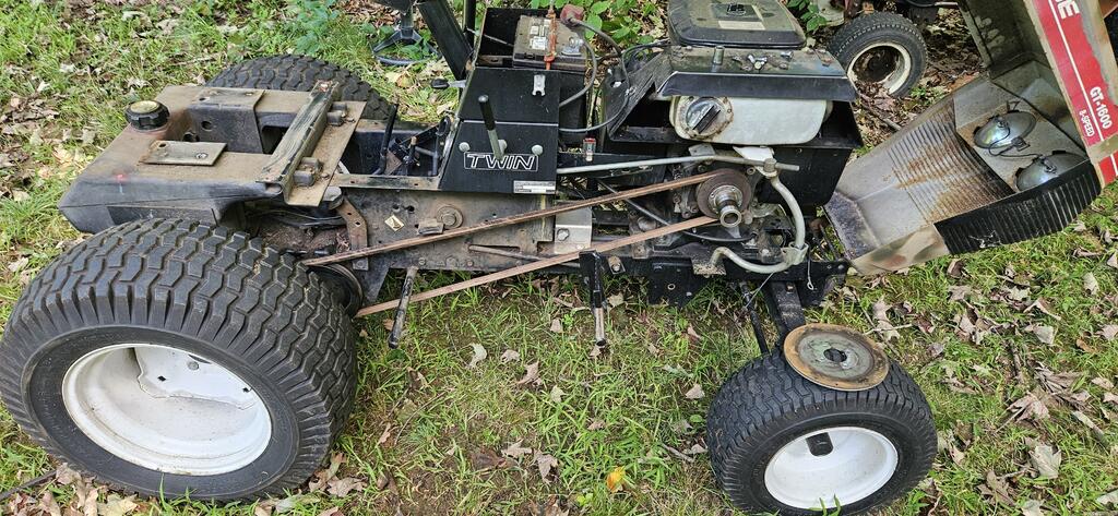

Docwheelhorse 2,991 #1 Posted August 11, 2024 Hello all... Started working on swapping tins on my GT1642. Decided to replace drive belt as one on it is way too grabby. Grabbed a 7473 off shelf and it doesnt fit... Rear pulley is factory 8 speed unit... front is 4" factory 8 speed too. Only difference I found was that the Briggs flat twin centerline is 7" where as the Kohler singles are 6". Do the Wheel Horse 8 speeds with the Briggs twin (GT1600, 1642) run a different belt than the 7473? Thanks Tony Share this post Link to post Share on other sites
