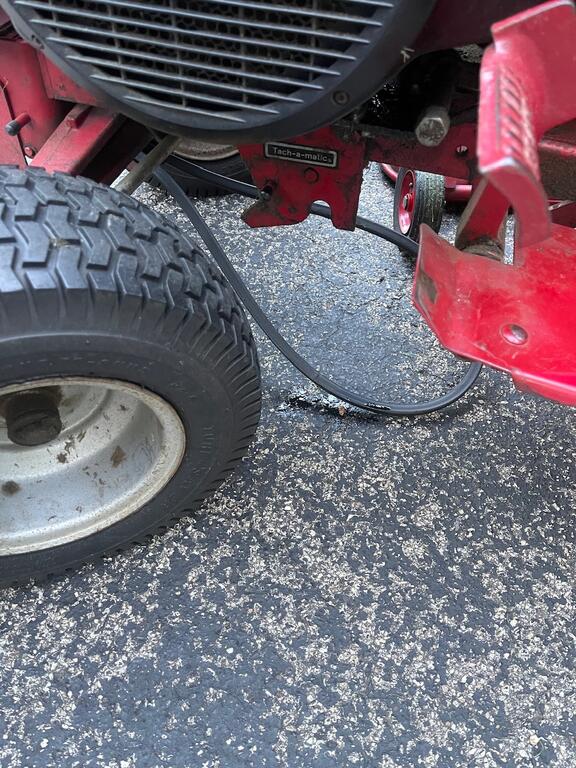

CubanB 4 #1 Posted August 11, 2024 At the start of the mowing season I kept having the belt on the deck pop off.the center blade would still spin from the PTO belt and the outer two would stop. I'd have to take the covers off and just force it back on one of the side pulleys. I figured belt was worn and stretched.got sick of taking covers off so I left them off.since then I've mowed about 20 hours and it hasn't come off again. I noticed at the very end of my last mow, the engine was really blogging down, and I could hear a metallic noise when engaging PTO. As you can see in the video, thr idler pulley is rubbing up on the nut for idler plate. I found a few pictures on here while searching and they all show that same nut a good 2 inches from the idler pulley. I preemptively ordered a new tensioner spring and I have a spare deck belt. Is that all I will need to remedy this? I haven't taken it apart yet but I took the deck off the mower. I can't figure out what the root cause of this would be,and would like to know if anything else should be considered for replacement. I think maybe the idler pulley? Hey guys, I was wondering of anyone has had a similar issue and what they did to fix it. Here is a video with the PTO engaged with engine at idle. https://1drv.ms/v/s!Atlwbji1O0hyhaMPoXvfrbFFHs20wQ Thanks In advance for any thoughts/suggestions. Share this post Link to post Share on other sites

CubanB 4 #5 Posted August 12, 2024 The belt was correct, however several years ago when I bought this mower,the tension spring broke. I took it to a local hardware store and got the closest one they had,and it seemed to work. I think it was a little longer and less forceful. I began disassembly and cleaning. I ordered a new idler pulley, and the plastic spacers. I realized after that it is leaking oil. I will need to correct that, appears to be leaking near the filter. The idler support bar is quite worn. My question now is can I continue to to use this or is that a bad idea? Share this post Link to post Share on other sites
CubanB 4 #6 Posted August 15, 2024 Cleaned everything up and looked for oil leak. Right at the filter. Grabbed it and was able to give it two full spins to tighten it. Now I suppose I will be fixing up this deck. Decided to order the idler bar as deck is in great shape overall. Holding the new and old in hand, the difference is substantial.. Share this post Link to post Share on other sites

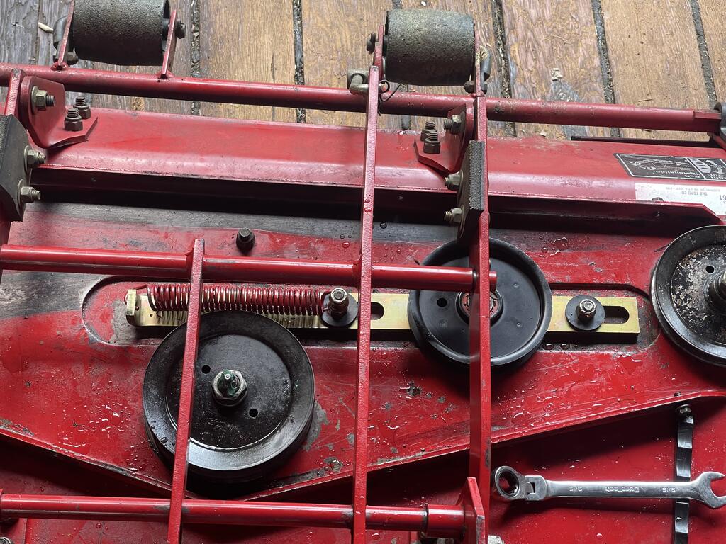

CubanB 4 #11 Posted August 18, 2024 Thank you all for your help. I have replaced the idler bar, pulley, and spring with new OEM parts. Brand new belt as well. The old belt was more like a piece of rope, it was rubbing on something. Hopefully I will get many more years of use out of it! 1 2 Share this post Link to post Share on other sites

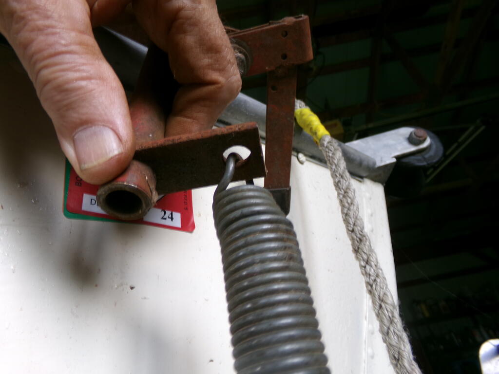

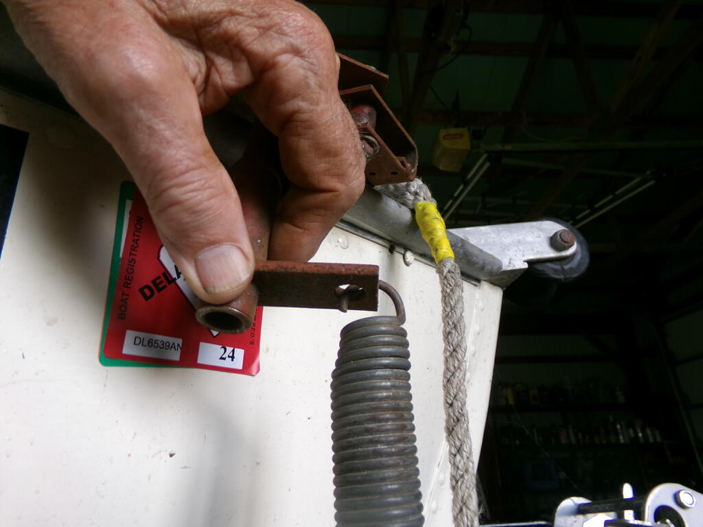

Ed Kennell 43,116 #12 Posted August 18, 2024 Looks great. Good to see you moved the idler pully away from the slide bar bolt. I like to attach the spring thru the center of the hole. I feel it puts less stress on the spring hook that causes them to break. Yours Mine No biggy, but it may make your new spring last for 50 years instead of 20. 2 Share this post Link to post Share on other sites
peter lena 9,471 #13 Posted August 18, 2024 @Ed Kennell totally agree on the spring placement , ensuring its action / survival , usually pick up a change point when i,m snooping around an issue . pete 1 Share this post Link to post Share on other sites
