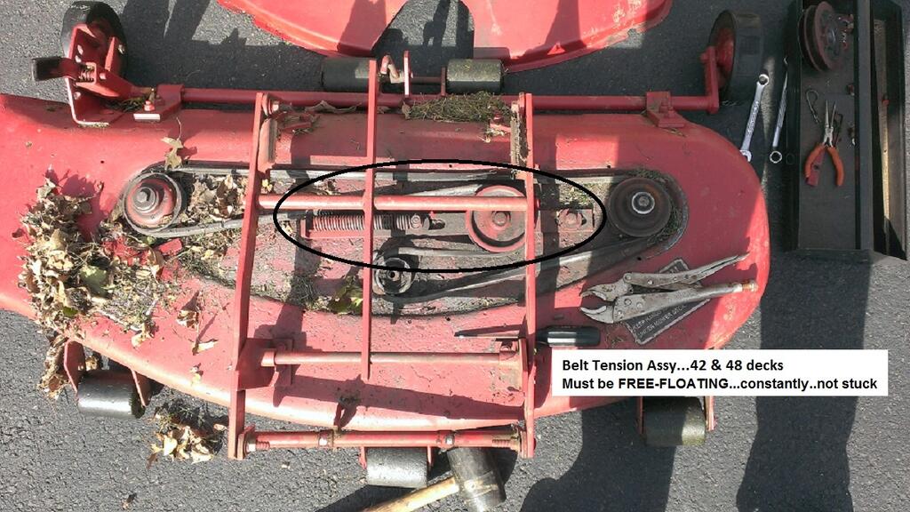

daveoman1966 3,884 #4 Posted August 8, 2024 The 'belt tensioner' you refer to. The tension idler --- the FLAT BAR --- MUST be free to 'float' to keep correct belt tension on all 3 spindle pulleys. My guess...there is dirt debris built up UNDER that flat bar---restricting its 'free floating' nature. Take the deck off the tractor...remove the belt cover(s) and inspect. Clean out any and all debris....Use a high pressure blow gun under the flat bar to clean all the sh__ out. DO NOT lube afterward.... Any kind of lube is a DIRT MAGNET. Silicone is prolly OK to use. 1 1 Share this post Link to post Share on other sites
Ed Kennell 46,557 #5 Posted August 8, 2024 (edited) If the two outside blades stop and the center keeps turning, the deck belt tensioner is not keeping the deck belt tight. Clean the slider and/or get a new spring. If they all stop and the PTO drive belt is still moving, the belt is slipping on the center deck pulley. Adjust the mule drive to tighten the belt. Oh, to the Edited August 8, 2024 by Ed Kennell 1 Share this post Link to post Share on other sites

Skwerl58 831 #7 Posted August 9, 2024 My deck had a similar issue and the deck idler pulley bearing was shot. Replaced the pulley, new belt, cleaned and lubed the bar and been good since. You will figure it out and learn a lot while doing it. Share this post Link to post Share on other sites
