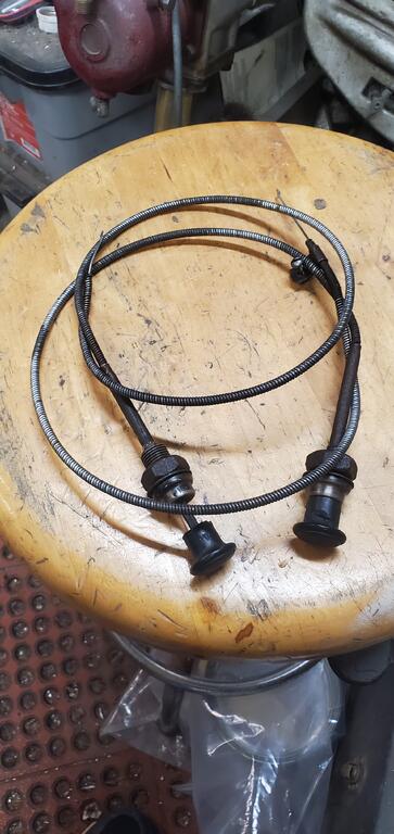

Joe401 5 #1 Posted August 8, 2024 Hi , has anyone tried electrolysis on rusty frozen throttle /choke cables ? Thanks Share this post Link to post Share on other sites

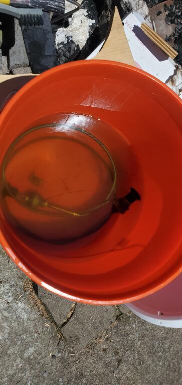

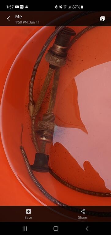

Joe401 5 #3 Posted August 8, 2024 Thanks, I was not aware that it only worked on the outside surface. Just trying to keep things as original as possible. I have had them soaking in Evapo-Rust since June 10th (2 months) , occasionally brushing off any residue on the outside. I wouldn't recommend that avenue of rust removal. Thank you again for your insight. 1 Share this post Link to post Share on other sites

Joe401 5 #10 Posted August 9, 2024 (edited) Yes I have them in a coil about 8" every 2 weeks , I bend the circle the opposite way . The submerged photos were from early June. I can get a current photo tomorrow. Edited August 9, 2024 by Joe401 Dating photos to show progression. 1 1 Share this post Link to post Share on other sites
