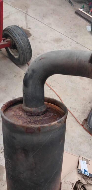

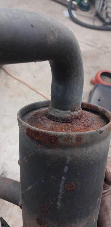

fourwheelhorseman 362 #79 Posted August 18, 2024 I’m still waiting on the valves that I ordered, as many of you know I’ve been looking for a replacement muffler for my 8speed 160 and since my new automatic needs a muffler as well, I’ve really been hitting the beat for to see what’s out there. Well I scored two the other day. They were both cracked at the point where the pipe meets the muffler body, easy fix, now both are welded up and are usable. I’ve already installed one of the mufflers on my 8 speed and it made a noticeable audible, improvement. I also scored a new hood for the automatic as well as plastic choke handle, front axle spindles and a throttle cable for my charger 10 ( that will be my next project). I’ve shown pictures of what one of them looked like before my hack welding job..I will not show after.. lol .. 2 Share this post Link to post Share on other sites
ebinmaine 80,078 #80 Posted August 18, 2024 1 hour ago, fourwheelhorseman said: I’ve shown pictures of what one of them looked like before my hack welding job..I will not show after.. lol .. Old saying about metal repair. The grinder you are makes you the welder you ain't. I'm OK with the fact that I can't often make a pretty weld. I have a 4" grinder for looks. 1 1 Share this post Link to post Share on other sites
fourwheelhorseman 362 #81 Posted August 18, 2024 2 hours ago, ebinmaine said: Old saying about metal repair. The grinder you are makes you the welder you ain't. I'm OK with the fact that I can't often make a pretty weld. I have a 4" grinder for looks. Never heard that quote before, but I agree! I just did t take the time to grind my welding imperfections, as long as it holds I’m happy with! 1 1 Share this post Link to post Share on other sites

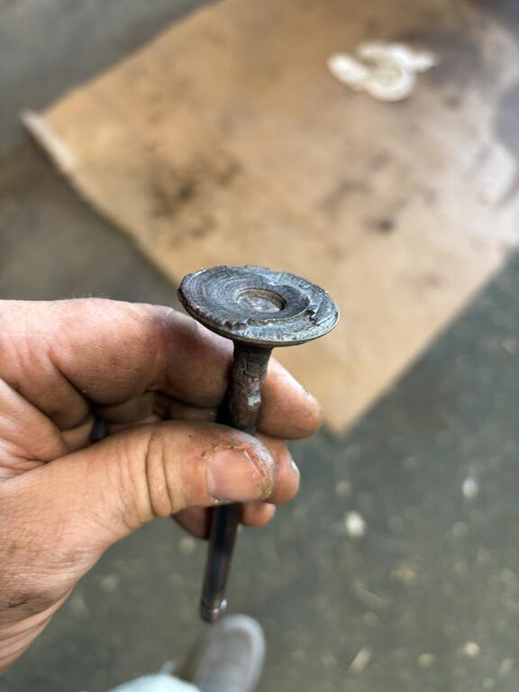

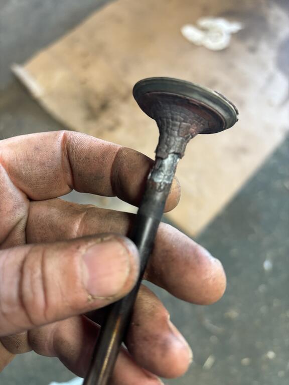

fourwheelhorseman 362 #88 Posted August 24, 2024 Well I ended up replacing the exhaust valve with a new one, new headgasket, new valve cover gaskets, new fuel pump gasket and she runs like a champ now!! Plenty of power! Honestly I figured out the real culprit as to why it ran with lack of power… while I was re-installing the carburetor, I noticed the butterfly on the carb is backwards for a different model, so when the choke is off from on the dash.. it was actually on… it ran.. but terribly. I adjusted the carb and flipped the choke open, it ran perfectly! So took the cable off the choke and have to manually turn the choke on and off. I either need the correct choke shaft and butterfly or I have another option, the tractor came with the right carb, I can’t tell if it was the original carb or not, but the choke shaft is correct. I’ve never been able to remove the screws that hold the butterfly on either the choke or throttle shaft, the screws always break. soooo in short, the tractor ran poorly from the blown head gasket, carb choke always on and carb adjusted incorrectly.. or correct enough to make it run with the choke on. I don’t think the valve was burnt enough to cause it run bad, it seated correctly.. but it wasn’t going to last much longer. Anyhow, in search of the correct choke shaft for this tractor, butterfly and small screws so I can hook up the choke properly. 2 Share this post Link to post Share on other sites

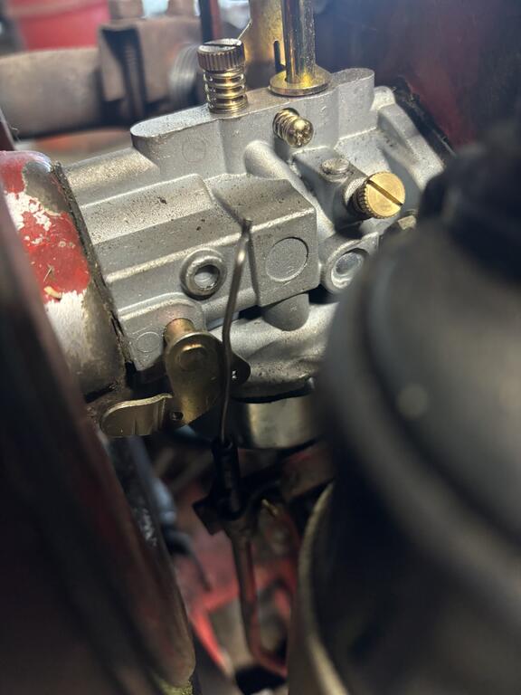

fourwheelhorseman 362 #91 Posted August 25, 2024 Here’s what I have, the tab is bent on the choke rod linkage flange, most likely the previous owner did that so the that cable would push it unobstructed? Its backwards from what I need… Share this post Link to post Share on other sites

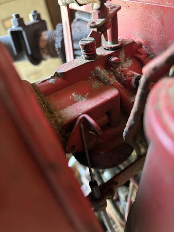

fourwheelhorseman 362 #92 Posted August 25, 2024 Just now, fourwheelhorseman said: Here’s what I have, the tab is bent on the choke rod linkage flange, most likely the previous owner did that so the that cable would push it unobstructed? Its backwards from what I need… And the photo below is what I actually need.. this photo is taken from my other 160, 1 Share this post Link to post Share on other sites
pfrederi 20,992 #93 Posted August 25, 2024 (edited) I have a couple WHs that have the choke operating backwards (Lever up run, down choke). On a couple I put little label's 0n the instrument panel. On another it is an anti theft device Easier and cheaper than getting a replacement choke shaft and putting int in... Edited August 25, 2024 by pfrederi 2 Share this post Link to post Share on other sites
ebinmaine 80,078 #94 Posted August 25, 2024 43 minutes ago, fourwheelhorseman said: Here’s what I have, the tab is bent on the choke rod linkage flange, most likely the previous owner did that so the that cable would push it unobstructed? Its backwards from what I need… Yeah that's one o' them El cheapo chinesium crabulatirs. I refuse to use them anymore. If you have an original Kohler carb and want it fixed up send me a PM. Be happy to help. 1 Share this post Link to post Share on other sites
fourwheelhorseman 362 #95 Posted August 25, 2024 (edited) Actually I have one soaking in some chem dip as of yesterday, I had thought tho.. if I can’t get it figured out to try and change the el cheapo choke bracket. it actually runs pretty good with the china carb… oddly enough. Edited August 25, 2024 by fourwheelhorseman 2 Share this post Link to post Share on other sites

ebinmaine 80,078 #98 Posted August 25, 2024 1 hour ago, fourwheelhorseman said: Actually I have one soaking in some chem dip as of yesterday, I had thought tho.. if I can’t get it figured out to try and change the el cheapo choke bracket. it actually runs pretty good with the china carb… oddly enough. It'll run fine... until it doesn't. Just keep a close watch on the upper throttle shaft opening. That's where I've seen two go bad recently. Share this post Link to post Share on other sites
lynnmor 8,970 #99 Posted August 25, 2024 2 hours ago, fourwheelhorseman said: Here’s what I have, the tab is bent on the choke rod linkage flange, most likely the previous owner did that so the that cable would push it unobstructed? Its backwards from what I need… It appears that you have a small hole to the left and right of the shaft, couldn't you choose the one that works correctly? Share this post Link to post Share on other sites
