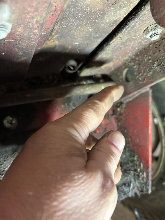

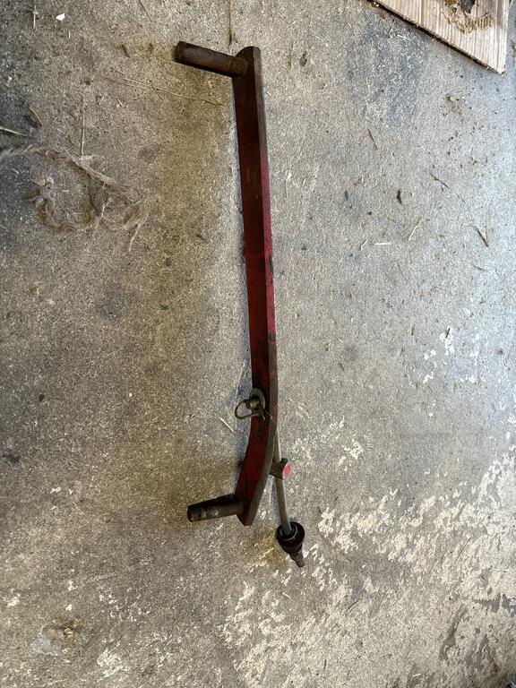

fourwheelhorseman 362 #53 Posted August 11, 2024 Hey, I’m missing the rear bracket that pulls the deck up on the tractor. Or did they do somthing different in 1976? I’m comparing it to my 1974 8speed. I noticed it wasn’t lifting the rear portion of the deck off the ground and started looking around at it. I then removed the deck and found this bar connected to the deck and that was the only thing lifting the deck.. seems wrong according to my 8 speed. In the first picture I’m pointing at an empty hole, that same hole is filled with a t shaped bracket that helps lift the deck on my 8speed. The opposite side has a hole that is covered on the outside. I’d buy one of these if I’m missing it.. 1 Share this post Link to post Share on other sites
ebinmaine 80,755 #54 Posted August 11, 2024 Should be identical to the other tractor. I MAY have one of those bars. Not sure. 2 Share this post Link to post Share on other sites

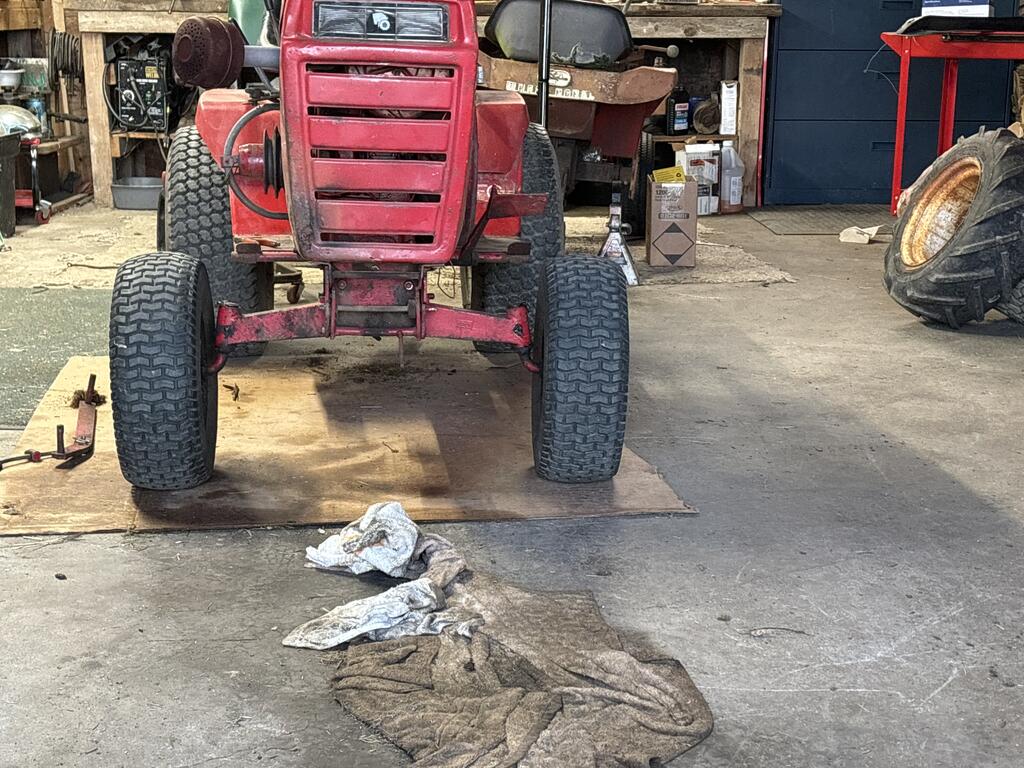

fourwheelhorseman 362 #55 Posted August 11, 2024 13 minutes ago, ebinmaine said: Should be identical to the other tractor. I MAY have one of those bars. Not sure. That’s what I thought… also looks like the right front axle has been “ tweaked” a little.. look at the camber.. 1 Share this post Link to post Share on other sites
ebinmaine 80,755 #56 Posted August 11, 2024 Yeah something odd there. You can use your other C Series to measure and compare. Identical front ends. 1 Share this post Link to post Share on other sites
Handy Don 17,482 #57 Posted August 11, 2024 56 minutes ago, fourwheelhorseman said: That intermediate lift lever looks like it’s missing the rod on one side where it would go into the frame socket and hole. Get to the IPL for your machine and you’ll see there is a bushing and e-clip to keep it locked in. A to Z will definitely have one of these with the bushing and clip 1 Share this post Link to post Share on other sites
fourwheelhorseman 362 #58 Posted August 11, 2024 17 minutes ago, Handy Don said: That intermediate lift lever looks like it’s missing the rod on one side where it would go into the frame socket and hole. Get to the IPL for your machine and you’ll see there is a bushing and e-clip to keep it locked in. A to Z will definitely have one of these with the bushing and clip Very cool! Do you have a contact number for them? Ebmaine is also looking for me 1 Share this post Link to post Share on other sites
fourwheelhorseman 362 #59 Posted August 11, 2024 Just now, fourwheelhorseman said: Very cool! Do you have a contact number for them? Ebmaine is also looking for me I bet that’s a real bear to install.. if I’m not mistaken about 25 years ago I had the same issue, I installed it, but don’t asked me how.. 1 Share this post Link to post Share on other sites
Handy Don 17,482 #60 Posted August 11, 2024 3 minutes ago, fourwheelhorseman said: Very cool! Do you have a contact number for them? Ebmaine is also looking for me They are in the vendor list at the top of the page. Definitely call since they are ALWAYS busy and it can take time to get to their email. A-to-Z 4 minutes ago, fourwheelhorseman said: I bet that’s a real bear to install.. if I’m not mistaken about 25 years ago I had the same issue, I installed it, but don’t asked me how.. It looks hard but it’s really a clever piece of cake. Slide the bushing (shoulder side toward the middle, away from the end) onto the left side rod about 2 inches. Stick the left rod end into its hole and then the right end into its socket. Slide the bushing over into the hole on the left frame and secure it with the e-clip 2 Share this post Link to post Share on other sites
fourwheelhorseman 362 #61 Posted August 11, 2024 6 minutes ago, Handy Don said: They are in the vendor list at the top of the page. Definitely call since they are ALWAYS busy and it can take time to get to their email. A-to-Z It looks hard but it’s really a clever piece of cake. Slide the bushing (shoulder side toward the middle, away from the end) onto the left side rod about 2 inches. Stick the left rod end into its hole and then the right end into its socket. Slide the bushing over into the hole on the left frame and secure it with the e-clip I think I remember that! Thanks for the how-to! I’ll get ahold of them Monday for that. 1 Share this post Link to post Share on other sites
fourwheelhorseman 362 #62 Posted August 14, 2024 Well I installed the lift bar, Handy Don is correct it’s a clever piece of cake! Also reinstalled the mower deck. Waiting on my new head gasket to arrive. I had to buy a piece of glass for hand planing as my old one got broken when we moved. This tractor with a blown head gasket will certainly fool you, it fires up, runs perfect, until you run the mower deck then it doesn’t have hardly enough power to mow. I also noticed it had low compression when I looked it over before buying it. I can literally turn the engine over by pressing my hand on the flywheel screen and turning it over that way. It doesn’t smoke, rattle or knock, so I’m guessing it’s the just the blown head gasket that’s causing the low compression and lack of power. 1 2 Share this post Link to post Share on other sites

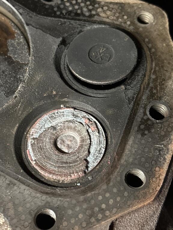

fourwheelhorseman 362 #68 Posted August 14, 2024 We’ll check this out! Taking the head off I found this exhaust valve….Ive never seen one like this.. opinions? 1 Share this post Link to post Share on other sites
fourwheelhorseman 362 #69 Posted August 14, 2024 The crosshatching on the cylinder is still present and no wobble from the piston at all, looks like I’ll b replacing an exhaust valve.. 2 Share this post Link to post Share on other sites
fourwheelhorseman 362 #71 Posted August 14, 2024 11 minutes ago, ebinmaine said: Wow! Ya, I’ve never seen an exhaust valve look like that! I’ve also never changed out the valves in the k series… I’m assuming the carb and fuel pump and points cover comes off to get to the cover, is this an aggravating difficult job? Also I plan on grinding the valves while still assembled.. thoughts? Share this post Link to post Share on other sites
lynnmor 9,042 #72 Posted August 14, 2024 Pull both valves and give us a better look. It appears that you will need to check the seats as well. Are you using snake oil in your fuel? Share this post Link to post Share on other sites

fourwheelhorseman 362 #74 Posted August 15, 2024 31 minutes ago, lynnmor said: Pull both valves and give us a better look. It appears that you will need to check the seats as well. Are you using snake oil in your fuel? I JUST got this 160, I will pull both valves though and reseat the new exhaust valve. I’ve never replaced valves in a k series, is it tricky? Share this post Link to post Share on other sites
oliver2-44 11,753 #75 Posted August 15, 2024 Pulling/changing valves is really not hard. Sometimes the little cone shaped valve keepers can be a little bit of a pain. Have a good small engine valve compress helps. Most of the newer one are junk. 1 Share this post Link to post Share on other sites
