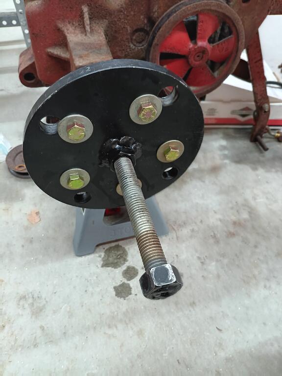

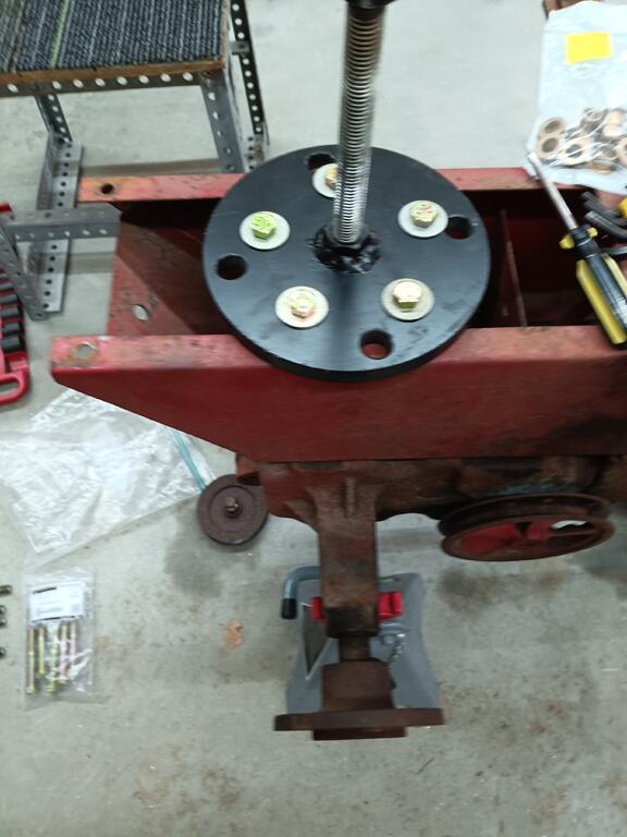

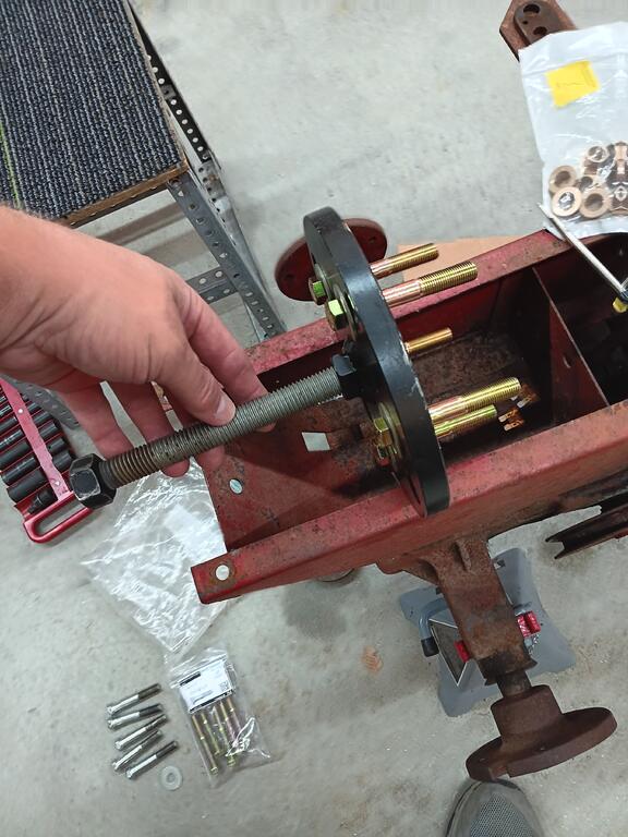

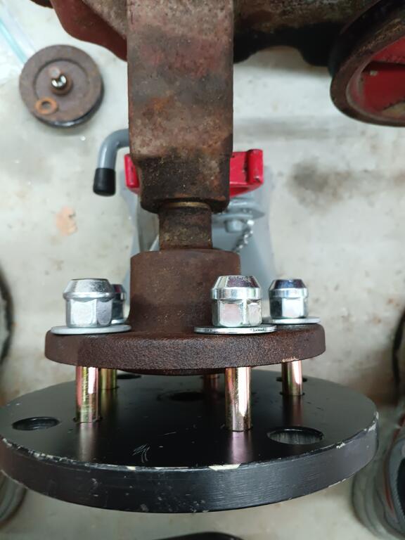

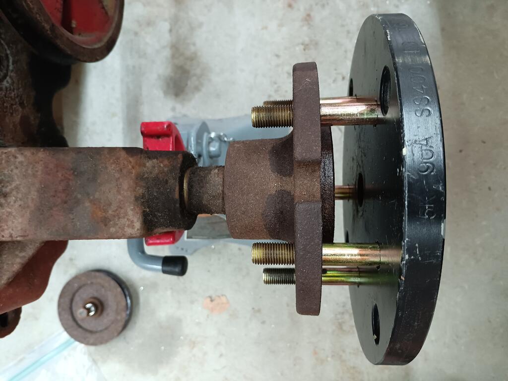

ebinmaine 80,279 #10 Posted August 3, 2024 @Condor Here's a few pics of the puller setup I use. This is a home shop made piece. (Not my build). These are 7/16-20 x 3" grade 8 bolts. I put 7/16 lugnuts and washers on to help spread the pulling strain/pressure. 4 Share this post Link to post Share on other sites

ri702bill 12,808 #13 Posted August 3, 2024 Is that "weld" or rabbit droppings holding the nut in place??? I too can lay a bead with the worst of them....!! Share this post Link to post Share on other sites
adsm08 5,006 #14 Posted August 3, 2024 19 minutes ago, ri702bill said: Is that "weld" or rabbit droppings holding the nut in place??? I too can lay a bead with the worst of them....!! JB weld 1 1 Share this post Link to post Share on other sites
ri702bill 12,808 #15 Posted August 3, 2024 At least it is in compression instead of tension. It just needs to stand up to the rotary force !! Share this post Link to post Share on other sites
ebinmaine 80,279 #16 Posted August 3, 2024 1 hour ago, ri702bill said: Is that "weld" That's a series of six large welds. I'd bet it would pull a fair amount before I ever think of replacement. Share this post Link to post Share on other sites
oliver2-44 11,694 #17 Posted August 3, 2024 (edited) 2 hours ago, ri702bill said: Is that "weld" or rabbit droppings holding the nut in place??? I too can lay a bead with the worst of them....!! That’s a new one. EB certainly brings out the “fertilizer” in these conversations Of course. I don’t have any room to comment on the weld “Burn them in hot and deep so it doesn’t matter what they look like on top” Edited August 3, 2024 by oliver2-44 1 1 Share this post Link to post Share on other sites
ebinmaine 80,279 #18 Posted August 3, 2024 And there not my welds..... Share this post Link to post Share on other sites
squonk 47,887 #19 Posted August 3, 2024 (edited) Comment on Eric's puller. If building your own puller, try to use fine thread on the force screw. It will pull slower with more pulling force. Kind of like low gear on a tractor. Edited August 3, 2024 by squonk 3 Share this post Link to post Share on other sites
ebinmaine 80,279 #20 Posted August 3, 2024 2 minutes ago, squonk said: Comment on Eric's puller. If building your own puller, try to use fine thread on the force screw. It will pull slower with more pulling force. Kind of like low gear on a tractor. Agreed. That was discussed when I bought it. This is the nut & bolt handy to the builder when it was put together. It's treated me well as is. Given the strength of the setup I have now I'll likely be using it for years. I'm known to be a tad bit rough on tools so If I ever do break or damage the threads I'll go to a fine thread. 2 Share this post Link to post Share on other sites
