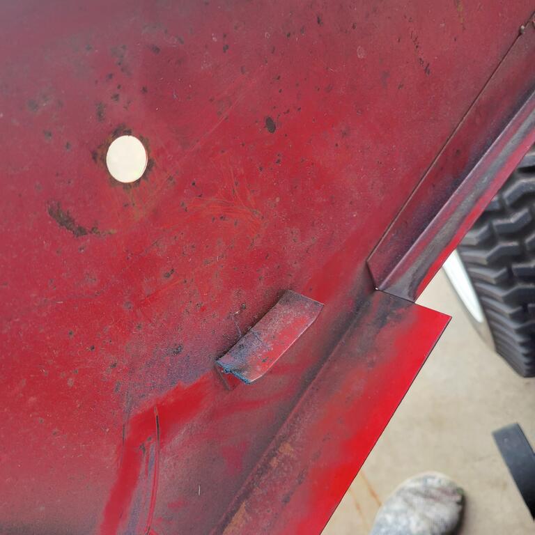

Ed Kennell 47,385 #19 Posted August 3, 2024 5 hours ago, Mr guisepp said: My belt though the correct size it seems tighter than the one in this video I think your belt is the correct length. Your Raider does not have the stationary belt stop tab on the tractor as shown in my video of my 310-8. Does your belt guard have a similar tab? If it does, make sure the belt is above the tab when you install the guard. Like Eric said, your belt guard must be in place to support the bottom loop of the belt. This support aids in stopping the belt movement. 1 1 Share this post Link to post Share on other sites
Mr guisepp 13 #20 Posted August 4, 2024 is this the tab you mean? 1 Share this post Link to post Share on other sites
ebinmaine 80,755 #21 Posted August 4, 2024 1 minute ago, Mr guisepp said: is this the tab you mean? You see the silver wear stripe on your guard? That's the part that keeps the belt in check when disengaged by the clutch. Share this post Link to post Share on other sites
Mr guisepp 13 #22 Posted August 4, 2024 1 hour ago, ebinmaine said: In the video you don't have the belt guard in place. Does the belt behave the same with the belt guard installed properly? yes...assuming I installed it properly Share this post Link to post Share on other sites
lynnmor 9,042 #23 Posted August 4, 2024 Note that Ed’s video shows the guide off the belt while turning the pulley where yours is riding hard and shaving the belt. Share this post Link to post Share on other sites
Mr guisepp 13 #24 Posted August 4, 2024 2 minutes ago, ebinmaine said: You see the silver wear stripe on your guard? That's the part that keeps the belt in check when disengaged by the clutch. so that is is looking down on the top of the guard...are you saying the belt needs to be positioned under that? Share this post Link to post Share on other sites
Mr guisepp 13 #25 Posted August 4, 2024 2 minutes ago, lynnmor said: Note that Ed’s video shows the guide off the belt while turning the pulley where yours is riding hard and shaving the belt. yes....so how do I stop that Share this post Link to post Share on other sites
