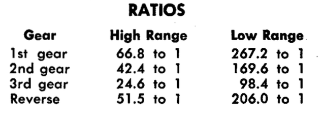

Pullstart 68,938 #7 Posted August 3, 2024 18 hours ago, ri702bill said: 3Lo is faster than 1HI, but a bit slower than 2Hi. Somewhere there is a chart. I feel like 3lo is still a tiny bit slower than 1hi based on my butt dyno experiences but I can’t find that dang chart. Share this post Link to post Share on other sites
Handy Don 15,994 #8 Posted August 3, 2024 (edited) 13 minutes ago, Pullstart said: Somewhere there is a chart. I feel like 3lo is still a tiny bit slower than 1hi based on my butt dyno experiences but I can’t find that dang chart. This is for 8-speeds but the 6-speeds are the same. 3rd low is still slower that 1st high by quite a bit. Th high/low is a factor of 4 ratio. Edited August 3, 2024 by Handy Don 1 Share this post Link to post Share on other sites
