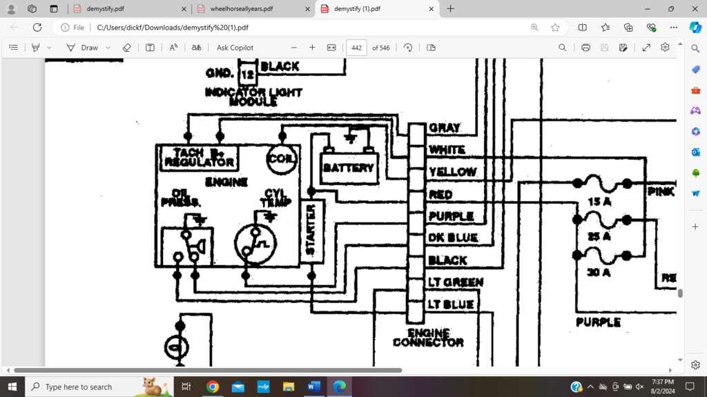

953 nut 64,636 #12 Posted August 2, 2024 Here is a link to 45 files related to the 1995 416-8 model 74320. Save them to your computer for future referance. https://www.wheelhorseforum.com/search/?&q=73420&type=downloads_file&search_and_or=or&sortby=relevancy. Pages 7-57 to 7-60 of the Demistification Guide gives a full wiring diagram for your tractor as well as system wiring detail. I did notice that the "9 PIN" connector wiring in that guide is inaccurate. The wiring shown for the 520 of the same year range is correct and I have attached it below. The 9 pin is an Onan wiring connector that connects your engine to the rest of the tractor. 1 Share this post Link to post Share on other sites
