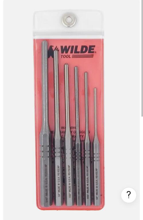

ebinmaine 81,282 #5 Posted August 1, 2024 I couldn't recall what brand mine were so I went and looked. Wilde Tool. This is an online sales pic. 3 Share this post Link to post Share on other sites

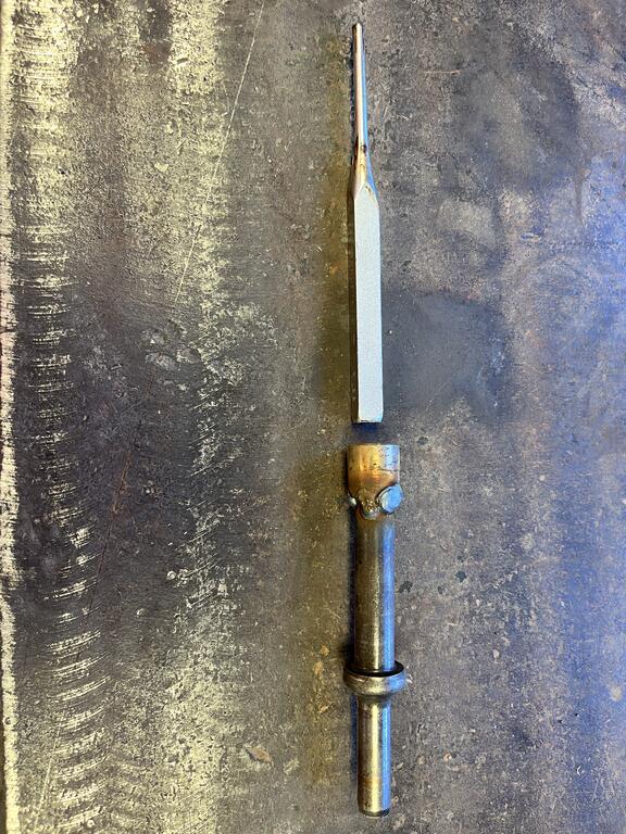

Wvtroutbum81 327 #6 Posted August 1, 2024 Air chisel, no bracing or beating with a hammer. This is the way, roll pin comes out in seconds. 3 1 Share this post Link to post Share on other sites

Wvtroutbum81 327 #10 Posted August 6, 2024 14 hours ago, adsm08 said: Vice grips. I just cut the end off a old chisel and welded a socket to it 1 Share this post Link to post Share on other sites

ebinmaine 81,282 #12 Posted August 6, 2024 8 minutes ago, Sailman said: I assume you want a socket that fits the shank of the right punch? Sounds like that would be a 7/32 punch for a C-160 steering wheel roll pin. Correct me if I am wrong. Thanks. I used a 1/4 1 Share this post Link to post Share on other sites
