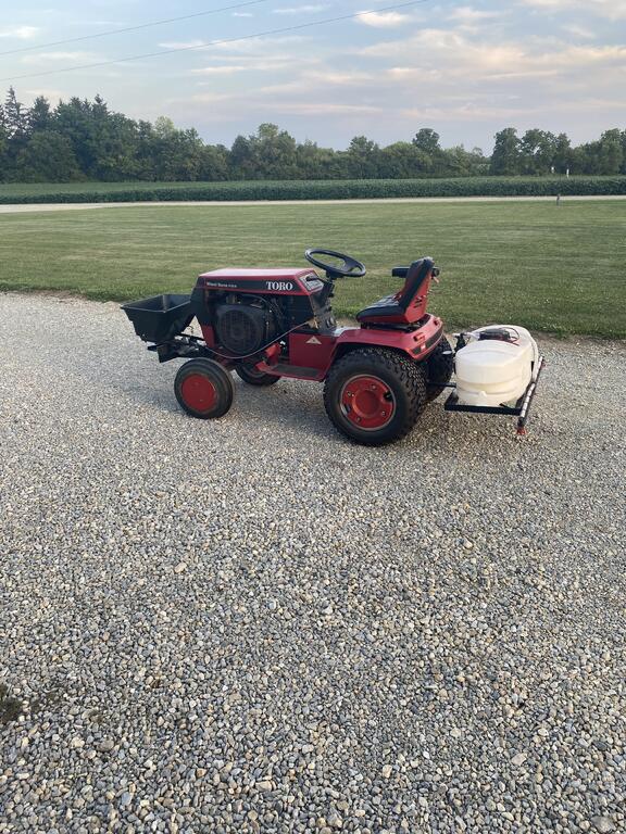

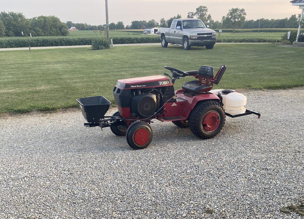

Tonytoro416 1,372 #1 Posted July 28, 2024 It’s that time of the year in Indiana where you have to keep the grubs at bay unless you want a mole problem. The particular dry product I use has to be watered in soon after application. Water hose don’t reach everywhere so I set the 416h to spread and water all in one shot 6 9 Share this post Link to post Share on other sites
TractorEd 675 #2 Posted July 28, 2024 (edited) Nice mosheen! & setup! I like 2 fer’s! is that spreader electric? Edited July 28, 2024 by TractorEd 1 Share this post Link to post Share on other sites
Tonytoro416 1,372 #3 Posted July 28, 2024 10 minutes ago, TractorEd said: Nice mosheen! & setup! I like 2 fer’s! is that spreader electric? Thank you sir. Yes it’s electric. I used a choke cable I had laying around to open and close the gate in the bottom of the spreader. I also installed a speed controller and dial to adjust spinner speed. It was originally setup to just spin at one speed 4 1 Share this post Link to post Share on other sites
TractorEd 675 #4 Posted July 28, 2024 5 minutes ago, Tonytoro416 said: I used a choke cable I had laying around to open and close the gate in the bottom of the spreader. I also installed a speed controller and dial to adjust spinner speed. It was originally setup to just spin at one speed Nice!!! Very clever you Hoosiers are. 2 Share this post Link to post Share on other sites
Tonytoro416 1,372 #5 Posted July 28, 2024 I do appreciate that. Like most anything I do it’s out of necessity. I spread a few yards in town and being able to slow the spinner down is a must. First time I used it I was bouncing fertilizer off the neighbors house lol 5 Share this post Link to post Share on other sites
