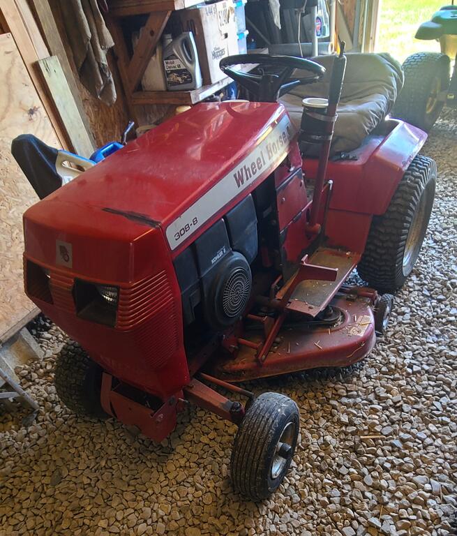

Steve Ealy 4 #1 Posted July 27, 2024 Greetings, Just joined! The reason is, I have a 308-8 with the valves banging their way into the head, or so I've been told by a local shop?! They've also said it's prohibitively expensive to repair and the replacement engine is very rare! My question is the obvious one - what to do with it? 2 Share this post Link to post Share on other sites

Steve Ealy 4 #8 Posted July 27, 2024 All great info! Thanks guys! As you can tell I know nothing about Kohlers! In an effort to be correct I meant "the valves are pounding their way into the block"... I then took it to the shop close to my house and it was pretty much just as 'Ebinmaine' described, they didn't want the job... If I run it, after a bit the power starts to erode until it eventually dies! I'll mess with it and see if I can get it running? I'll post some video following that. Share this post Link to post Share on other sites

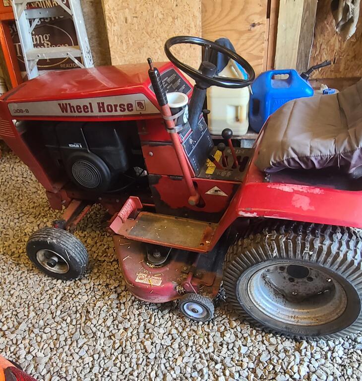

Steve Ealy 4 #23 Posted July 29, 2024 (edited) I've never posted a video to Youtube, so that will be another learning experience for me! As for the tractor, it sounds great sitting at idle and will run fine for a while... With a load however, after a bit it loses power until it eventually dies. I've not tried to run it with the fuel tank removed. I guess that can be an experiment for later today in between rain drops? Here is my first attempt at attaching a link...https://youtu.be/qvlr3w6H-Xo Edited July 29, 2024 by Steve Ealy Added a link! Share this post Link to post Share on other sites
Ed Kennell 47,950 #24 Posted July 29, 2024 Sounds like it simply runs out of fuel when the carb bowl gets empty. Lack of or slow fuel supply can start at the tank. Clogged vent in cap Clogged screen on the shut off petcock Clogged petcock Dirty fuel filter Remove the fuel line at the input to the fuel pump and make sure you have a good free flowing fuel supply. If you do not, one or all of those four items may be the problem. If you do have a good fuel flow, we can then move on to checking the fuel pump and carb for problems. 3 1 Share this post Link to post Share on other sites
