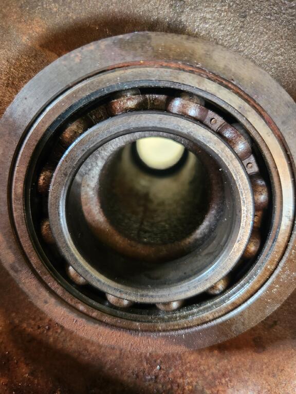

BoilerBrown 0 #1 Posted July 24, 2024 I'm rebuilding the 8 speed transmission on a recently acquired C-175. I found a used set of 1533 ball bearings and bought them. Turns out that is not what mine has. Is there another part number, for a slightly larger ball bearing? I can't seem to find it. The bearing I am replacing measures 1.675" OD and 1.565" ID. Only words on it are "Germany" on the outer race. Share this post Link to post Share on other sites
BoilerBrown 0 #2 Posted July 24, 2024 Correction, 2.675" OD. Share this post Link to post Share on other sites
gwest_ca-(File Mod) 12,505 #3 Posted July 24, 2024 Yes there were alternate bearings used but forget when. What is you tractor model number? That should help finding it. Share this post Link to post Share on other sites
gwest_ca-(File Mod) 12,505 #4 Posted July 24, 2024 Yes there were alternate bearings used but forget when. What is you tractor model number? That should help finding it. This may be it. Click on the picture in the link. Share this post Link to post Share on other sites
BoilerBrown 0 #5 Posted July 24, 2024 2 minutes ago, gwest_ca said: Yes there were alternate bearings used but forget when. What is you tractor model number? That should help finding it. C-175 I'll have to run out and get the serial number later to narrow down the year. I think I may have found it. Cross references to an SKF 6008 bearing. Share this post Link to post Share on other sites
