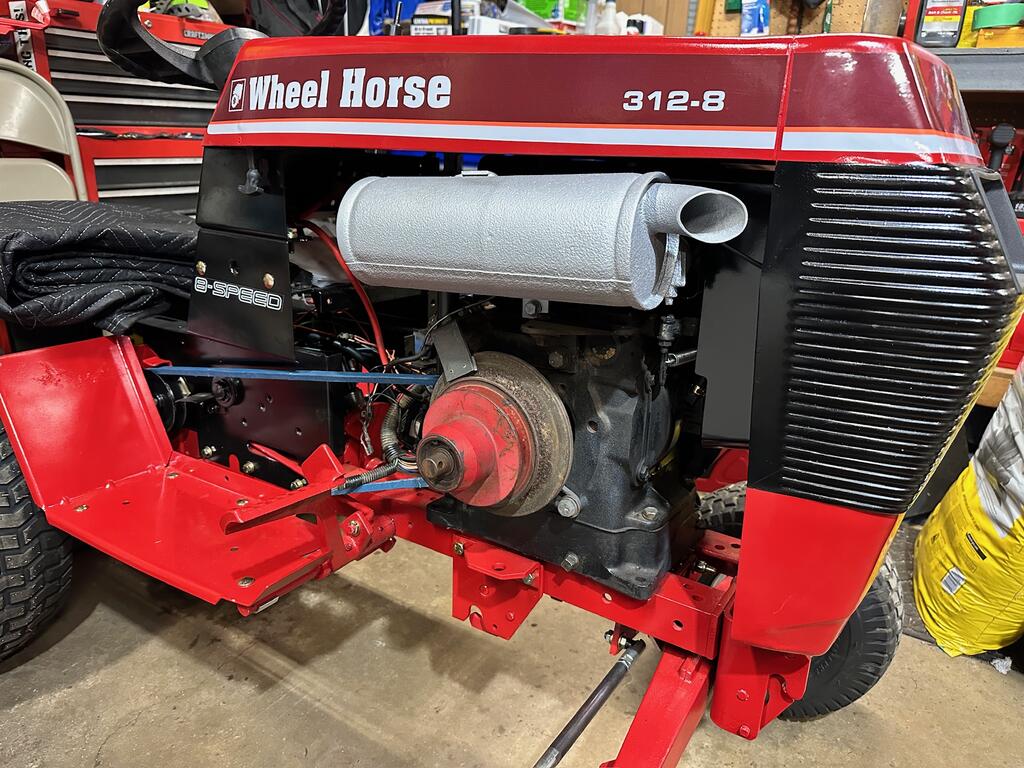

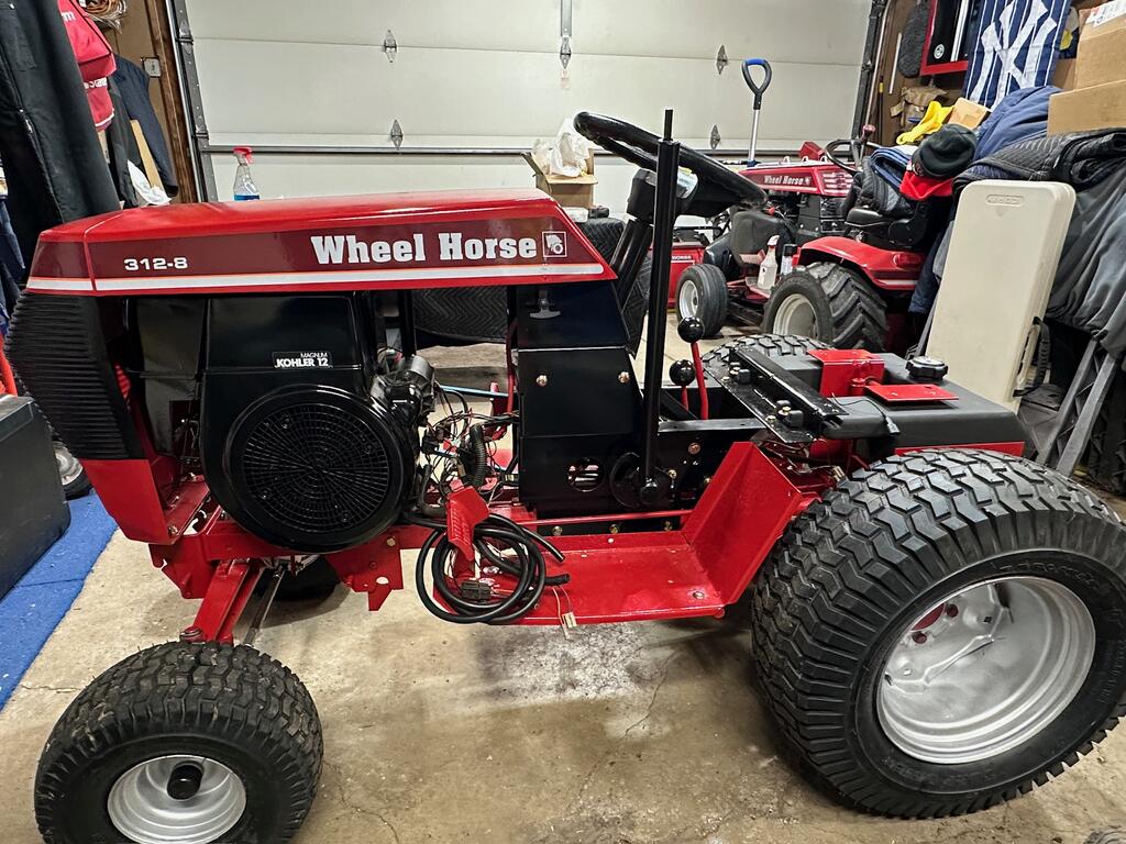

Andy N. 2,605 #2 Posted July 24, 2024 (edited) I've been slowly working on a '89 312-8 for a few years. Mostly busy work during the winter. I went with Rustoleum High Performance Enamel Aluminum (rattle can) on my wheels. Here's my progress so far, but haven't worked on it since March. I would recommend changing all the transmission seals (axles, brake and drive shaft) and shifter boot. You can get them from @wheelhorseman at https://wheelhorsepartsandmore.com/. I also painted the muffler with a hight temp silver and installed LED headlights and tail lights. The lights can be found on Amazon, https://a.co/d/9gg7Bsq https://a.co/d/dDMMBg7 Edited July 24, 2024 by Andy N. 5 5 Share this post Link to post Share on other sites

Toby Stockman 89 #5 Posted July 24, 2024 Andy Thank you for the info i ordered a seal kit for it a few days ago. The headlights and tail lights are a nice touch for sure. i like the rim color so i will be painting them that color Thanks! 2 Share this post Link to post Share on other sites
