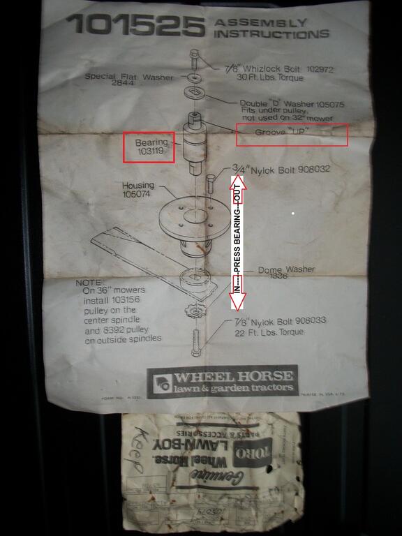

chalky 4 #1 Posted July 19, 2024 If I replace the the shaft bearings #103119 ,into the old housing. That will not only work , but will solve my noise promblem ? Or a waste of money . Thanks !! Share this post Link to post Share on other sites
daveoman1966 3,884 #2 Posted July 19, 2024 shaft bearing 103119 is a factory sealed part with the bearings already installed on the shaft... Press out the old one from the bottoms side....up thru the top. PRESS install the new one from top to bottom. 1 1 1 Share this post Link to post Share on other sites
