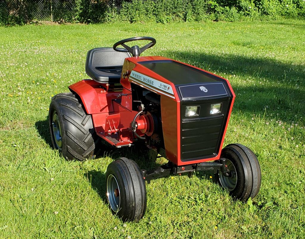

Pullstart 71,562 #2 Posted July 16, 2024 Stock? Most likely. You may be able to raise the fender however. These are 24x12-12s on my 520Xi for reference. 1 Share this post Link to post Share on other sites

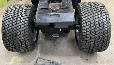

Thor27 899 #12 Posted July 17, 2024 24x12-12 airlock. This was a 520 under the black hood & kohler. 3 Share this post Link to post Share on other sites
Thor27 899 #13 Posted July 17, 2024 Those are on a 10" rim, they were hard to stretch that wide, they would be easier to mount on 8.5"s. 1 Share this post Link to post Share on other sites

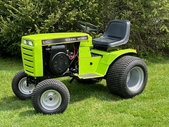

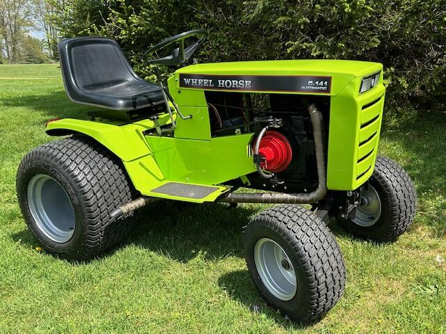

JoeM 10,318 #15 Posted July 18, 2024 Put a set of 24 12 12 on 10 inch rims, The rims had a little deeper back-set unlike the shallow ones WH used and I had to put spacers on so the tire did not contact the hydro brake. C141 plenty of room under the fender tho. I would be concerned if using a mower,. gauge wheels might hit the tires. this one is for looking and not cooking. 5 Share this post Link to post Share on other sites

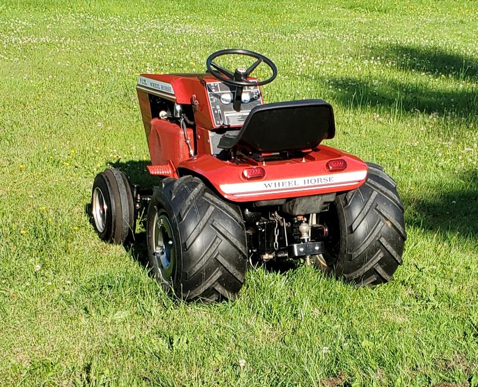

Monstrosity 1,153 #17 Posted July 19, 2024 (edited) These are 28X12 on 10.5 rims but I made them fit with gt14 rear tins. No spacer and they clear the trailer hitch mount. Edited July 19, 2024 by Monstrosity 2 2 Share this post Link to post Share on other sites
ebinmaine 81,282 #18 Posted July 19, 2024 On 7/17/2024 at 9:30 PM, JoeM said: this one is for looking Interesting color! Any more pics around? Share this post Link to post Share on other sites
JoeM 10,318 #19 Posted July 19, 2024 2 hours ago, ebinmaine said: Any more pics around? 3 Share this post Link to post Share on other sites
