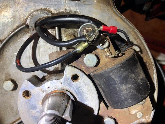

Sailman 1,305 #1 Posted July 11, 2024 I have a K-141 recoil start engine on the 704 I am trying to get running. I had spark initially but then lost it. I have followed suggested diagnostics and cannot find the problem. Any experts on this engine willing to help me figure this out??? Here is what has been done; 1. Removed all wires from the condenser, put tape on the ends, put the flywheel back on to see if I have spark. NO SPARK. What would that indicate? 2. I also took the red insulated wire from the coil OFF and just left the wire to switch and wire to points attached to condenser and did a continuity test. NO continuity to ground. Checked chafe on all wires and all are good. This should mean NO SHORT in wires. Add the coil red wire and I get continuity with ground with points open and with points closed. 2. Spark plug wire from magneto to plug is good, with solid connection at magneto. 3. Used my multi meter to check resistance on the magneto. Set at 20K I get 9.22 - 9.25 on secondary. Also indicates spark plug wire is good. Set at 200 I get .6 - .7 on the primary. These are the close to the specs I was given. So it would seem the magneto is good? Would it read 0 or a lot higher if magneto was bad? New one is expensive so I want to make sure this one is bad before I spend $$. I am at a loss to figure this out when all seems to be OK. This is outside my wheel house so....what does it mean so far? Whats next to try to solve this problem? Thanks in advance. Share this post Link to post Share on other sites

Sailman 1,305 #14 Posted July 12, 2024 (edited) I guess I am not making myself clear. I cannot get 0 with points closed. I get a reading between .03 and .06. with the points closed. What would cause that? That is my problem. I understand it needs to be .0 to run...but mine does not, I am getting resistance with points closed. Points are clean, well connected, etc. What part is not working that would cause resistance with points closed? Condenser? Magneto? There is no short in the wiring. from ignition to points. That option has been eliminated. Edited July 12, 2024 by Sailman Share this post Link to post Share on other sites

Sailman 1,305 #22 Posted July 22, 2024 I have gone through every possible link in the K-161 I have. Wires are not grounded, installed new points and new condenser so only other option must be magneto. I get a constant ground at the points and condenser connections. I do get an erratic small spark occasionally after installing new condenser, not once every revolution of the flywheel. Sound like magneto grounding out? Share this post Link to post Share on other sites
