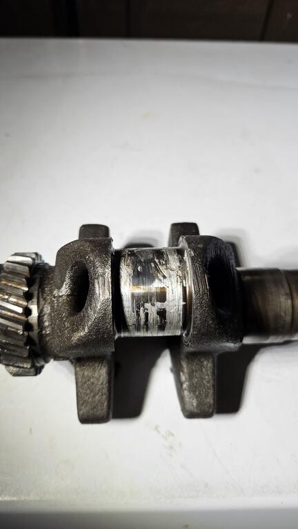

JWalser 5 #8 Posted July 9, 2024 10 hours ago, oliver2-44 said: Tell us more about what happened to your K241. \ Used Kohler K series 10,12,14,16Hp engines can fit in your tractor with very little to no modification of the tractor. The basic engine blocks are the same size. So the oil pan and belt guard mounting become the adjustable items. Your oil pan Is typically reusable after an engine failure. The belt guard may bolt right up, or require a mounting tab be welded in a slightly different location. One of the challenges switching to a modern engine is they do not have a ball bearing on the PTO side capable of handling the side load created by the Wheelhorse PTO design. You troically have to switch to n electric PTO on those modern engines. The connecting rod broke, along with the piston being damaged. I've been told the crankshaft is too damaged to be reused without machining, and that the cylinder also needs to be machined. Everything else looks fine, but might as well rebuild it since it's open. Adding up all the expenses, it's more economical to buy a new engine. Share this post Link to post Share on other sites
Tractorhead 9,217 #9 Posted July 9, 2024 Whow 😱 that looks like for me it runns long with water in oil or at least not had a regular oilchange. look here for an exchange Engine, thats the easiest way to be back in service imho. 1 Share this post Link to post Share on other sites

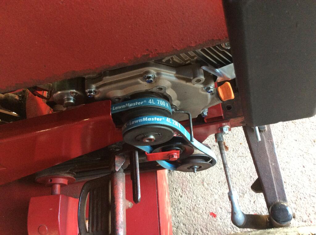

Tractorhead 9,217 #14 Posted July 9, 2024 I swaped my 656 Tecky Engine after it’s excessive oil consum to a modified Predator, i decided to use a Taper pulley instead of the Original Pulley what was slightly bigger. That run now since about 3 years completely without any Problems. I can imagine that this will also work with another Kohler Engine. the only thing i have to change was the Belts to little different Sizes than Original, but when i measured the first time the new Belt lenght i noticed me the lenght and be comfi with. The tapers can be ordered in different sizes. i got me an 85mm pulley instead the ( i believe) 65 mm what was original on the Tecky. Here is a pict after my swap. The gently increased pulleysize let me also mow in second Gear on my 2000 sqm Areal i have to mow. just as suggestion. 1 Share this post Link to post Share on other sites
