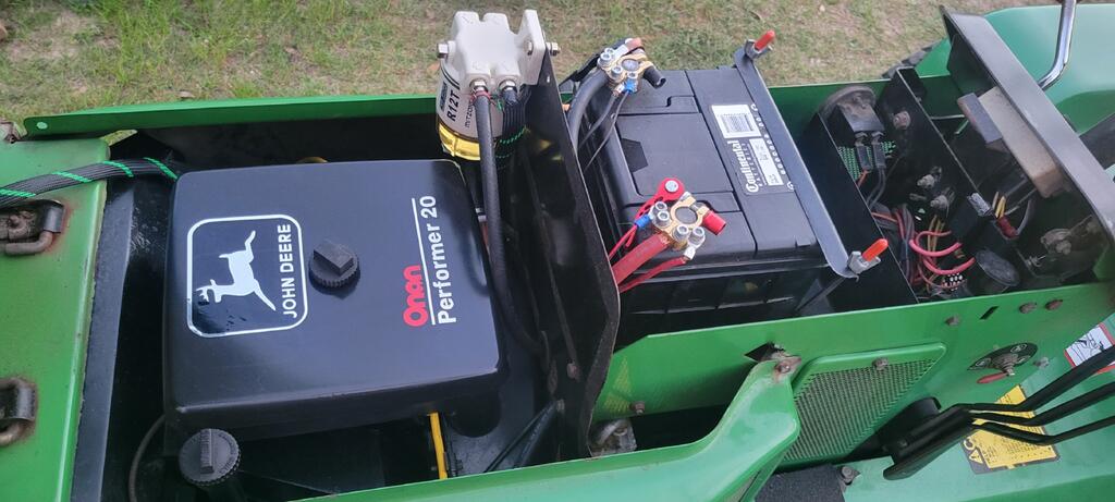

grinchsr 657 #1 Posted July 8, 2024 What are the Onan owners using for a fuel filter these days? Is a 51 micron filter going to cause a fuel starvation issue? Share this post Link to post Share on other sites
WHX?? 54,981 #2 Posted July 9, 2024 Since I have many tractors I just go with the jungle cheapies in bulk. No issues so far even on the Onans. Sure I get a leaker once in awhile. No idea what the rating is on them. 2 Share this post Link to post Share on other sites
peter lena 9,764 #3 Posted July 9, 2024 @grinchsr more often than not , fuel hose / related breakdown debris is the cause , have regularly run in a used engine on a seperate gallon of heavily treated fuel , for trial / effects , also went after fuel tank for lots of debris . BTW ues a large filter , just after tank , and a smaller one close to carb , regularly , check for effects , on any of my trials . also have fuel check valves on all my engines , so I can see standing fuel going to engine , pete Share this post Link to post Share on other sites
Bill D 2,596 #4 Posted July 10, 2024 I use Briggs filters. You can get them from Home Depot. 1/4" fitting on each side. Share this post Link to post Share on other sites
RED-Z06 2,716 #5 Posted July 10, 2024 Fuel restriction should not be a problem..i ran a 3 part filtration system on my Onan on a deere without any problems. 1 Share this post Link to post Share on other sites
grinchsr 657 #6 Posted July 10, 2024 Thanks for the responses I am going with the 51 micron. 1 Share this post Link to post Share on other sites
