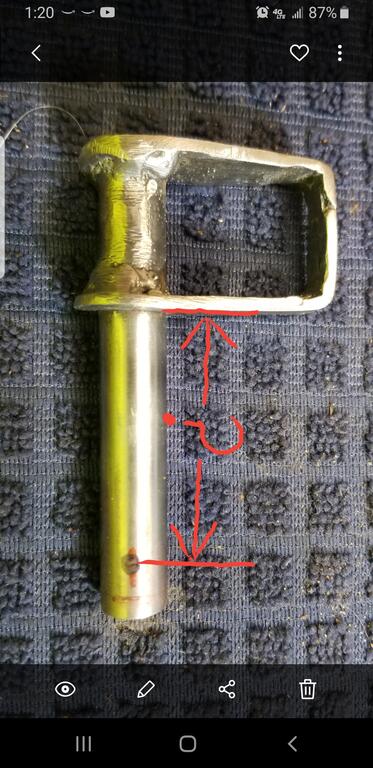

gt14rider 1,278 #1 Posted July 7, 2024 Hi all, I am replacing the shaft on a parking paw and did not measure the roll pin hole (see picture). Can anyone help me out. Thanks Share this post Link to post Share on other sites

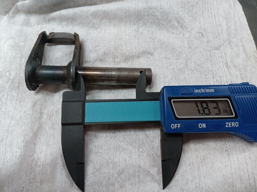

ebinmaine 80,278 #2 Posted July 7, 2024 Measurement is from the edge of the hole furthest from the hoop. Hole diameter. 1/8 1 Share this post Link to post Share on other sites
gt14rider 1,278 #3 Posted July 7, 2024 Thank you, have a great rest of the weekend. One step forward and two back. 1 Share this post Link to post Share on other sites

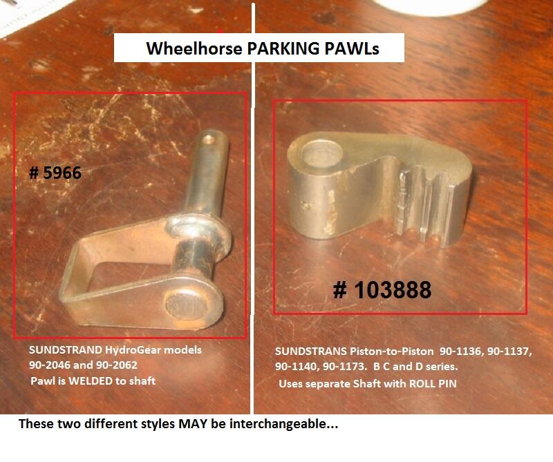

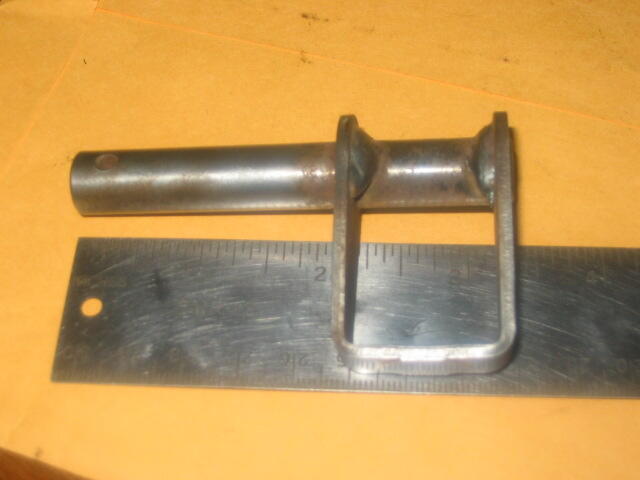

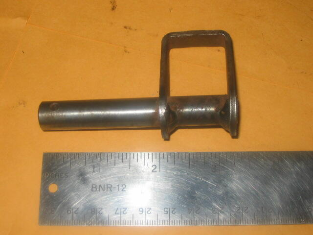

daveoman1966 3,884 #4 Posted July 7, 2024 Looked at all my pics but don't have the exact spacing for the PARKING PAWL (not paw) that you ask for. However, here are a couple pics that may help with the hole location: Maybe you can buy new....it is OEM # 5966 for the welded style PARLKING PAWL like yours. 3 1 Share this post Link to post Share on other sites
