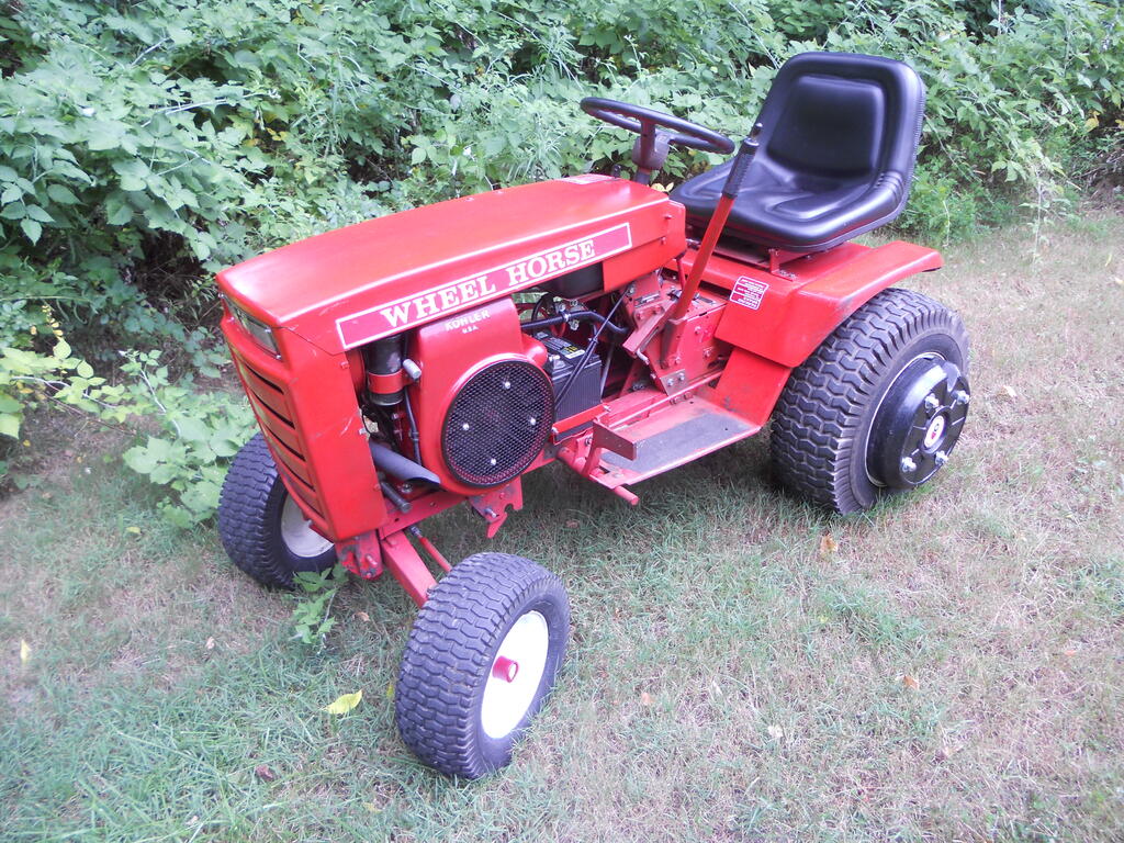

Racinbob 13,193 #6 Posted July 6, 2024 11 hours ago, mike avad said: I have a 1976 wheelhorse B-80 with a 8hp Kohler engine, Will a 12HP engine off a 1970 Raider12 fit my B-80 wheel horse? Here's my 1976 B-80 with a K-341 16hp. It's a simple swap as the 76 and 77 B's were basically the same as the C's. As far as the PTO goes you'll need to swap the bearing race for the 1.125" shaft. The spring is different but will work fine. The engine bracket is different but easily modified. Other than that it will fit seamlessly. The frame, transmission, sheetmetal, etc. are identical. All the K-Series Kohler big blocks hang over on the right side making a lot of folks think it's too big but actually it's normal. On the Wheel Horse spec oil pan there's two threaded holes where a bolt runs into from under the frame. I think most of them have the holes. The 341 I used was purchased from WW Grainger new and it had them. I've heard some people use J bolts instead but I've never seen that. 3 Share this post Link to post Share on other sites
