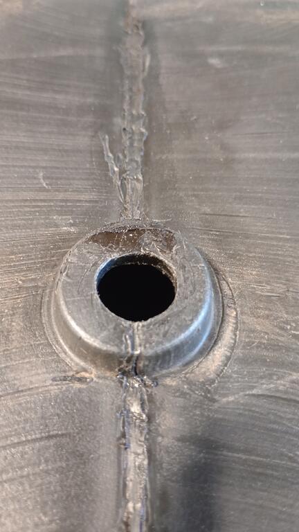

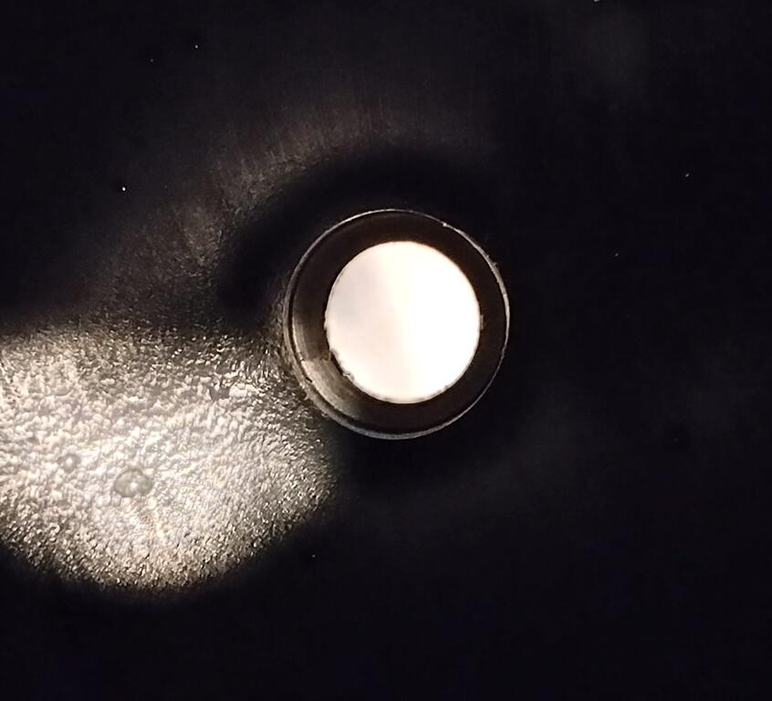

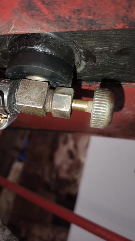

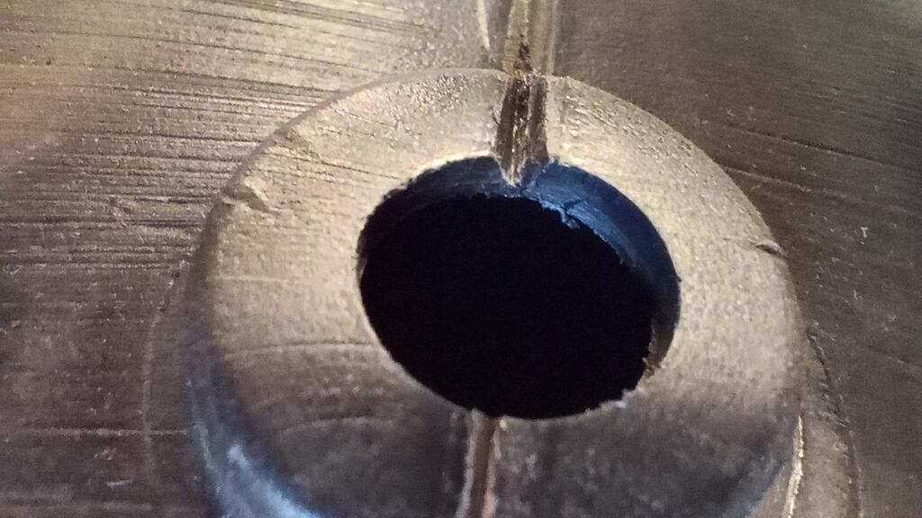

AlexR 3,083 #1 Posted July 3, 2024 (edited) Here is a repair I did to my plastic gas tank on my B100 so this is mainly for the gas tanks in the 73-77 B and C series I believe those are the ones with the gas tank over the battery and the bushing and shutoff on the bottom of the tank. (Edit to add) BEFORE working on the tank throughly wash out the tank, I used soap and water and filled the tank to overflowing several times to make sure any and all fumes are pushed out of the tank. You can kinda of see the crack right on the edge of the hole where the light is. The first thing I did was use a utility knife and cut a V on the bottom of the tank where the crack is. Then you will need a black ziptie and what I used was a soldering iron. If you have a plastic welding iron that might work too if it has a fine enough tip. What I did first before even adding plastic was get the tip of the iron in the bottom of the V to melt together the crack Then you can start adding plastic using the black ziptie keep the iron in the crack being careful but keeping all the plastic melted so it can properly meld together. Eventually you will get something like this what I did have to do is roll the round part of the iron in the hole to smooth it out. Be very careful doing this not to enlarge the hole. I used some petroleum jelly reinstalling the bushing and have had no leaks after several days. You will need to check it for several days to make sure it's not leaking as well. Edited July 3, 2024 by AlexR 3 12 Share this post Link to post Share on other sites

ranger 1,860 #9 Posted July 4, 2024 17 hours ago, AlexR said: That seems like it would be much tougher to try to plastic weld a broken nipple back on. Now that will probably happen to me when I pull that fuel hose off the Raider If the nipple broke off, you could maybe fit a metal nipple that is held with a nut and sealing washers, or perhaps one of the high pressure tubeless tire valves that fit the same way? Then attach an inline fuel tap? 3 Share this post Link to post Share on other sites
mflowers 86 #10 Posted July 15, 2024 Nice work! Where did you find that bushing? 3 Share this post Link to post Share on other sites
AlexR 3,083 #11 Posted July 15, 2024 6 hours ago, mflowers said: Nice work! Where did you find that bushing? You can find them a lot of places I believe I have seen someone say napa has them if you want it locally, you can find them online and Amazon has them as well (which is where I got mine) Share this post Link to post Share on other sites
ebinmaine 80,279 #12 Posted July 15, 2024 6 hours ago, mflowers said: Nice work! Where did you find that bushing? 3 minutes ago, AlexR said: You can find them a lot of places I believe I have seen someone say napa has them if you want it locally, you can find them online and Amazon has them as well (which is where I got mine) After having several of the cheap imported valves and bushings fail I've started ordering from a company called Aircraft Spruce. Just yesterday evening I discovered another failure. I put a new twist type valve and new bushing in a project tractor two years ago or less and it's completely frozen in place now. Valve won't move one way or the other. The bushings are softer and far much a lot a bunch easier to use. The valves they sell are a 90° lever instead of the old style twist knob. 2 Share this post Link to post Share on other sites
AlexR 3,083 #13 Posted July 15, 2024 57 minutes ago, ebinmaine said: After having several of the cheap imported valves and bushings fail I've started ordering from a company called Aircraft Spruce. Just yesterday evening I discovered another failure. I put a new twist type valve and new bushing in a project tractor two years ago or less and it's completely frozen in place now. Valve won't move one way or the other. The bushings are softer and far much a lot a bunch easier to use. The valves they sell are a 90° lever instead of the old style twist knob. Yeah I ended up just using the bushing and just reusing the old valve switching out some of the seals from the newer valve. So definitely agree the quality is not as good. The bushing seems to be good so far. 1 Share this post Link to post Share on other sites
Racinbob 13,111 #14 Posted July 15, 2024 Those bushings (bungs) are readily available. Usually purchased with a new valve. They do tend to seep after a while and I always replace the valve when I put a new one in. Some of the valves have the screen attached and I don't use those. I just replaced them on the 314 and the 2005 due to minor seeping. In a pinch if you don't have a bung and valve handy you can wiggle and slightly twist them to get it to stop until you get a replacement. 1 hour ago, ebinmaine said: After having several of the cheap imported valves and bushings fail I've started ordering from a company called Aircraft Spruce. Just yesterday evening I discovered another failure. I put a new twist type valve and new bushing in a project tractor two years ago or less and it's completely frozen in place now. Valve won't move one way or the other. The bushings are softer and far much a lot a bunch easier to use. The valves they sell are a 90° lever instead of the old style twist knob. I just looked at those Eric. I like a lot and they are reasonably priced. I'm going to order a couple. As far as the tank over the battery models most all of them, with a few exceptions, had that until they moved the tank under the seat in 78. There were variations such as the nipple molded as part of the tank which I think were older models and, of course, metal tanks. As far as red or black there doesn't seem to be any rhyme or reason. I'm thinking it was simply what the supplier gave them in that batch. 2 Share this post Link to post Share on other sites
