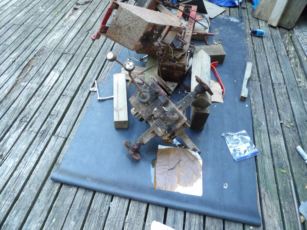

Kelsey 91 #1 Posted July 2, 2024 Just joking on that title. Our 1974 C-100 has been slowly torn down for the eventual rebuilding. I don't want to add a lot of photos but here's the photo that fits the title: 1 3 Share this post Link to post Share on other sites

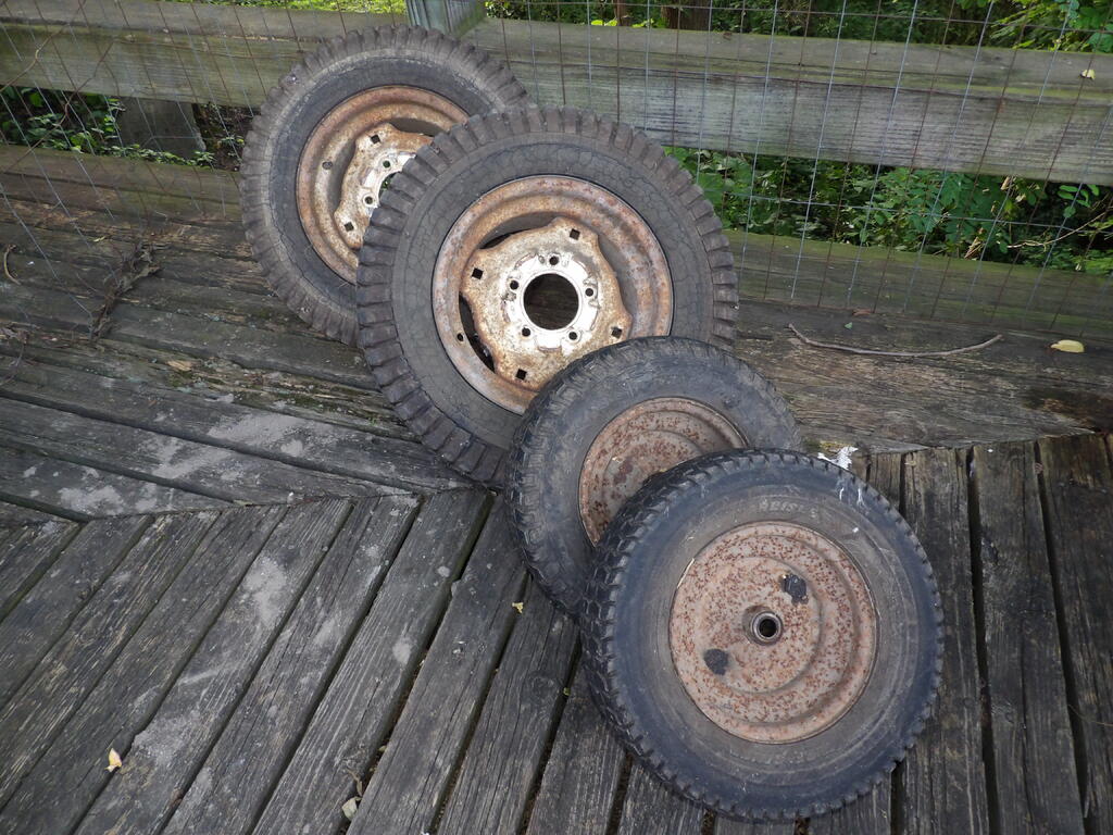

Kelsey 91 #11 Posted July 2, 2024 The plan is to have the rims powder coated and add new tires to them. The imperfections in the wheels may show up after the p-coating but that's all right. This tractor has been very good to me. We purchased it used back in '86. 2 Share this post Link to post Share on other sites

ri702bill 12,114 #14 Posted July 2, 2024 2 minutes ago, Kelsey said: The imperfections in the wheels may show up after the p-coating Thems not imperfections, those are the scars of years of "Character Building".... each tells a story... if you just listen... (Got me this here one puttin' a hurtin' on a green & yeller John Deere in a pulloff back in '97...) 2 Share this post Link to post Share on other sites

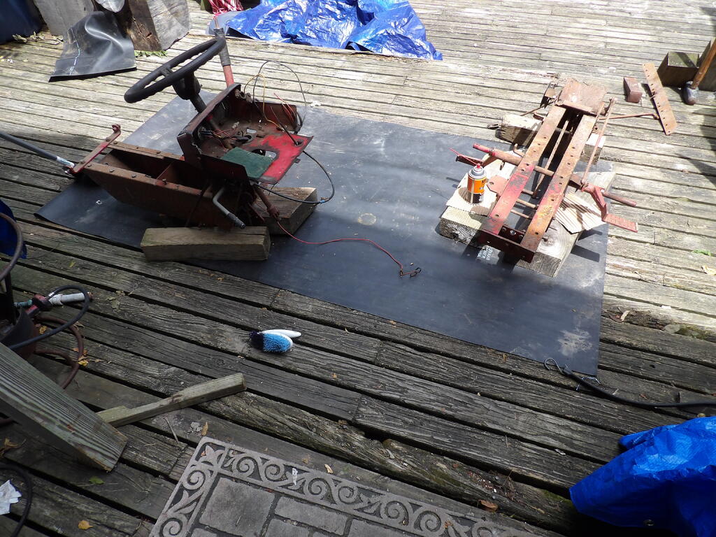

peter lena 9,886 #20 Posted July 3, 2024 @Kelsey , just a thought / opportunity , looking at your first photo , bare frame , possibly think of adding , after cleaning , a steel brake line , 5/16 I/D , to inner bend of frame , for a fuel line , lots of areas to secure to frame , keeps it tight and secure . would just cap it off , leaving just a foot of hose , to connect to tank / carb , you could swage lok it , or hose clamp . another great spot is the , start of the PTO LEVER , very sloppy fit , also a 2 bolt flange bearing for the steering column . having corrected those areas , you are right there . a functional break down , is your best time to eliminate a chronic problem , improve on initial set up , they can actually move / function with ease , pete Share this post Link to post Share on other sites

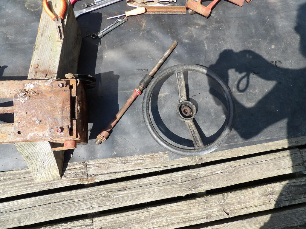

Kelsey 91 #23 Posted July 4, 2024 Just now, Kelsey said: 1) The plate on the frame has 2 bolts with possible shims (?) The shims were all rusted. Also, the plate was bent up from removing the transmission. What does the plate do? 2) The steering wheel came apart with ease because I used never size compound on the pin. I sopped it in/outside of the pin. Also, I broke the steering wheel because I'd pull on it to get off the tractor. F.A that I am. Changed the st.wheel out 10-12 years ago. 1 Share this post Link to post Share on other sites
