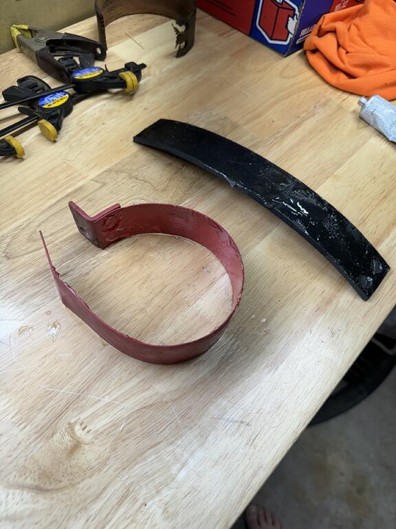

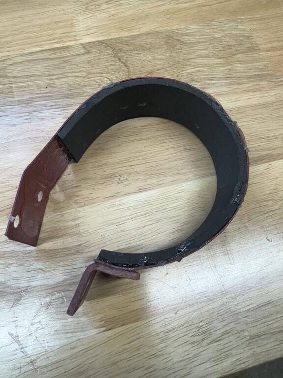

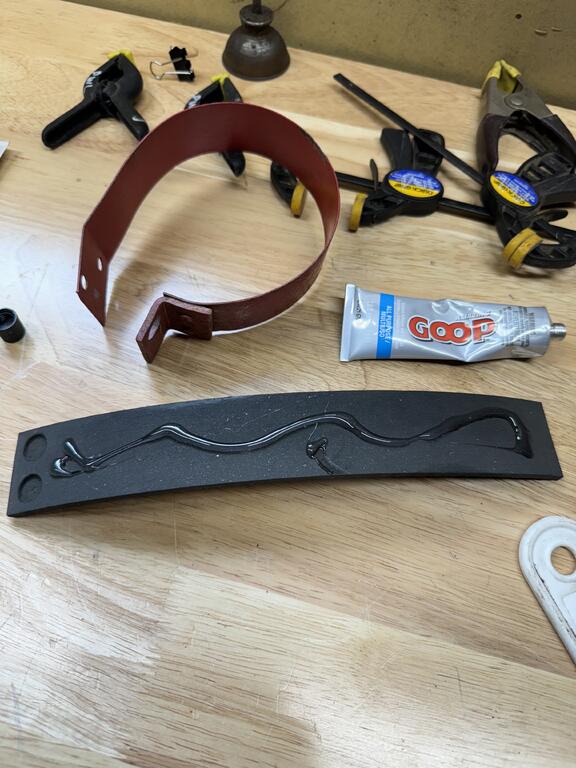

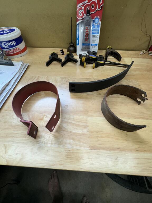

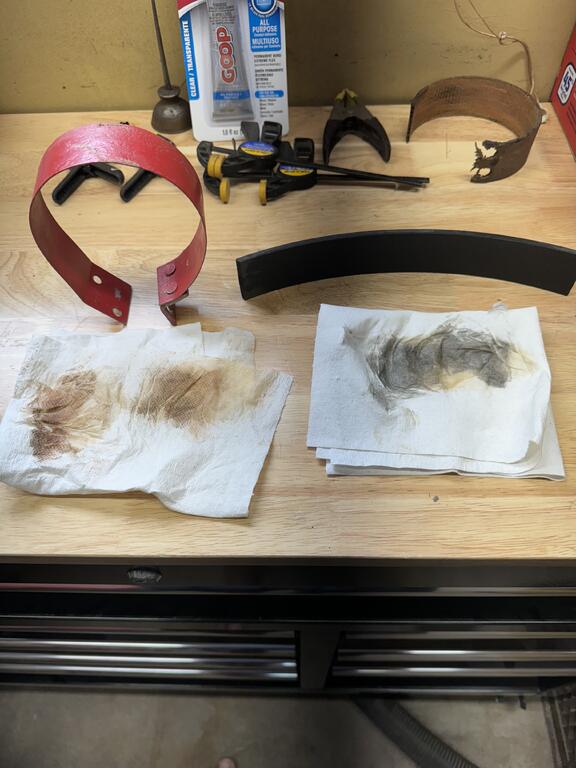

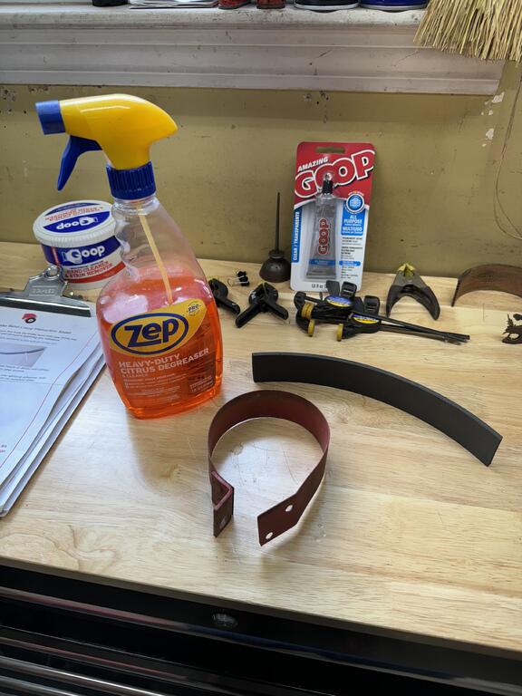

PWL216 1,310 #1 Posted June 30, 2024 (edited) Bought a couple of brake linings from @Maynard at the BS. Below are pics of one I installed today. As an adhesive, I used Goop All-Purpose adhesive - $6 for 1oz tube, I used half a tube. 1. Laid out the parts (You can see the old damaged lining) 2. Cleaned the new brake lining and inside of the brake band with Zep 3. Squeezed the Goop onto the brake lining (the side with two rivet reset dimples) 4. Spread the Goop with a plastic putty knife 5. Put the new break pad in the brake band and clamped it. 6. Now we wait, 24ish hours 7. Then reinstall Thx again to @Maynard for these high quality linings. Edited July 1, 2024 by PWL216 Added more pics 6 2 Share this post Link to post Share on other sites

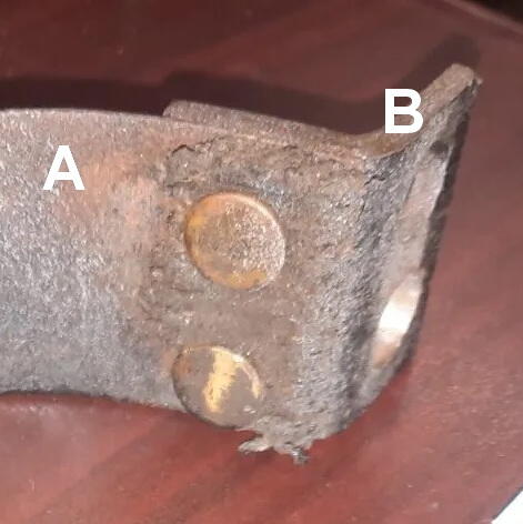

sqrlgtr 4,225 #4 Posted June 30, 2024 Quick question do y'all try and rivet the brake lining also or does goop hold it good enough. Thanks in advance. 1 Share this post Link to post Share on other sites

rmaynard 17,659 #8 Posted July 1, 2024 17 hours ago, sqrlgtr said: Quick question do y'all try and rivet the brake lining also or does goop hold it good enough. Thanks in advance. Brake linings were never riveted on, only bonded with cement. The only rivets in a brake band are those that hold the band (A) to the angle bracket (B) 1 1 Share this post Link to post Share on other sites

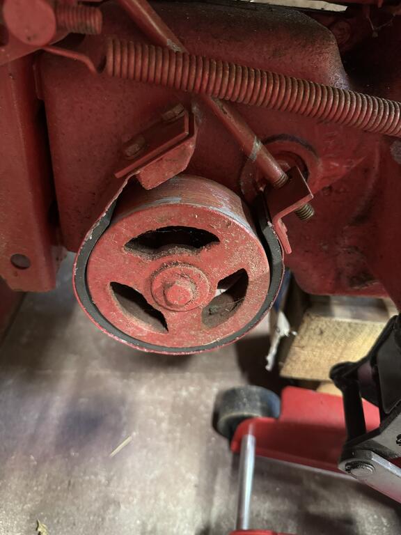

953 nut 70,658 #9 Posted July 1, 2024 20 hours ago, PWL216 said: Put the new break pad in the brake band and clamped it. The clamping method I have used is as follows; Glue, install the brake band on the tractor, set the parking brake, let it set-up overnight. This method ensures the brake shoe and band are in proper alignment for actual use. 5 4 Share this post Link to post Share on other sites
