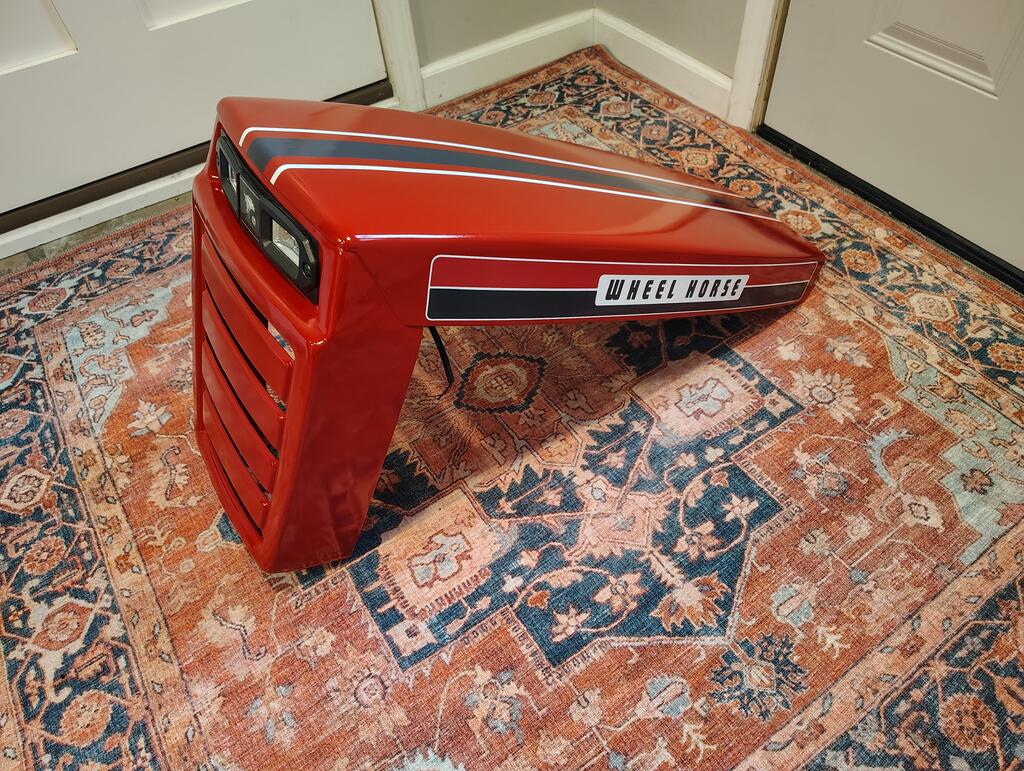

SylvanLakeWH 32,920 #276 Posted February 20 Looks great! We literally have the same rug in our foyer... Mrs Sylvan gave me the look when I showed her that you get to put Wheel Horse parts on it... 8 Share this post Link to post Share on other sites
AlexR 3,139 #277 Posted February 20 5 minutes ago, SylvanLakeWH said: Looks great! We literally have the same rug in our foyer... Mrs Sylvan gave me the look when I showed her that you get to put Wheel Horse parts on it... Thanks! Haha well my wife asked me what I was doing as well.. had to take it down to the basement after that haha. 6 Share this post Link to post Share on other sites
WHX?? 58,388 #278 Posted February 21 I'll tell ya I ain't much for the way some guys replace the headlight buckets but yours looks cool. Kinda mean lookin and the like the originals ... 3 1 Share this post Link to post Share on other sites

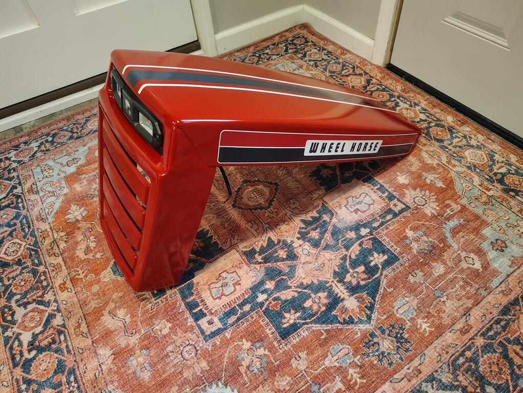

AlexR 3,139 #279 Posted February 21 Polished the hood and added decals thanks to redoyourhorse very very nice decals! 1 10 Share this post Link to post Share on other sites
AlexR 3,139 #280 Posted February 22 23 hours ago, WHX?? said: I'll tell ya I ain't much for the way some guys replace the headlight buckets but yours looks cool. Kinda mean lookin and the like the originals ... I agree, no offense to people that have done different things to the headlights of the 60's/70's tractors but most of them just don't look good. The lense was too far gone, cracked and missing corners. And I didn't want to throw away a chrome horse lense, so it's the idea I came up with to incorporate that into a modern light. 4 Share this post Link to post Share on other sites
WHX?? 58,388 #281 Posted February 22 (edited) 14 minutes ago, AlexR said: , cracked and missing corners. Yep I get it ... I coulda sold ya a nice orginal ... way less than Pullstart price too... Hopefully you get this tractor at plow day I'd like to see it. Yes you best get that off Sylvia's rug ... someone opens a door on it! Edited February 22 by WHX?? 1 4 Share this post Link to post Share on other sites
AlexR 3,139 #282 Posted February 22 11 minutes ago, WHX?? said: Yep I get it ... I coulda sold ya a nice orginal ... way less than Pullstart price too... Hopefully you get this tractor at plow day I'd like to see it. Yes you best get that off Sylvia's rug ... someone opens a door on it! Well now it's in the custom category because of the headlight, and couple fingerprints in the paint I will do everything I can to get this tractor to plow day and plow with it. No worries its back in the basement 3 Share this post Link to post Share on other sites
WHX?? 58,388 #283 Posted February 22 33 minutes ago, AlexR said: couple fingerprints in the paint Well we can track it then ... maybe some dna too? ... 3 Share this post Link to post Share on other sites

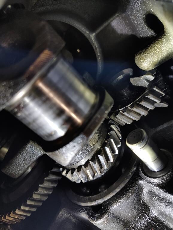

AlexR 3,139 #284 Posted February 28 Got the bore of the engine checked with the cylinder still in its out of round .003 and over the max wear limit by .003 and tapered about .002 which is the limit as well. The balancer gear bearings are definitely bad as well I was able to visibly see and feel wobble. Still gotta check the crank if it's good I can use the other block I have which is just in spec and use this crank. If not I will run this engine as is minus the balancer gears. Don't have time to get anything machined before plow day. 2 Share this post Link to post Share on other sites
ebinmaine 81,281 #285 Posted March 1 15 hours ago, AlexR said: The balancer gear bearings are definitely bad as well I was able to visibly see and feel wobble If your gonna reinstall those gears get new bearings AND shafts AND gears. All 3 things wear out and it causes exponential issues. 1 Share this post Link to post Share on other sites
AlexR 3,139 #286 Posted March 1 3 hours ago, ebinmaine said: If your gonna reinstall those gears get new bearings AND shafts AND gears. All 3 things wear out and it causes exponential issues. I will not be reinstalling them. Just noticed that they were loose so it was a ticking time bomb 2 Share this post Link to post Share on other sites
ebinmaine 81,281 #287 Posted March 1 8 minutes ago, AlexR said: I will not be reinstalling them. I was hoping you'd say that. I'll be removing the balance gears from every engine I can here. 1 1 Share this post Link to post Share on other sites
kpinnc 19,107 #288 Posted March 2 11 hours ago, AlexR said: I will not be reinstalling them. On a 12hp you won't notice much of a difference. 14 and 16hp have a little more thump when the gears are removed (longer throw on the crank and bigger piston) but it isn't terrible in most cases. My Bronco 14 has no balance gears and I don't think it's bad at all. 4 Share this post Link to post Share on other sites

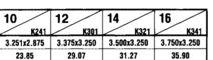

AlexR 3,139 #289 Posted March 2 I thought the K301, K321, and K341 have the same stoke length of 3.25"? Share this post Link to post Share on other sites
kpinnc 19,107 #290 Posted March 2 4 hours ago, AlexR said: I thought the K301, K321, and K341 have the same stoke length of 3.25"? K321 and K341 are the same. K301 is different. Only the 14 and 16 are interchangeable. 2 Share this post Link to post Share on other sites
702854boy 1,245 #291 Posted March 2 46 minutes ago, kpinnc said: K321 and K341 are the same. K301 is different. Only the 14 and 16 are interchangeable. Isn't the crank and rod on the 12 and 14 the same, just the bore size is different? I thought the 12 and 14 were sorta interchangeable and the 16 was the odd duck. Share this post Link to post Share on other sites
kpinnc 19,107 #292 Posted March 2 11 minutes ago, 702854boy said: Isn't the crank and rod on the 12 and 14 the same, just the bore size is different? I thought the 12 and 14 were sorta interchangeable and the 16 was the odd duck. I may be wrong, but I thought the 14 and 16 are the same. Share this post Link to post Share on other sites
AlexR 3,139 #293 Posted March 2 (edited) Everything I have read said 12 and 14 cranks are interchangeable Obviously the 16 head and block are different and I haven't heard about being able to interchange those cranks. Edited March 2 by AlexR 2 Share this post Link to post Share on other sites
kpinnc 19,107 #294 Posted March 2 2 hours ago, AlexR said: Obviously the 16 head and block are different and I haven't heard about being able to interchange those cranks. Stroke may be the same but I've always understood the 14 and 16 couterweights are larger to compensate for the larger piston. It's been a while since I built an old Kohler. Just going from my not so good memory. 1 1 Share this post Link to post Share on other sites
AlexR 3,139 #295 Posted March 3 4 hours ago, kpinnc said: Stroke may be the same but I've always understood the 14 and 16 couterweights are larger to compensate for the larger piston. It's been a while since I built an old Kohler. Just going from my not so good memory. You are correct this is from gardentractorpullingtips "The same crankshaft can be used with the K321, K341 and K361 piston assembly. If both counterweights on your crankshaft aren't machined off flat, then it's a 14 or K341 crank. If they are machined off, then it's a K301 crankshaft. And a K301 crank shouldn't be used with a K321 or K341/K361 piston assembly." I think I was the one that was confused haha. 1 1 Share this post Link to post Share on other sites
kpinnc 19,107 #296 Posted March 3 3 hours ago, AlexR said: I think I was the one that was confused haha. Ya know I looked for that several times this morning between calls at work, and could not find it. 1 1 Share this post Link to post Share on other sites
AlexR 3,139 #297 Posted March 6 I can't remove the upper balancer gear without pulling the crank at least not in this block. With the crank out of the way I have a nub in the block in the way if I rotate it enough to possibly clear that the crank is in the way and I even rotated the engine several times just to see if there is any position it can come out. But it's fine I was going to replace seals anyway and it's going to be easier to replace seals with the crank out. 3 Share this post Link to post Share on other sites
Achto 32,963 #298 Posted March 6 I was able to get them out of the 14hp that is in my pulling tractor without pulling the crank. Had to have it positioned just right. 4 2 Share this post Link to post Share on other sites
ebinmaine 81,281 #299 Posted March 7 3 hours ago, AlexR said: can't remove the upper balancer gear On the two I've done I drove the gear's shaft right in to the block. 3 Share this post Link to post Share on other sites
oliver2-44 11,847 #300 Posted March 7 I just take a sharp cold chisel and give the a sharp rap. No need to pound, they split easily. 3 Share this post Link to post Share on other sites
