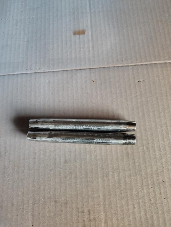

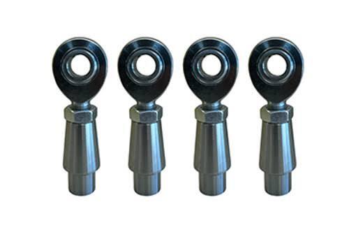

AlexR 3,112 #251 Posted December 30, 2025 I got a idea for tie rods I think you guys will like. So they have these heim joints that have left and right hand threads that weld to round pipe. So the 3/8 heim joints will weld to 3/4 inch tube. I can get the a 3' round tube for about $12 and a set of 4 joints I can get for around $30 All I got to do is cut the tube to length and weld it on. 6 Share this post Link to post Share on other sites
Handy Don 17,474 #252 Posted December 30, 2025 1 hour ago, AlexR said: idea for tie rods I've seen these on some tractors at the Big Show. Be sure to use tubing with an adequate wall thickness 1 1 Share this post Link to post Share on other sites
AlexR 3,112 #253 Posted December 31, 2025 4 hours ago, Handy Don said: I've seen these on some tractors at the Big Show. Be sure to use tubing with an adequate wall thickness That is true but the ones I am looking at are made to be used with 3/4 " 16ga wall thickness that's what fits the weldable sleeve. 2 Share this post Link to post Share on other sites
Handy Don 17,474 #254 Posted December 31, 2025 15 hours ago, AlexR said: That is true but the ones I am looking at are made to be used with 3/4 " 16ga wall thickness that's what fits the weldable sleeve. You’ll also want to confirm clearances at the center steering shaft and the spindle arms. 2 Share this post Link to post Share on other sites

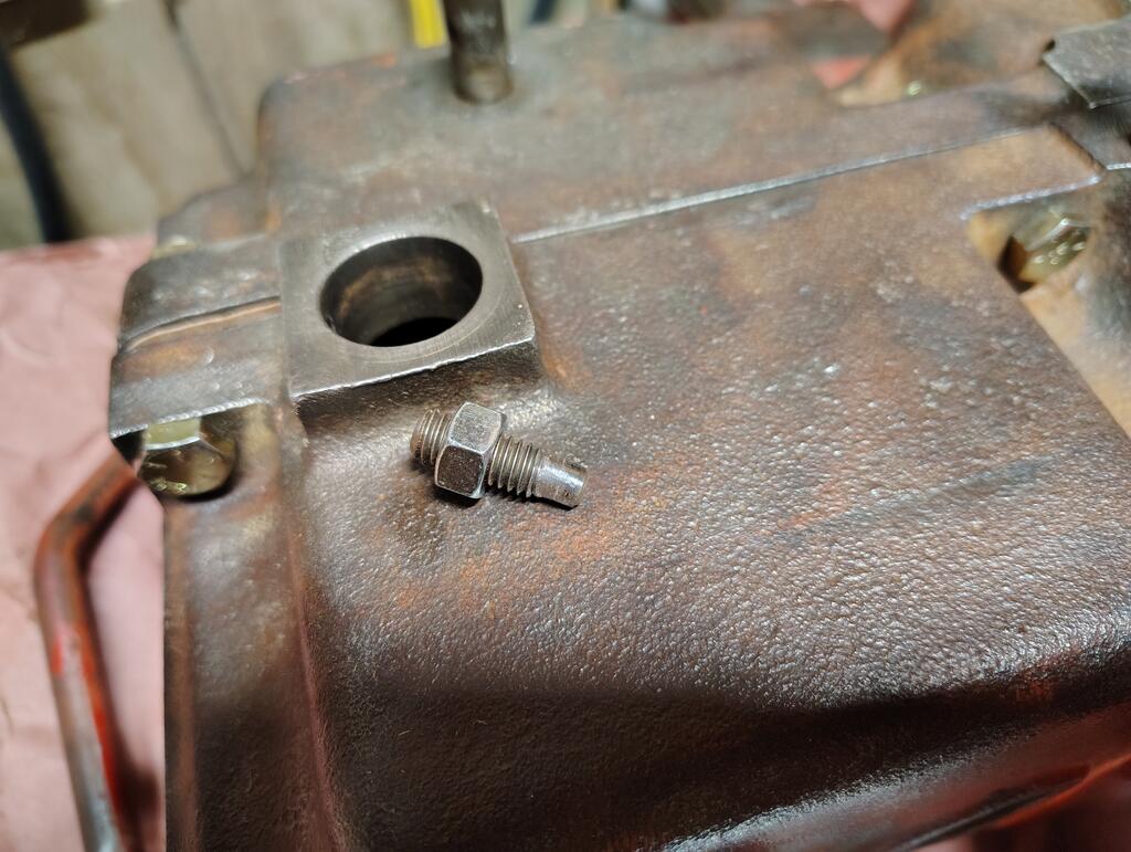

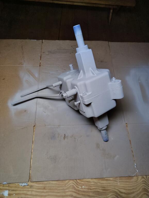

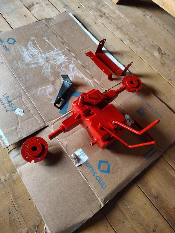

AlexR 3,112 #256 Posted January 15 Drilled out and rethreaded the gearshift setscrew And then ground down the end of a setscrew to fit in the gearshifter. So transmission is rebuilt and ready for paint once it's warm enough 1 8 Share this post Link to post Share on other sites

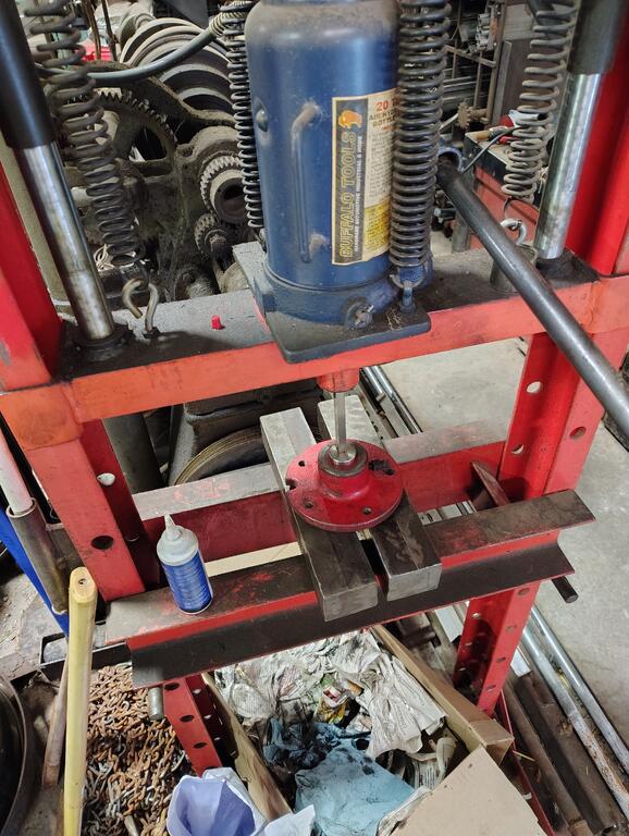

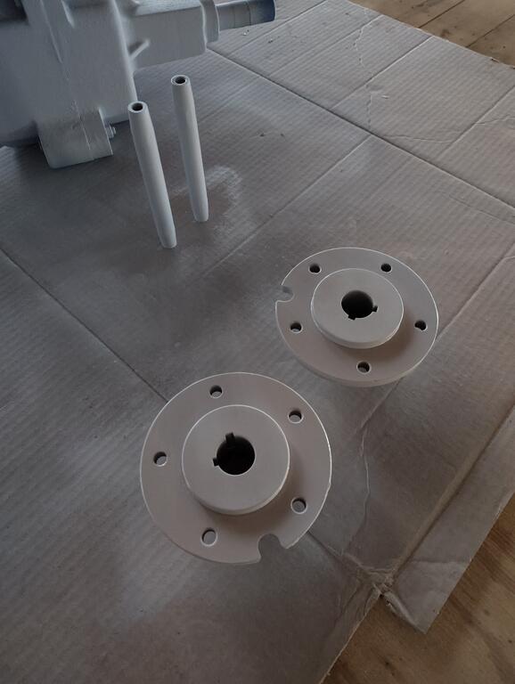

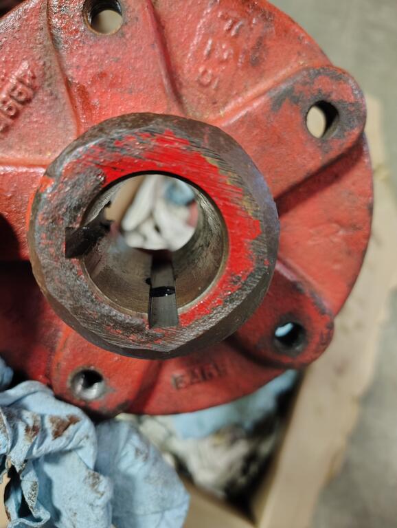

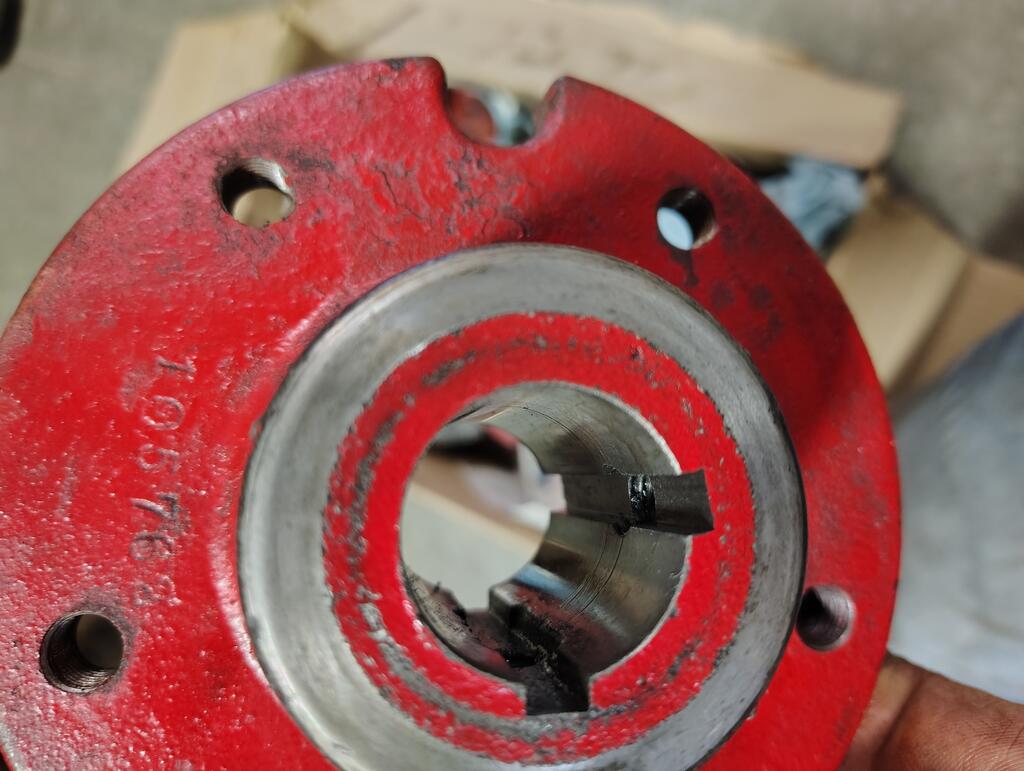

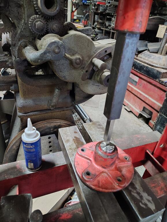

AlexR 3,112 #257 Posted January 30 Thanks to @WHX?? for letting me use the broach set. I was able to use my neighbors press to get some new keyways cut for the hubs. I have 2 sets, I will use the heavier set for this tractor. 7 Share this post Link to post Share on other sites
WHX?? 58,125 #258 Posted January 31 Kinda fun doin them ain't it? Do the other side right away and run two set screws. Heck do all your plow mules while yer at it! The full broach set was 200 and I got it with a coupon in the jungle for 100 . More it gets used the more it pays for itself. Did those spindles work? 2 1 2 Share this post Link to post Share on other sites
AlexR 3,112 #259 Posted January 31 16 minutes ago, WHX?? said: Kinda fun doin them ain't it? Do the other side right away and run two set screws. Heck do all your plow mules while yer at it! The full broach set was 200 and I got it with a coupon in the jungle for 100 . More it gets used the more it pays for itself. Did those spindles work? Yeah it's really awesome getting such a perfect cut really simply. If the air jack on the press worked right it would have been even easier, got an arm workout instead. Yep got all 4 hubs that I don't currently have on tractors done. I probably need to pull the hubs off the running tractors and do those as well. I know for sure at least one set is worn. Definitely worth it! I thought about buying a set but it's not something that gets used extremely often. Used plenty of cutting oil, so it's still good for more use Drives me nuts when people don't use oil to cut or drill metal and are shocked when the bit is dull running at full speed with the end of the bit glowing red I have not actually checked the spindles yet. I might be able to tomorrow. 2 1 Share this post Link to post Share on other sites
AlexR 3,112 #260 Posted January 31 20 hours ago, WHX?? said: Did those spindles work? Checked them out today in the axle, and they work great!! The front end on this tractor will be a lot tighter now! Thanks again. 1 1 Share this post Link to post Share on other sites
AlexR 3,112 #261 Posted February 11 Got warm enough to get some primer on the transmission, looks like enough warm weather next week to get some red sprayed. 2 5 Share this post Link to post Share on other sites
Achto 32,693 #262 Posted February 11 5 minutes ago, AlexR said: looks like enough warm weather next week to get some red sprayed. Looks good. A tip for spraying - Run a chain through the hitch pin hole, & hang it up. This allows you access to the whole thing when painting. 4 3 1 Share this post Link to post Share on other sites

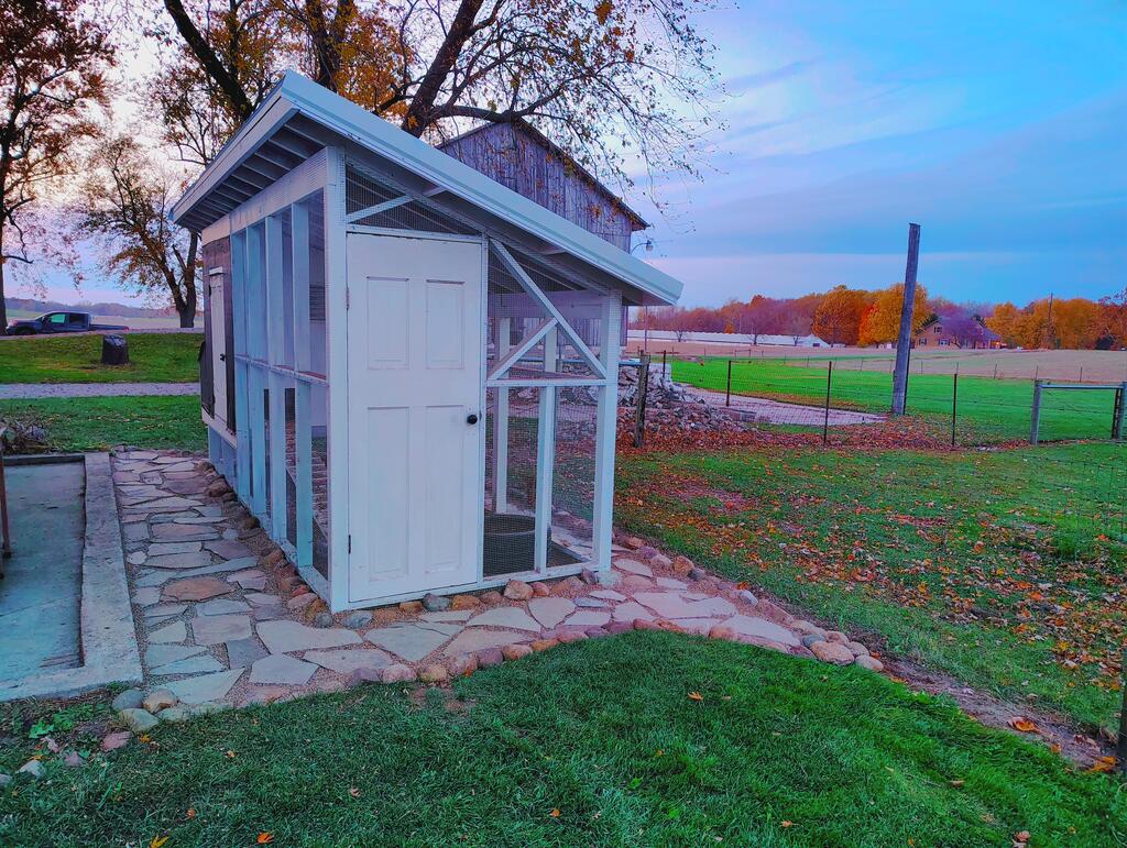

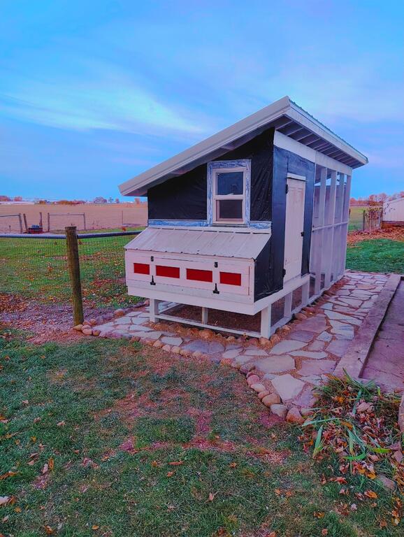

AlexR 3,112 #263 Posted February 12 Was going through this thread to reference some older pictures and realized I never posted a photo of a more finished chicken coop still have siding left to do. 3 3 1 Share this post Link to post Share on other sites
WHX?? 58,125 #264 Posted February 12 (edited) 54 minutes ago, AlexR said: chicken coop I want one... Pull start is gonna say motorize it ... Edited February 12 by WHX?? 4 Share this post Link to post Share on other sites
AlexR 3,112 #265 Posted February 12 21 minutes ago, WHX?? said: I want one... Pull start is gonna say motorize it ... This one is buried 3' in the ground, I don't think it's moving 1 4 Share this post Link to post Share on other sites
WHX?? 58,125 #266 Posted February 12 3 minutes ago, AlexR said: I don't think it's moving You obviously don't know The Pullstart. 3 Share this post Link to post Share on other sites
AlexR 3,112 #267 Posted February 12 12 minutes ago, WHX?? said: You obviously don't know The Pullstart. That is true.. he would probably make a monster truck out of it, combine wheels and tires. 4 1 Share this post Link to post Share on other sites

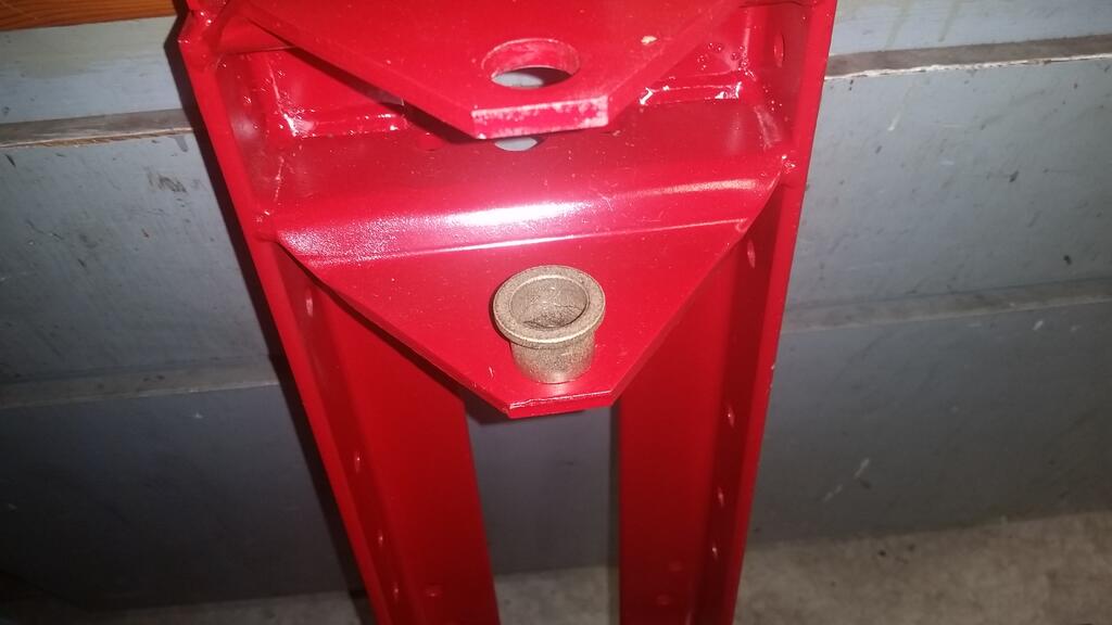

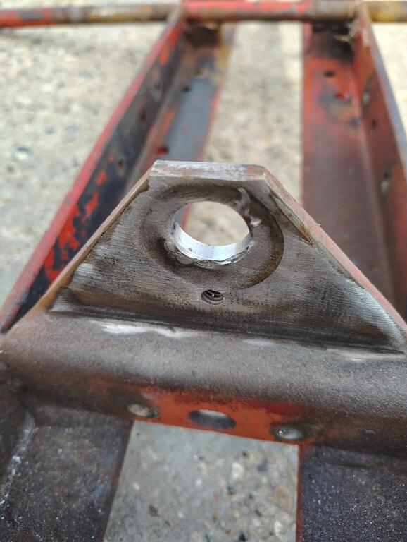

AlexR 3,112 #268 Posted February 14 Got some work done today welded and ground down on the frame for the front axle pin it was oblong. Got the tierods welded And primed those and the rear hubs. 1 5 Share this post Link to post Share on other sites

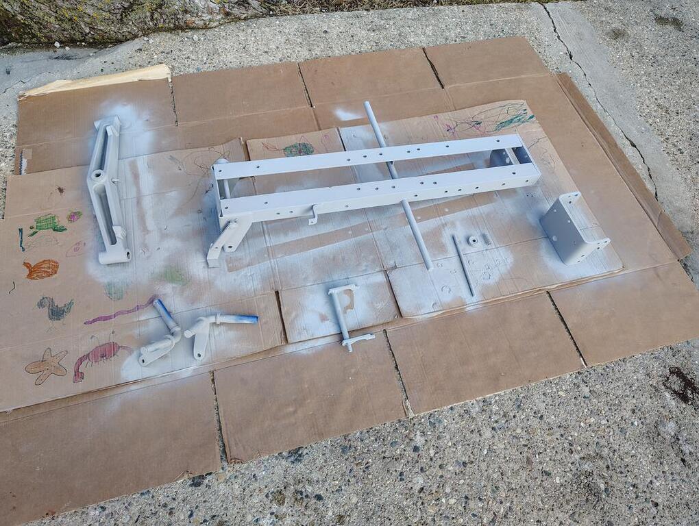

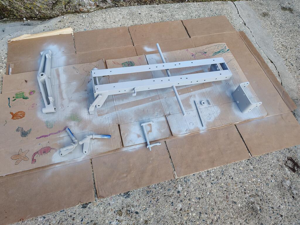

AlexR 3,112 #270 Posted February 16 (edited) Getting parts stripped of paint, wire brushed, cleaned, and primed. I should be able to get all the parts painted during this warm spell to get it to be a roller. Will try to get the rest of the bigger parts done as well, but we will see. And some concept art of the finished tractor from my oldest daughter who turned 6 today notice the finer detail of the horse on the front of the hood! Edited February 16 by AlexR 4 7 Share this post Link to post Share on other sites

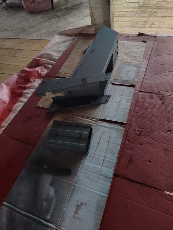

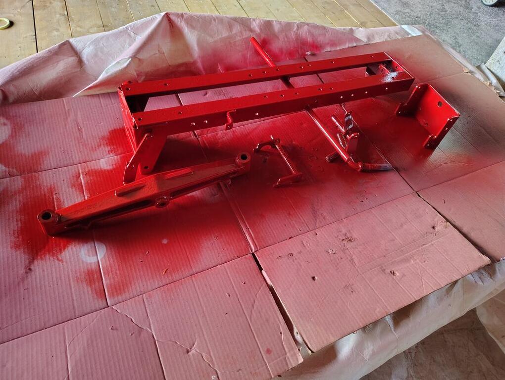

AlexR 3,112 #272 Posted February 17 More painting done. Also stripped and primed the rear wheels for painting tomorrow. And finished parts 8 Share this post Link to post Share on other sites
Lee1977 7,772 #273 Posted February 20 On 1/31/2026 at 4:04 PM, AlexR said: Checked them out today in the axle, and they work great!! The front end on this tractor will be a lot tighter now! Thanks again. Building your tie rods with heims joint is better then any you can buy. I have heims joints on on 5 of my Wheel Horses. I put the first set I built on my C120 in 1989 they are still as tight as when I built them. 4 Share this post Link to post Share on other sites

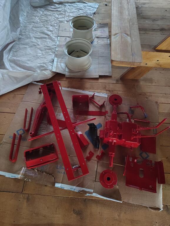

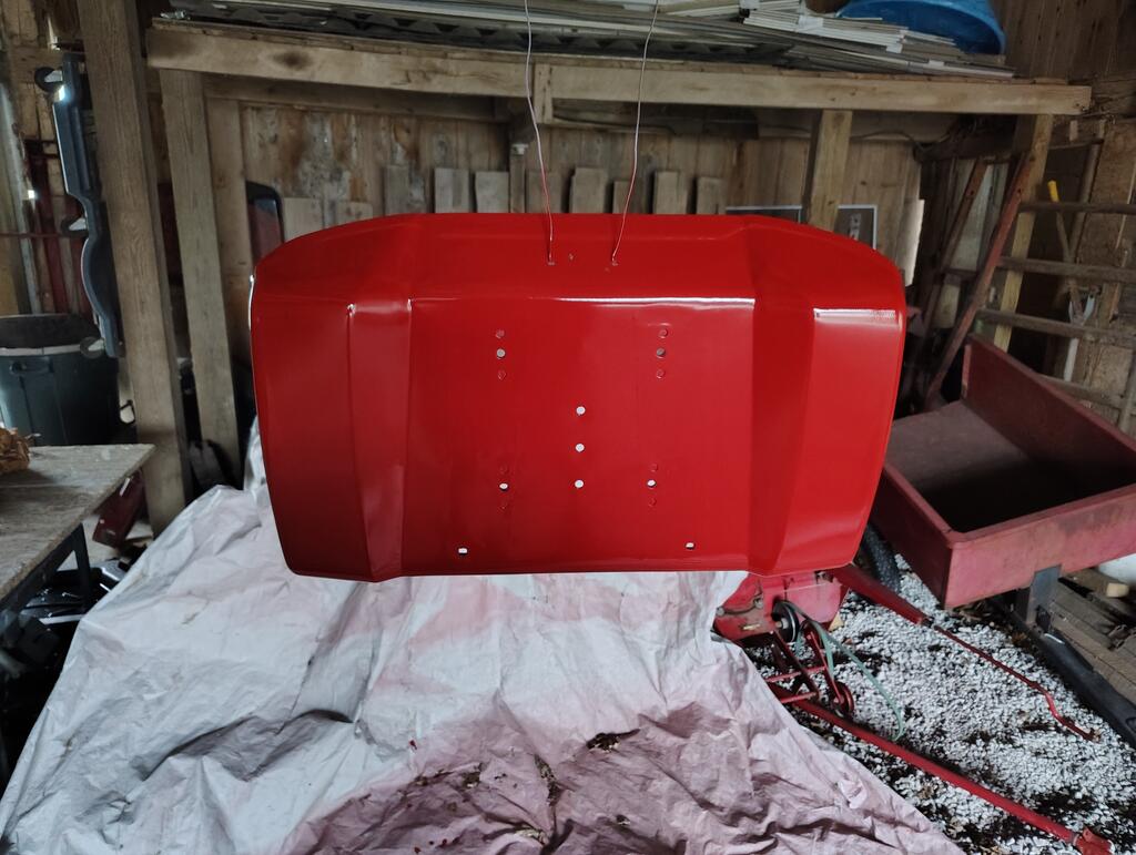

AlexR 3,112 #274 Posted February 20 This is as far as I got with painting during the warm weather. Going to let it cure for a while before doing anything with it. 5 3 Share this post Link to post Share on other sites

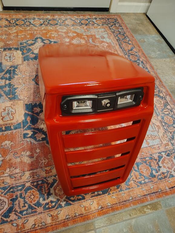

AlexR 3,112 #275 Posted February 20 Should have decals going on the hood tomorrow, brought it inside to warm up. 1 6 Share this post Link to post Share on other sites
