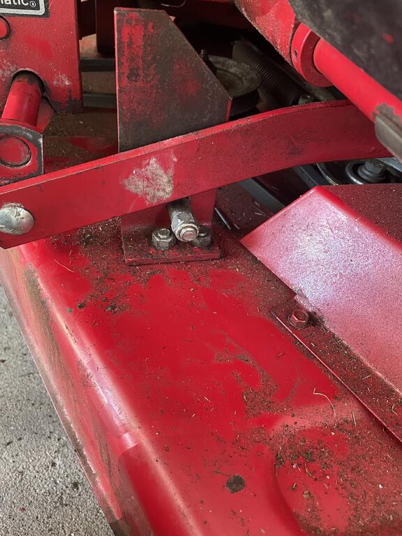

tallen4392 71 #1 Posted June 27, 2024 Does anyone have a clue what this nut and bolt are for does not go to anything ?? Share this post Link to post Share on other sites
lynnmor 9,051 #2 Posted June 28, 2024 They are called transport level stops, it is right there in your owners manual. 1 Share this post Link to post Share on other sites
peter lena 10,088 #3 Posted June 28, 2024 @tallen4392 those R/D decks , as well as others , really benefit from son sun time , break the grunge cycle , clean , oil soak dow , hot sun , also finish season with decks oil soaked , propped up to wall beams , screw eyes , extension spring hold up , detailed go over , for anything , lucas H/D green grease in avery related bearing , no whyining bearing noise , small fine file blade touch up . once you do this , you are a convert , pete Share this post Link to post Share on other sites
Brockport Bill 2,481 #4 Posted June 28, 2024 it regulates the verticle travel distance up and down of the lift assembly carriage -- it would also be obvious if you had the deck off the tractor and grabbed the front horizontal cross bar and lifted it up and down you would see the bolt/nut stop of how the deck floats -- you will note that bolt has a height adjustment in the slot to maximize or minimize the up/down travel -- one of the reason the WH decks give such a nice cut is because it floats -- many other mower decks from other companies are not designed to float the same way and therefore do not cut as evenly on your lawn 1 Share this post Link to post Share on other sites
tallen4392 71 #5 Posted June 28, 2024 Thanks for that great explanation appreciate it .. have a good day 1 Share this post Link to post Share on other sites
