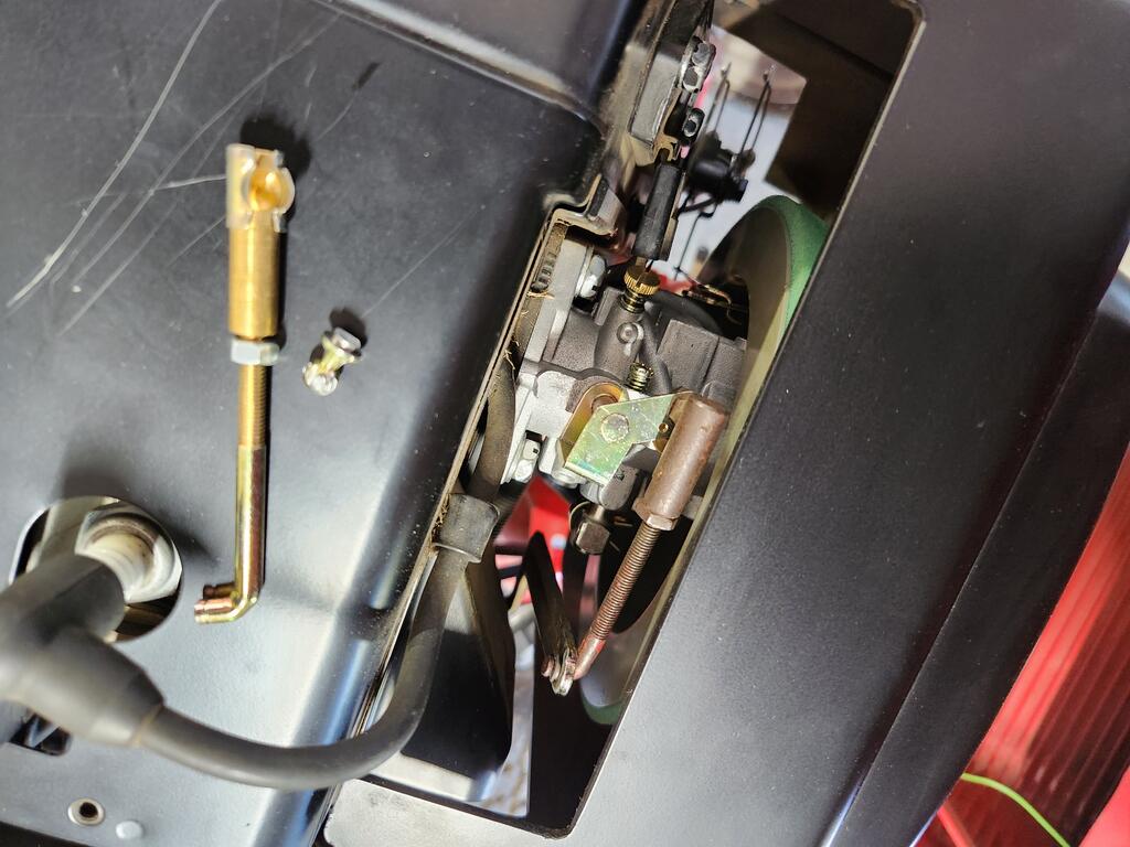

Racinbob 13,290 #57 Posted August 14, 2024 When I ordered the IST carb I didn't order a new linkage because I knew I had one. When the carb got here I looked at the linkage I had and it was the style I wanted to use but the arm doesn't snap over the ball. At that point I didn't want to grind the ball off the new carb arm so I went ahead and ordered a new linkage from IST. I had waited this long so what's another week? When it got here and I went to install it I realized that it was pretty typical China stuff. I didn't like the way it held on. So I did what I should have done in the first place. It didn't take much to grind the ball off and get my linkage installed and it was time to try again. A couple of minor adjustments and check the max RPM and she's running perfect! That spring thingy on the new linkage doesn't seem like it would hold. It bends way to easily. Also that groove on the opposite end is much shallower than my old one and the E clip doesn't hold well. 1 Share this post Link to post Share on other sites

Racinbob 13,290 #60 Posted August 14, 2024 All fixed Bill. You can see the ball stud on top of the engine along with the Chinese link. The 'old' style linkage I had was the type with the ball stud embedded into the linkage end. Then the threaded stud connects to the carb. I should have done it this way right off the get go instead of ordering a new link 2 Share this post Link to post Share on other sites
