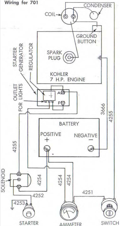

Tucker 701 1 #1 Posted June 25, 2024 I need help I have no clue what I am doing. I have the right wire and a diagram of they it all gose but I am running a different kind of starting with only a key and I dont know where to route the wires so they don't melt.if you have pics of one done please send them to me. Share this post Link to post Share on other sites
953 nut 69,406 #2 Posted June 26, 2024 54 minutes ago, Tucker 701 said: I am running a different kind of starting with only a key A little more information on the switch you are using and type of starter would be helpful. The only wire on a 701 that runs to the front of the engine is the wire to the coil. You can run it with your fuel line under the flywheel cover where it will be out of danger. 1 Share this post Link to post Share on other sites
rmaynard 17,582 #3 Posted June 26, 2024 No solenoid? Share this post Link to post Share on other sites
Achto 32,765 #4 Posted June 26, 2024 One note - you will not be able to use the original 701 starter solenoid. The factory solenoid uses a negative signal to power the magnetic switch. You will need to replace it with a newer solenoid that uses positive power to power up the magnetic switch. 4 Share this post Link to post Share on other sites
Pullstart 71,259 #5 Posted June 26, 2024 There are two ways to handle this successfully. If you are sure you don’t know what you’re doing, I’d suggest keeping to the original wiring diagram and not changing switch styles. 2 Share this post Link to post Share on other sites

rmaynard 17,582 #9 Posted June 26, 2024 If you are using just a high amperage switch, it will have to be wired with 6 gauge wire. You won't have to worry about that melting. Share this post Link to post Share on other sites
953 nut 69,406 #10 Posted June 27, 2024 6 hours ago, Tucker 701 said: Ok I kind of wanted to just keep a key switch since it was wired you like that back in the day but got torn apart The key switch that came on your 701 just turns the power to the ignition coil on and off. That will work fine as is. On 6/25/2024 at 7:29 PM, Tucker 701 said: I am running a different kind of starting with only a key Are you going to use a newer engine that has a starter rather than a starter/generator or are you just using a modern type solenoid? Share this post Link to post Share on other sites

Tucker 701 1 #12 Posted June 27, 2024 What I meant my melting is like there has to be a wire connection to the ignition coil and I was wondering where to run it so it don't melt. Share this post Link to post Share on other sites
rmaynard 17,582 #13 Posted June 27, 2024 You can run it anywhere that it doesn't directly touch the exhaust pipe or muffler. Most 14 or 16 gauge automotive wires are good to about 300 f. degrees. 1 Share this post Link to post Share on other sites

953 nut 69,406 #16 Posted June 27, 2024 I would run the fuel hose and the ignition coil wire below the fan shroud on your engine keeping them both out of harms way. Share this post Link to post Share on other sites
