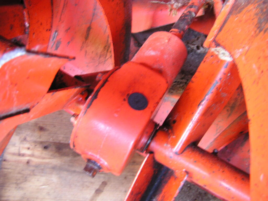

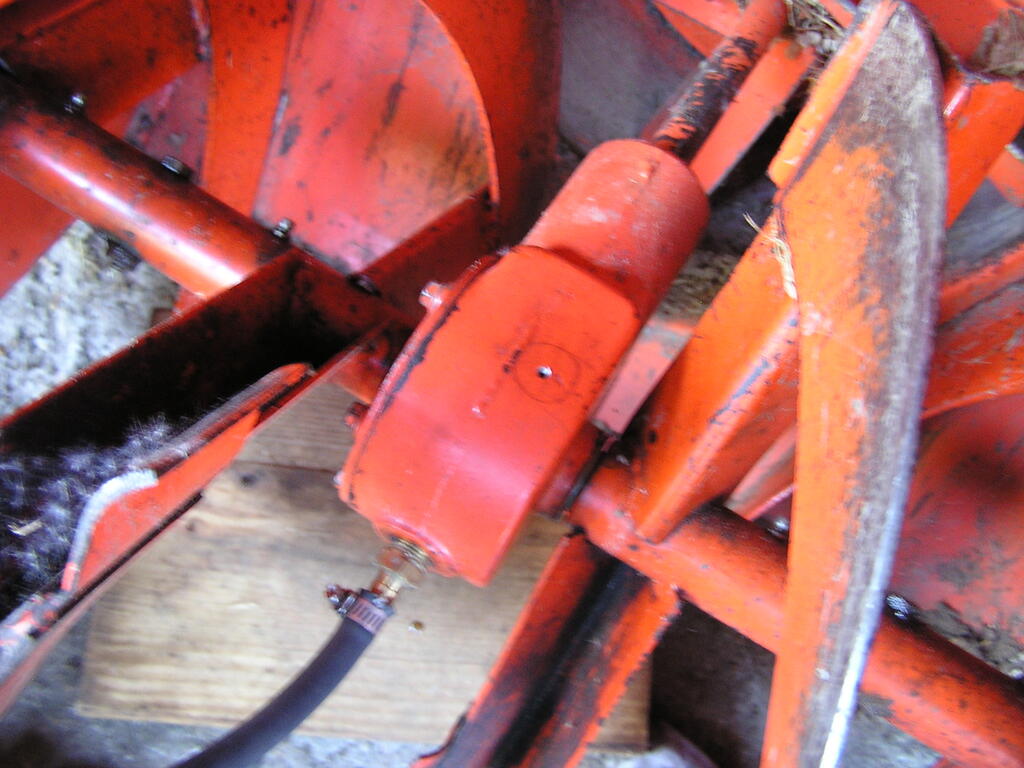

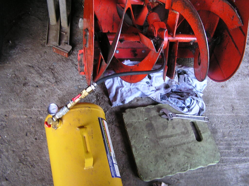

ri702bill 12,808 #15 Posted June 27, 2024 11 hours ago, adsm08 said: Applying a heavy coat of wheel bearing grease or similar to the drill bit will capture most if not all shavings. It is not a substitute for checking/cleaning but it make the job a little easier. The torx bit idea can work, but if you break the torx you may have attached yourself to another object with an inclined plane wrapped helically around an axis as many are very hard. I would try to find a replacement plug with a torx, or even better a torx plus drive. TP drive bosses are a bit squarer at the high and low points of the star and so are less prone to stripping. I added a vent "Patch" to the gearbox on an old Ariens Sno Thro. Had to drill thru the casting - without disassembly. Rigged up an airline adapter to go into the drain plug port - pressurized the port with 5 PSI. It blew ALL the chips outward once the tip of the drill went thru... Could you do something similar if desired?? 1 Share this post Link to post Share on other sites
