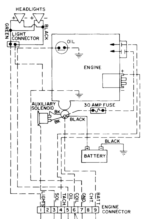

lynnmor 8,914 #11 Posted June 28, 2024 That connector can do some strange things, it belongs in a radio and not in a tractor. We should have mentioned it along with the troublesome fuse holder. The choke thing led me to think carb. You can run a bypass wire around the connector to take the charging load directly to the battery cable on the starter solenoid. Share this post Link to post Share on other sites
Furious 23 #12 Posted June 28, 2024 Thanks Ed. Good to be home. Not settled yet, but we’re getting there. I agree, those pins look like they belong in a car stereo, not on a 20 amp charging harness. I was thinking for now, doing exactly what you suggest @lynnmor, just cutting the charging wire out of the connector and running it direct to the battery. Not sure what else on the tractor would draw much more than a few amps load otherwise. Share this post Link to post Share on other sites
lynnmor 8,914 #13 Posted June 29, 2024 3 hours ago, Furious said: I was thinking for now, doing exactly what you suggest @lynnmor, just cutting the charging wire out of the connector and running it direct to the battery. Not sure what else on the tractor would draw much more than a few amps load otherwise. If you bring up the wiring diagrams for the first couple of years of the 520 tractors, you will see that they were wired that way using an inline 30 amp fuse. Share this post Link to post Share on other sites
Furious 23 #14 Posted June 29, 2024 That makes much mores sense to me. Thanks. Share this post Link to post Share on other sites
