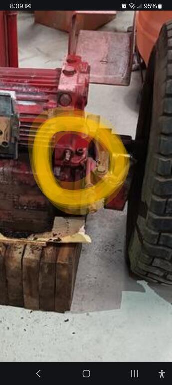

chorusguy 227 #1 Posted June 20, 2024 Hi all. I bought a c125 auto at auction and, shall we say, it isn't quite what I expected. Said motor was rebuilt, but is smokes a little. Seeping oil from head gasket bolts, inverted throttle and a few other things, but I really need immediate help with this: The starter isn't engaging with the flywheel and I need to push it into the back yard. I can't find the hydraulic release on the transmission. On my c160 I can readily find it, but I have no clue about this one. There is a sticker that says open valve on transmission behind fender with 5/16 open end wrench. I simply can't see it. Can anyone give me some help? Share this post Link to post Share on other sites

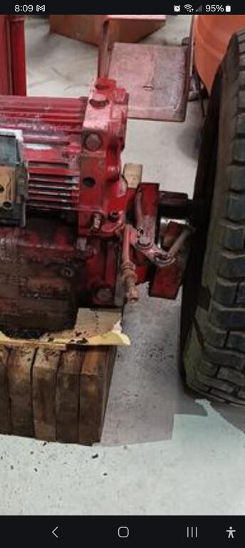

ebinmaine 77,504 #2 Posted June 21, 2024 This is a pic from last fall when we built a C121. The valve faces forward and is in under the left side fender. The tire in the pic is the left rear. There's no frame here but it faces forward. It's NOT easy to access with the sheet metal in place. Share this post Link to post Share on other sites
