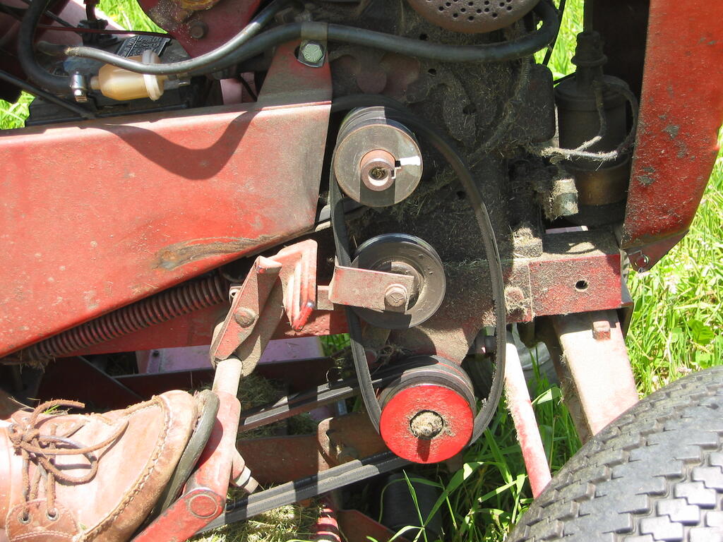

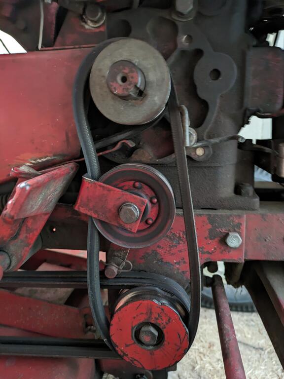

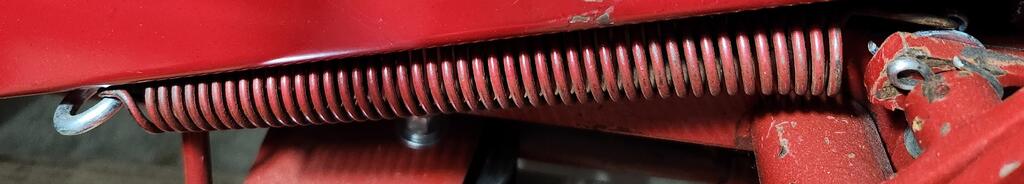

Kinda hard to see but the pedal end of the spring is hooked to a cotter pin. The backside pin that it's hooked to goes down from the top like the one on this side thereby providing spring loading for the trip lever. :)

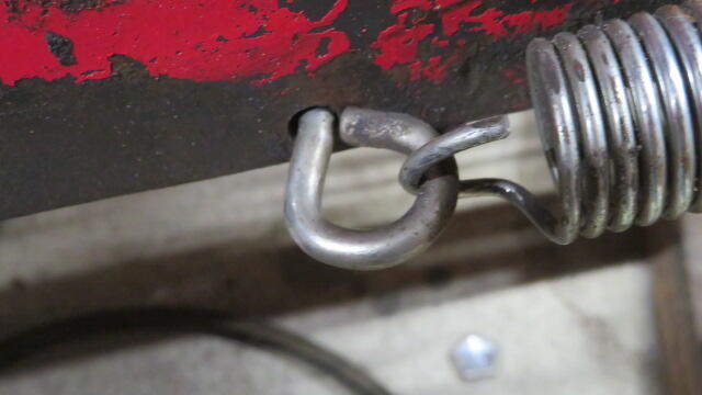

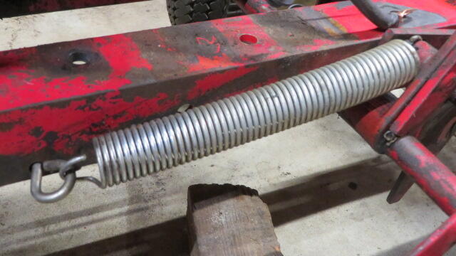

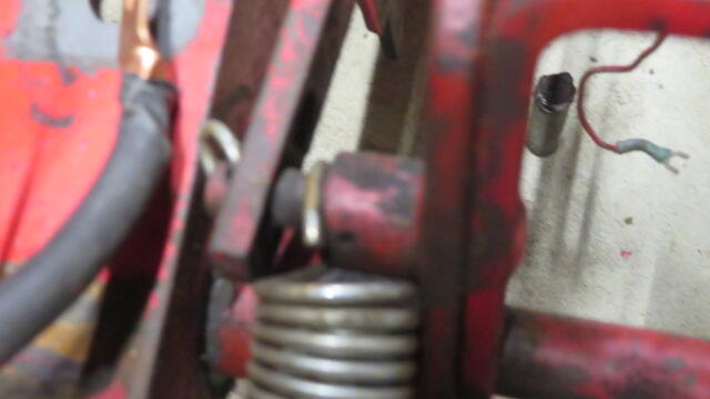

I get how it attaches to the trip lever. Is it an eyebolt through the frame that anchors it?
Here are the pics of how it looks now:IMG_1814.JPG.3f67401977176f244416e184daac148f.JPGIMG_1815.JPG.40222173c52ce620cbde58e7bb5fee02.JPGIMG_1816.JPG.197b17d0f15562a8526f8e779849a475.JPG
Racinbob
I'm not sure if they originally used an eyebolt. It may have just hooked to the frame. In either case it doesn't matter. Your problem lies in how you have it connected to the pedal end.
