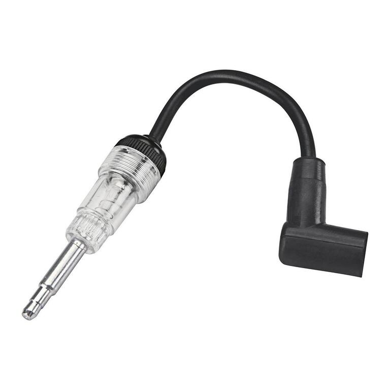

lynnmor 8,839 #18 Posted July 19, 2024 5 hours ago, Willy29 said: I have a similar issue with my H520, it starts cold no problem, then after 5 min. it shuts off and acts like it's not getting fuel. The inline filter isn't clogged and the fresh fuel is 91 octane with good fuel stabilizer. It sometimes starts in 5 min. then keeps running for over an hour. Never had this issue since I bought it in 1998. Check the spark immediately after a shutdown, a tester like this can be helpful. If no spark is found then the ignition module is likely failing when hot. Share this post Link to post Share on other sites
