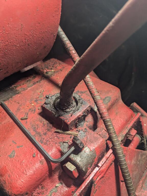

Racinbob 12,878 #26 Posted June 26, 2024 With everything lined up and the dogpoint holding the shifter in place, slowly tighten the dogpoint as you shift through the gears. Once you start to feel resistance in the shifter back it off just a tiny fuzz, hold it in place with the allen and tighten the jam nut. 2 Share this post Link to post Share on other sites
Treepep 1,099 #27 Posted June 26, 2024 I will attempt that. Thank you fellers Share this post Link to post Share on other sites
Treepep 1,099 #28 Posted June 26, 2024 On and working great. Dang set screw was barely attached. Gonzo now. Easy fix. On to the next thing Share this post Link to post Share on other sites
Racinbob 12,878 #29 Posted June 26, 2024 It looks like the dogpoint setscrew is sheared off. It needs to be replaced and a locknut put on it. 1 1 Share this post Link to post Share on other sites
Treepep 1,099 #30 Posted June 26, 2024 32 minutes ago, Racinbob said: It looks like the dogpoint setscrew is sheared off. It needs to be replaced and a locknut put on it. That's what I meant. I need to hit the Hillman section. It is just right now but not for long. 1 Share this post Link to post Share on other sites
Lane Ranger 11,914 #31 Posted June 27, 2024 On 6/26/2024 at 2:02 PM, Treepep said: On and working great. Dang set screw was barely attached. Gonzo now. Easy fix. On to the next thing one off the things I do is buy longer dog point 1/4 x 20 set screws from McMaster - Carr. The longer set screw gives you more flexibility in removing or tightening the dry screw in the tight confines you have to work in on that shifter. 1 Share this post Link to post Share on other sites
WHX?? 55,847 #32 Posted June 27, 2024 On 6/26/2024 at 2:03 PM, Treepep said: That's what I meant. I need to hit the Hillman section. It is just right now but not for long. You might not find them in Hillman drawers... kind of a specialty thing. 21 minutes ago, Lane Ranger said: dog point 1/4 x 20 set screws from McMaster - Carr. I do too and buy in bulk... use your shout out you need one. When I was a rookie Racinbob sent me one so now I think I can afford to pay it forward. 2 Share this post Link to post Share on other sites
Treepep 1,099 #33 Posted June 27, 2024 I will check it out thank you guys. Question is... what if I am always a wheel horse rookie??? Keep plugging along I suppose 1 Share this post Link to post Share on other sites
oliver2-44 11,339 #34 Posted June 27, 2024 Remember to get a rubber boot on that shifter. That's where water gets in these transmissions! 1 1 Share this post Link to post Share on other sites
Racinbob 12,878 #35 Posted June 27, 2024 51 minutes ago, Treepep said: I will check it out thank you guys. Question is... what if I am always a wheel horse rookie??? Keep plugging along I suppose You'll be a seasoned pro when you get this one done. I like to use 3/4" or 1" dogpoints. Longer and they can chew at the shifter boot. Share this post Link to post Share on other sites
Treepep 1,099 #36 Posted June 28, 2024 12 hours ago, Racinbob said: You'll be a seasoned pro when you get this one done. I like to use 3/4" or 1" dogpoints. Longer and they can chew at the shifter boot. More experience I didn't work for... Perfect Many thanks Share this post Link to post Share on other sites

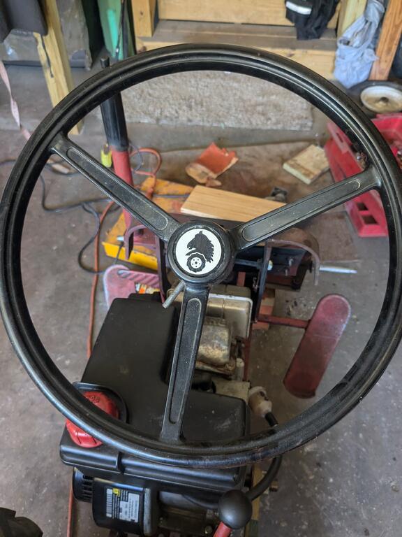

Treepep 1,099 #37 Posted July 2, 2024 We got a little break from the heat. No horse work just relaxing in the yard. Found some 3d prints I don't remember buying. Think I might put this one on. 1 Share this post Link to post Share on other sites
