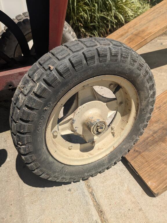

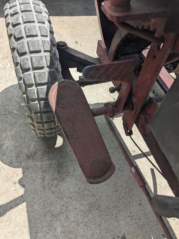

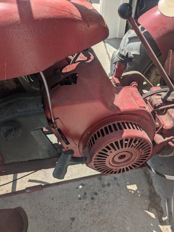

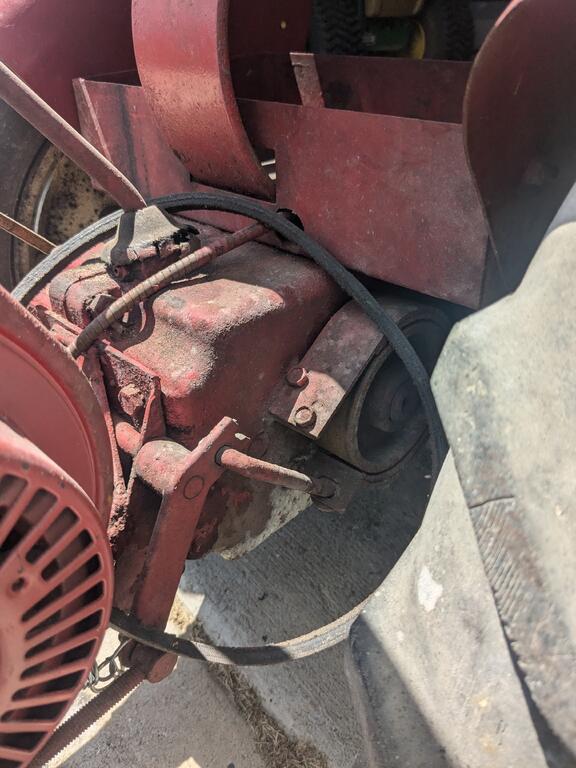

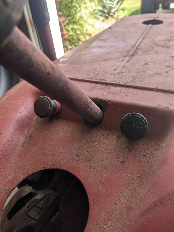

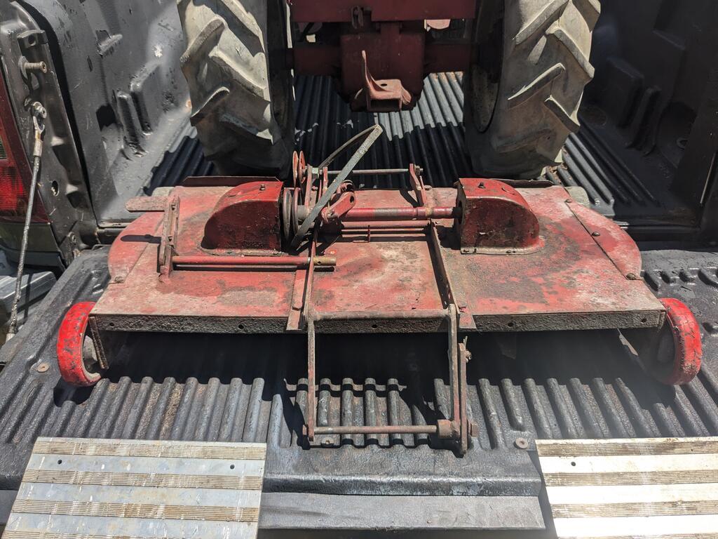

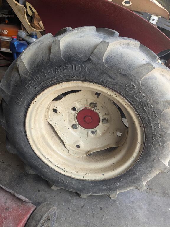

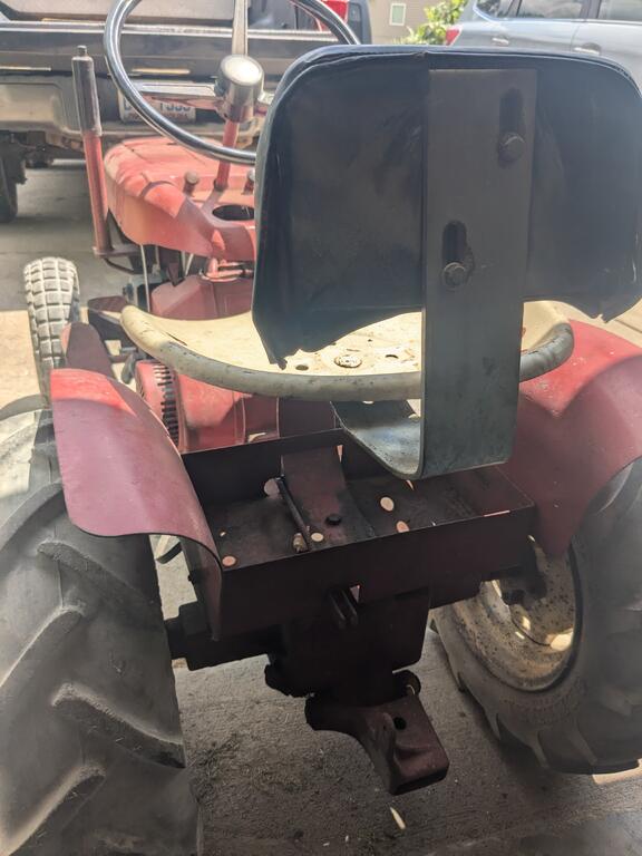

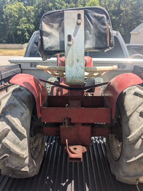

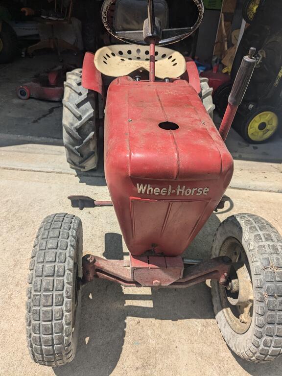

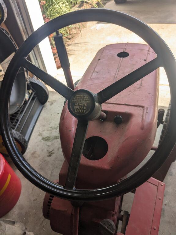

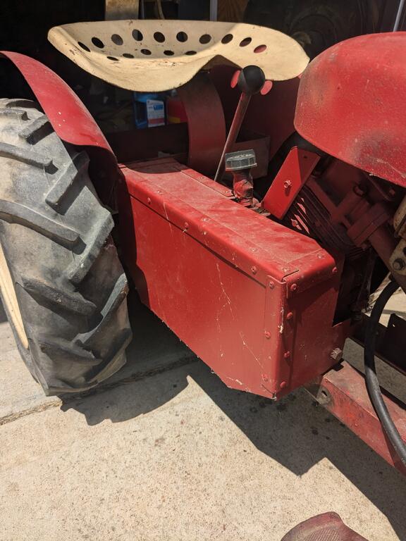

Treepep 1,151 #1 Posted June 19, 2024 Any idea what year? Steering wheel l, motor, homemade belt guard are not original. Thanks guys 4 1 Share this post Link to post Share on other sites

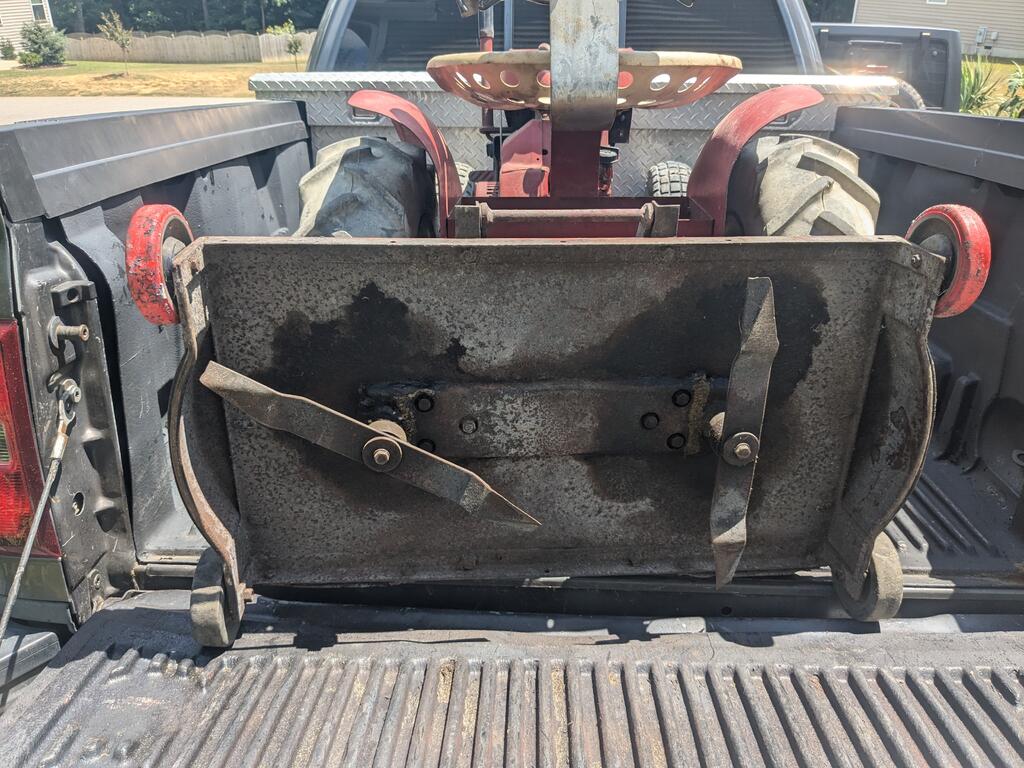

stevasaurus 23,892 #2 Posted June 19, 2024 (edited) Looks like it was a 401...nice horse. The deck looks to be a 1961 also. The 1960 deck would have the back wheels inside the deck. Great pictures. Edited June 19, 2024 by stevasaurus 3 1 Share this post Link to post Share on other sites

stevasaurus 23,892 #4 Posted June 19, 2024 Well, let's see if we all think it is a 401 first. Then, the question is, "Are you trying to make this original"? In the meantime, take out those 2 bolts from the seat and shine a light down one hole and see what it looks like inside the trans. Also, I think the back rest on the seat is not 1961...and those very cool front rims. All in all...very nice find !! 1 Share this post Link to post Share on other sites
Treepep 1,151 #5 Posted June 19, 2024 26 minutes ago, stevasaurus said: Well, let's see if we all think it is a 401 first. Then, the question is, "Are you trying to make this original"? In the meantime, take out those 2 bolts from the seat and shine a light down one hole and see what it looks like inside the trans. Also, I think the back rest on the seat is not 1961...and those very cool front rims. All in all...very nice find !! Fun... just something to wrench on. always wanted a round hood. Have never found one that the owner would let go of. P.O. gave me a lot of verbal information. Grandpa bought it new and it lived inside in NC since. All tires and rims are good and I intend to keep. The unknown motor will run. Grandpa replaced in the eighties. parked and gas drained. weak spark and killer compression. Carb, tank, and line I am confident it will run. Not certain of my intention at this point other than to get it to move under its own power. Thank you! 1 1 Share this post Link to post Share on other sites
Lee1977 7,813 #6 Posted June 19, 2024 Couldn't see the engine, if it's a Tecumseh; they all have weak fire, that's normal. 1 Share this post Link to post Share on other sites
Achto 32,964 #7 Posted June 19, 2024 (edited) I am leaning towards a 1961 Suburban 501. The 401 would have had a 3 piece transmission. The 501 came with a 2 piece transmission and a 5hp Tecumseh. Hard to see the framing to tell if it has the mounting for the battery. Nice tractor!! Edited June 19, 2024 by Achto 1 Share this post Link to post Share on other sites

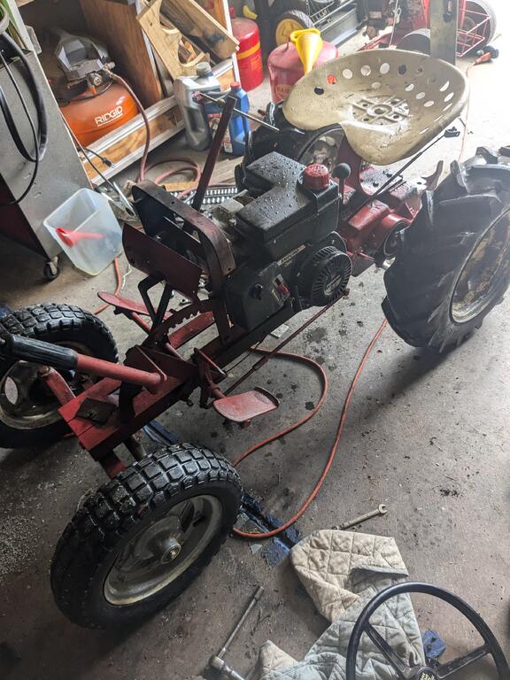

TonyToro Jr. 2,560 #8 Posted June 19, 2024 (edited) 1 hour ago, Lee1977 said: Couldn't see the engine, if it's a Tecumseh; they all have weak fire, that's normal. CORRECT! Yes it’s a Tecumseh probably between 6.5-9 horsepower. It’s one of the newer models with the throttle built right into the engine shroud so it’s probably a replacement engine PO did. Edited June 19, 2024 by TonyToro Jr. 1 Share this post Link to post Share on other sites

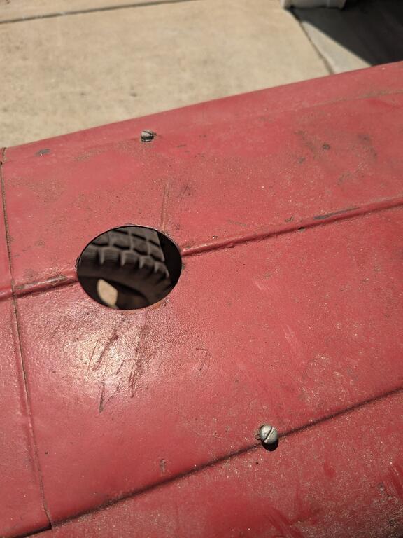

oliver2-44 11,847 #9 Posted June 20, 2024 (edited) Cast brake pedal and cast slot hitch was late 1960, believed all 1961 Cast foot rest are 1961 The hood with the round hole and push pull choke and throttle were 1961 only. 2 piece transmission was 551 only From the WH Model List. 551 1961 Lawn & Garden Tractor 551 4-Speed Tecumseh H55D-2113 5.5 Wheel Horse 5007 Edited June 20, 2024 by oliver2-44 2 2 Share this post Link to post Share on other sites
WHX?? 58,388 #10 Posted June 20, 2024 One looks at the belt guard and you have to appreciate the picture in one's mind of a grey haired grampa sitting at his work bench making it. 3 2 Share this post Link to post Share on other sites
Pullstart 71,564 #11 Posted June 20, 2024 Great taste in modifications there! I love those front wheels! 2 Share this post Link to post Share on other sites

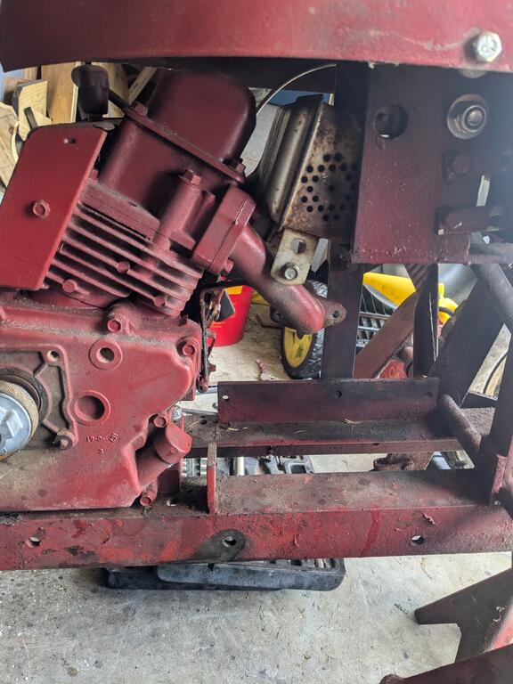

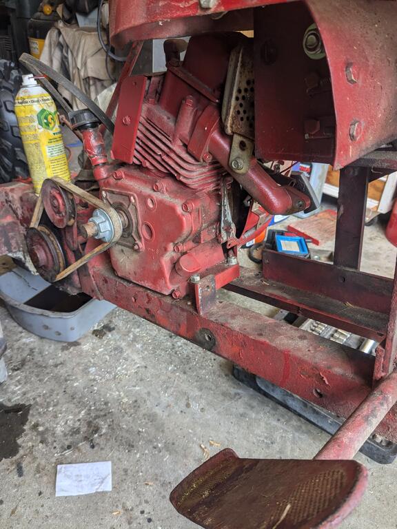

Treepep 1,151 #12 Posted June 20, 2024 17 hours ago, Achto said: I am leaning towards a 1961 Suburban 501. The 401 would have had a 3 piece transmission. The 501 came with a 2 piece transmission and a 5hp Tecumseh. Hard to see the framing to tell if it has the mounting for the battery. Nice tractor!! Where would battery box be? There is a seemingly factory strap under the hood for a gas tank maybe? Another strap was screwed in from above at a later date. Share this post Link to post Share on other sites
stevasaurus 23,892 #13 Posted June 20, 2024 Yes, 551 !! For some strange reason, I thought I saw a 3 piece transmission. I'm just not as sharp as I once was. Battery box would have been mounted on the frame in front of the engine. 1 Share this post Link to post Share on other sites
oliver2-44 11,847 #14 Posted June 20, 2024 6 minutes ago, Treepep said: Where would battery box be? There is a seemingly factory strap under the hood for a gas tank maybe? Another strap was screwed in from above at a later date. The battery was located directly in front of the engine. I think the original "hoodstand has been removed or modified on your tractor to make room for the newer engine. It would be at near the front of this homemade belt guard. Please post a side view from the left side of this area under the hoodd. I have a 551 in parts and will get a picture of the frame and hoodstand . 1 1 Share this post Link to post Share on other sites
Treepep 1,151 #15 Posted June 20, 2024 18 minutes ago, oliver2-44 said: The battery was located directly in front of the engine. I think the original "hoodstand has been removed or modified on your tractor to make room for the newer engine. It would be at near the front of this homemade belt guard. Please post a side view from the left side of this area under the hoodd. I have a 551 in parts and will get a picture of the frame and hoodstand . 1 Share this post Link to post Share on other sites
sqrlgtr 4,226 #16 Posted June 20, 2024 17 hours ago, oliver2-44 said: Cast brake pedal and cast slot hitch was late 1960, believed all 1961 Cast foot rest are 1961 The hood with the round hole and push pull choke and throttle were 1961 only. 2 piece transmission was 551 only From the WH Model List. 551 1961 Lawn & Garden Tractor 551 4-Speed Tecumseh H55D-2113 5.5 Wheel Horse 5007 plus mowing deck points to 1961 also. I think the 1960's had no wheels.... Share this post Link to post Share on other sites

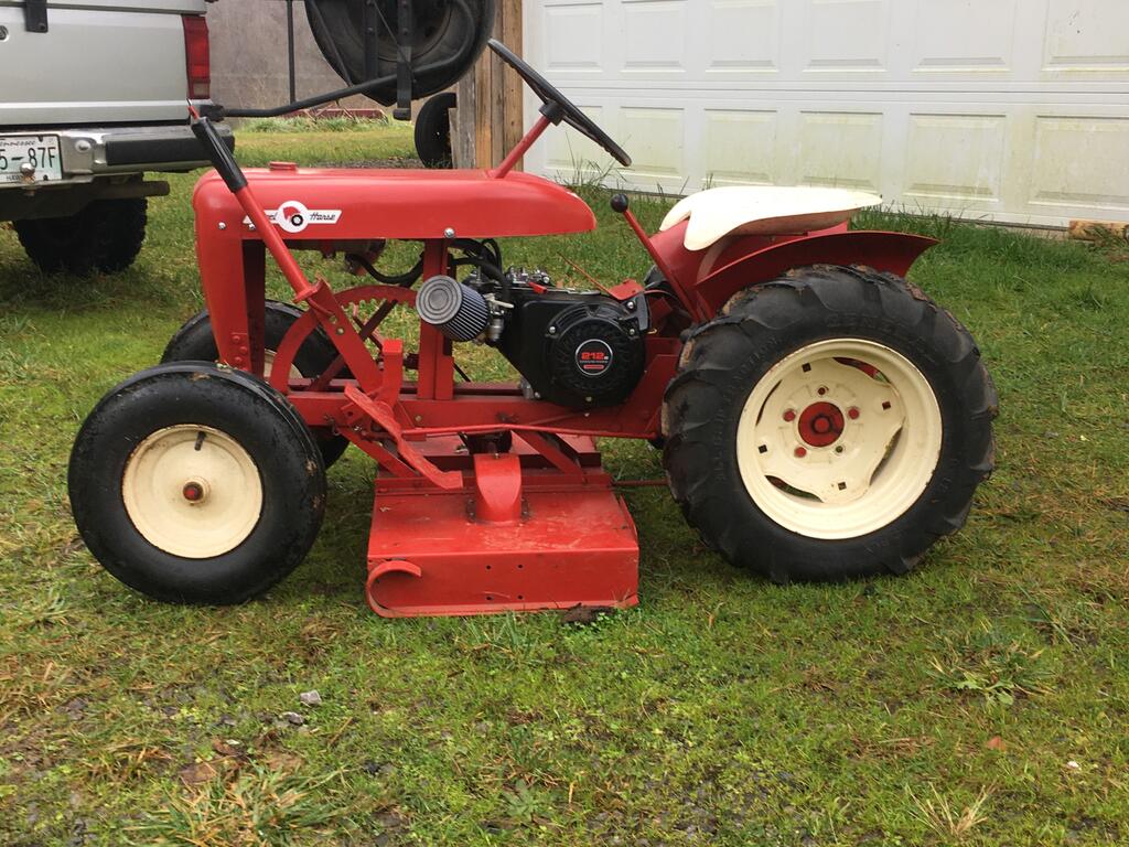

Achto 32,964 #17 Posted June 20, 2024 1 hour ago, stevasaurus said: Yes, 551 !! Thanks, 551 would be correct. 1 hour ago, Treepep said: Where would battery box be? 1 2 Share this post Link to post Share on other sites
stevasaurus 23,892 #18 Posted June 20, 2024 (edited) @sqrlgtr the 1960 mower deck had wheels, they were in the inside of the deck. One year only because grass kept jamming the wheels. The above statement is not correct. Edited Edited June 21, 2024 by stevasaurus 2 Share this post Link to post Share on other sites

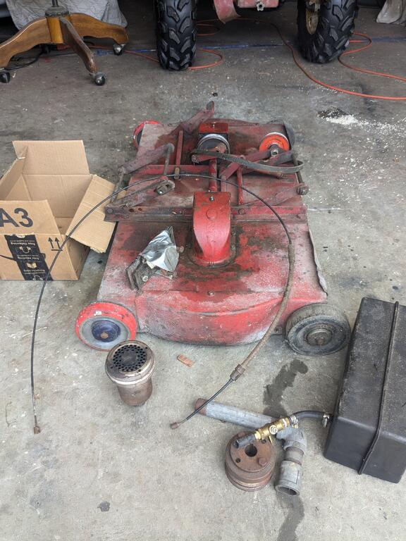

sqrlgtr 4,226 #19 Posted June 20, 2024 3 minutes ago, stevasaurus said: @sqrlgtr the 1960 mower deck had wheels, they were in the inside of the deck. One year only because grass kept jamming the wheels. Pretty sure the 701 was only model that had the inside wheels. I had one and it got hauled off with scrap metal dang it. here is a 1960 550 mowing deck that I have without the wheels. 1 1 Share this post Link to post Share on other sites
stevasaurus 23,892 #20 Posted June 21, 2024 You are correct Sir. Geez, I have been wrong a lot lately. 1 1 Share this post Link to post Share on other sites
Jim Sheaffer 11 #21 Posted June 21, 2024 Dude!! Where's the Honda Mini Trail those front wheels and tires came from?? 1 1 Share this post Link to post Share on other sites

Treepep 1,151 #23 Posted June 24, 2024 It is a newer 5.5 techy. It will run. Runs now with the same motor from the shed. Sadly transmission needs to be gone through. Someday.... Maybe 1 Share this post Link to post Share on other sites
