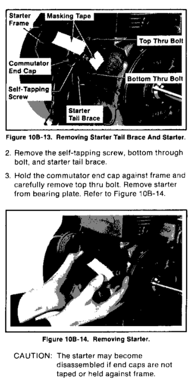

pfrederi 20,992 #2 Posted June 19, 2024 (edited) The two long screws also hold the body of the starter together. Duct tape to hold the body together as you remove the long screws. Edited June 19, 2024 by pfrederi 3 Share this post Link to post Share on other sites

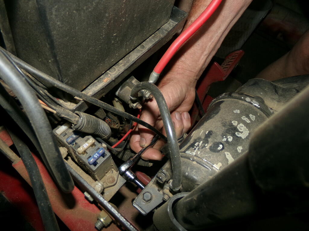

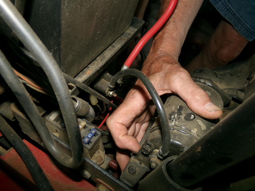

Ed Kennell 46,794 #3 Posted June 19, 2024 6 hours ago, Bahmi said: heated gently and slowly enough to loosen Have you removed both bolts? It should easily pull off the block. I slit a piece of 1" washer hose and slip it on the fill tube as insulation from the positive lug on the starter. Don't forget to remove the rear starter support. Like Paul said, don't let the starter ends separate from the body. The brushes can be a bear to reinstall. I always take the one long starter bolt out, then loosen the other one enough to install a shorter bolt and a nut to hold the starter together before removing the second long bolt. 2 Share this post Link to post Share on other sites

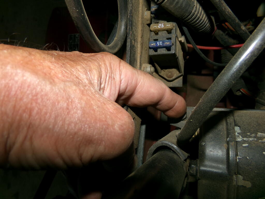

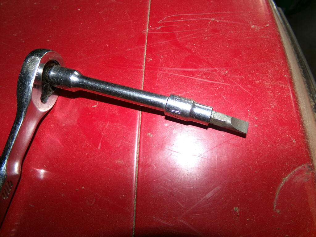

Ed Kennell 46,794 #5 Posted June 20, 2024 No no, do not break the pipe loose from the base. You can remove the two screws with this 1/4" drive rachet with a short extension a 1/4" socket and a straight slot driver. This is the rear starter support. ( called starter tail brace on Pauls picture above) A small steel angle that connects the starter to the tractor frame. My index finger is touching the bolt into the rear of the starter. My middle finger is touching the bolt into the frame. You must remove both to be able to slide the starter out of the joint in the block. The insulation is to prevent a spark from jumping from the starter lug to the oil fill tube when starting the tractor. You should always remove the positive cable from the battery when working on a tractor. 2 Share this post Link to post Share on other sites

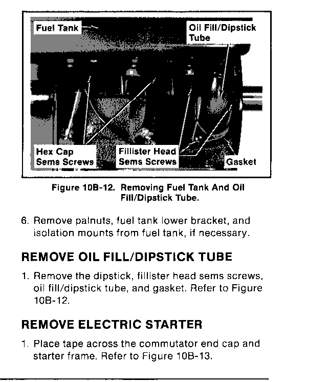

Ed Kennell 46,794 #8 Posted June 21, 2024 9 hours ago, Bahmi said: long bolt screwed into the frame on top and bottom needed removal, hence the reason why I figured I'd have to remove the oil fill tube. Apparently, this was an incorrect assumption. Yes , of course the two long bolts thru the starter need to be removed to remove the starter. But first you do need to remove the oil fill pipe by removing the two bolts holding it to the block. Do not break it off with heat or a pipe wrench. You also must remove the small angle support at the rear of the starter. 1 Share this post Link to post Share on other sites
